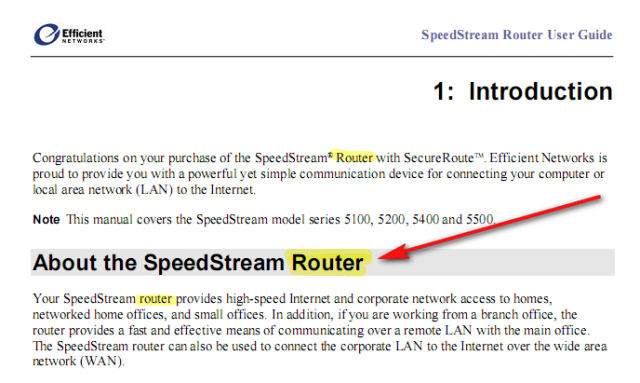

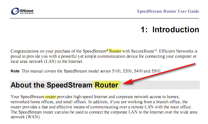

I don't care what they "call" it -- its a ROUTER!! Here is the link to the manual of the site you linked too
http://service.sympatico.ca/img_gallery/Sp...242_5260_EN.pdf
Same exact manual I pulled my info from. If it does NAT its a router plain and simple.

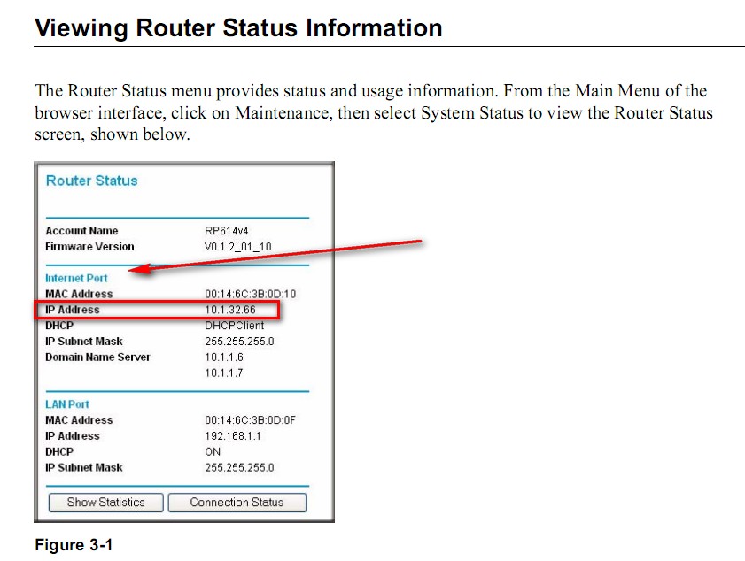

NO thats the lan side.. Once you log into the netgear on the 192.168.0.1 there should be some status page showing its WAN (internet) connection details - it should show you what its IP is on its wan interface.. What IP is that? If its in the private ranges I listed then your speedstream is doing NAT.
Here is an example of the router status page from the manual for the RP614
What does your show for the Internet Port IP address?
Oh ok now I'm fallowing you... it says 70.49.228.126 for that, which means that it's in bridge mode I guess.
