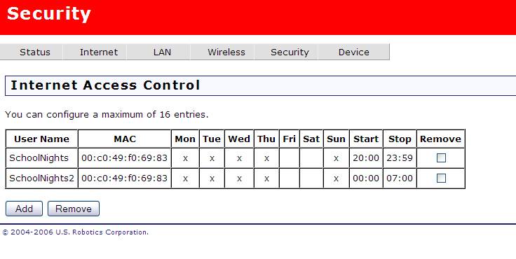

I use a program called macro scheduler for automating tasks. It will record your mose movement and keystrokes, then can play them back at scheduled times. This may work for you. I am guessing you are trying to do something to maybe keep your kids off the wireless late at night?
From the demo interface the router supports having scheduled access to the internet, it just does not seem to have a feature to be able to schedule when the radio is on or off.

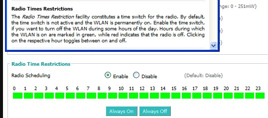

dd-wrt has that feature for example.
And I do not see support for that model of USR router listed on the dd-wrt site.

Have you not even bothered to browse around your router interface.. You managed to find how to turn of your radio -- but did not see
http://www.usr.com/support/9108/9108-ug/wu...ity.htm#option1
You can use the Internet Access Control page to create a parental control rule that keeps certain network devices off the Internet for specific time periods. The rules can block access for a defined time period on certain days of the week.
Honestly, I just got no clue how beat up myself. I am actually shocked. I went through the manual and even checked around all the options. Still clueless as to how i could have missed it.
Really sorry for wasting all your time and adding a useless thread.
Thanks a lot
Its not a waste of time if you can now accomplish your goal, it's just a shame you did not figure it out on your own ;) which is always more satisfying then having information force fed to you on a silver spoon - hehehe
