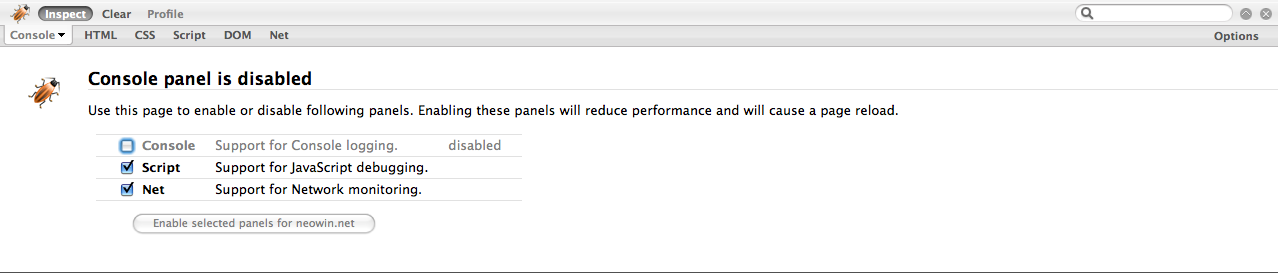

I'd suggest opening firebug, then clicking the Console button. from there enable Script & Net. This will track what you connect to and how long it takes.
this is where i enabled Net & Script tracking

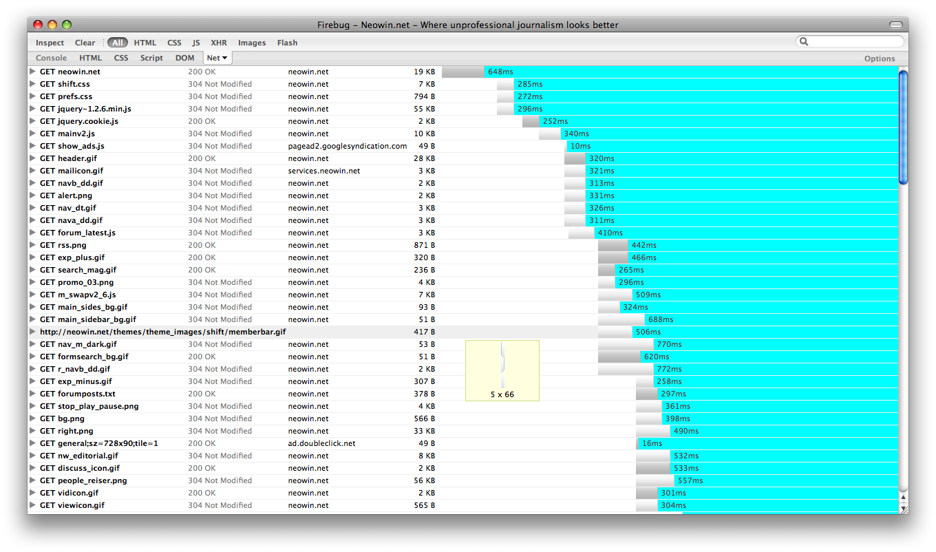

This is a screenshot of firebug tracking Neowin.net -- this is what you should post if you're unsure of what is going on.
