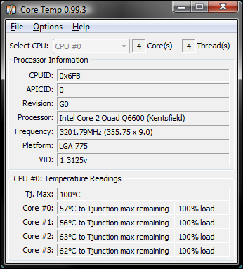

EDIT: Ok, I went ahead and threw a small overclock on it, from 2.4 up to 3Ghz (25% O/C) and turned the voltage to 1.35, ran prime95 (the multi-core version) for ~10 minutes (under max heat mode), came back and it was sitting at a nice 33C, room temperature is at ~26.6C (80 F). I feel confident I will be able to hit a pretty decent overclock with it. Yes I know a 10 min test isnt much, but I figure in all practical usage, 10 minutes of 100% cpu usage on all 4 cores isnt pretty practical when the main usage of the computer is gaming.

Thanks for the reply, I wasnt trying to show off, I just found it interesting in how cool it was running. For reference, the individual cores are running between 28-35C when its idle (at 25C). I guess what I need to ask is how is 33?C for 10 minutes of full load in a 27?C room?
I understand theres always differences in hardware, no two setups no matter how similar are guarenteed to get the same overclock, what I was wondering is how much overclock room does that leave having a load temp not a whole lot higher than ambient temp?

Thanks for the replies, I was at first going to stick it on 3Ghz and just let it go at that, but my average FPS in CS:S's benchmark (I know not the best thing to use) went up about 20FPS just by going from 2.4Ghz to 3Ghz.
That being said I think I will likely do what I have done on all my AMD chips (this is my first intel chip :D), and thats, overclock till it doesnt post (or becomes unstable) then back it off until its stable. That seems to be the general answer and is likely the best way to go about overclocking, push it till it errors, then lower it until its nice and smooth.
Would it just be an inaccurate sensor or the program? I sort of doubt the program (everest) is wrong because it shows the same temps for each individual core as core temp does. Under load the hottest individual core is around 45?C, the coolest can be down around 35?C.

I'm not exactly sure what the 25?C is reading from, its just labeled(in everest) as "CPU", the 25?C doesnt show up in Core Temp, but core temp just shows the internal core temps. I have a feeling the 25?C is the temp if you were to touch the outside casing of the processor(probably the Tcase).
Like I said, with the same cooler on my 4200, the "CPU" reading was never lower than 40?C.
Ok, it ran overnight and stayed at the same ?C to Tjunction max, I overclocked to 3.6ghz and I after re-adjusting the voltages, I get a hard lock after about a minute of stress testing. Hard locks are something I havnt seen in my previous overclocks, what from overclocking can cause a hard lock? I figured maybe it cannot handle that high FSB (bought this as a budget board way back in the workstation I put it in), but I want to check to be sure.
Sorry for the double post (cant edit my last one), got it to 3.4Ghz stable, I'm pretty happy with that as its still 400Mhz above the previously highest processor I had (when I had my FX, it ran at 3Ghz), and its quad to boot. That being said if anyone knows what would have caused the hard locks at higher speeds, let me know, I dont plan on pushing it higher unless I can find for certain whats causing the locks. Core temps at this O/C vary from 38?C to 46?C, rather low IMO, but then again I am running water cooling.
Well, like I said, if anyone has any thoughts on the hard locks, let me know, otherwise I'm happy sitting at 3.4Ghz.......I have a feeling the hard locks are from the MOBO FSB, its an nVidia 650i chipset which has a rated max FSB of 1333 Mhz, I'm running it stable at 1512 Mhz.
Ok, FSB of 1600 (or 400, w/e number you wanna go by) didnt freeze with a multiplier of 8x, but it did fail a prime95 test after about 8 minutes, FSB of 1556 (or 389) seemed to not freeze and it lasted at least 10 minutes (when I stopped it) in prime95.
Would that mean my CPU's limit is somewhere between 3.4 and 3.5 Ghz (runs fine on 9x at 3.4 ghz but not at 3.5 ghz), or is there another setting or something I could change that would fix it (like possibly raising the voltage a little more)?
EDIT: Just tried 3.5 with a higher voltage and it froze after about 11 minutes of prime95, hard lock, forced to reboot it. Think somewhere between 3.4 and 3.5 is just the limit for my proc? Either way, I'm happy with what I was able to get.
