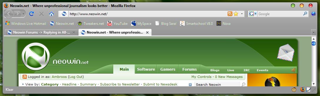

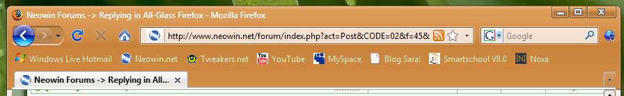

Hi Ambroos
Thanks! :D It looks better now. However is there one more padding change you can make?
If you look at the comparison with no glass and with glass, you'll see that the menu bar is a pixel or two too far to the left.
You can see the word "File" is right next to the edge of the screen.. it should be a few pixels farther from it.
Also notice that the letter "e" in "File" is cut off slightly on its right edge; the same is true fro the other menu items (Bookmarks, Tools, Help, anyway)
Furthermore, I've found a few small issues that I'm wondering if you can correct.
For one, the Search Bar doesn't work 100% for me -- when I press Ctrl+F,
it shows up with a black background for a fraction of a second, and then becomes glass:
And another issue: it seems that some of the text, when it's bolded, is a bit blurry and sometimes a bit cut off (cut off when the tab is active).
Here are some images to show you what I mean:
Overall though this is awesome.. great job and thank you!! :laugh:
it shows up with a black background for a fraction of a second, and then becomes glass...
That's normal, it's because Glasser uses javascript to set the amount of glass to use, which has that tiny bit of lag. The only way that would be possible to fix it would be to either change firefox code and recompile it or change glasser code and recompile it, both of which is too much effort for the payoff, or possibly cleaning up my code in the dwm-overlay.js. Either way, it doesn't bother me, I'm not that much of a perfectionist.
As for the other stuff, to fix weirdly rendered text, change the opacity to .99, with letters being cut off, i just ignore it, although some tweaks with the size of the box would possibly fix it.

Tried to fix some of the bugs. Inactive tab text is now better and menu text doesn't get cut off to the left...
About the flashing in black, that's just the way the glasser JS calculates height every time. Can't do anything about that.. sorry!
Text cut off it a firefox issue. See: https://bugzilla.mozilla.org/show_bug.cgi?id=363861
this is nice, but .. when you get something bright under it, it looks just horrible
I had to make as much text as possible white. Otherwise, it doesn't look like anything at all when you maximize your window.
I had to think about useability for people with or without a bookmarks bar, and for peple with or without a file menu bar...
