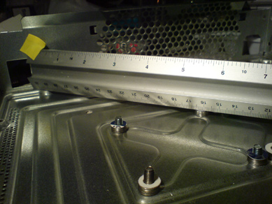

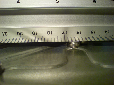

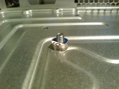

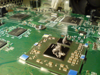

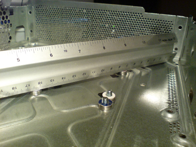

FiB3R Posted February 3, 2009 Author Share Posted February 3, 2009 Through metal casing and mobo: 8 X 5x12mm Machine Screw Under the mobo: 4 x metal washers (B&Q M5 -3/16") + 1 cardboard washer (cigarette box) per corner Top of mobo: 3 x metal washers (B&Q M5 -3/16") + 1 cardboard washer (cigarette box) per corner Top of CPU/GPU: 6 X Credit Card pieces Few blobs of Arctic Silver 5 Perform balancing act while tightening slowly and systematically, just a few turns per corner, down to 1/4 of a turn per corner. But very tight. Pray Cost: ?00.00:shifty:: Link to comment Share on other sites More sharing options...
Sethos Posted February 3, 2009 Share Posted February 3, 2009 Way too much paste, damn :| Link to comment Share on other sites More sharing options...
+Mystic MVC Posted February 3, 2009 MVC Share Posted February 3, 2009 Way too much paste, damn :| Just what I was about to say... What happened to just a dab? Link to comment Share on other sites More sharing options...
FiB3R Posted February 3, 2009 Author Share Posted February 3, 2009 Yeah I know, It's kinda stiff to get it going, then... splurge. :blush: Should be OK though, I tightened it pretty damn tight, so it will have all squeezed out the sides. Makes for a messy clean up job if I ever have to get back in there again though. Hope that doesn't act as an insulator now! Link to comment Share on other sites More sharing options...
Groovedude Posted February 6, 2009 Share Posted February 6, 2009 Way too much paste, damn :| yeah looks like you were a bit heavy handed on the love goo... But i suppose the big question is, how is the xbox running ? I hope she stays strong for you. -Optimash Prime :p! Link to comment Share on other sites More sharing options...

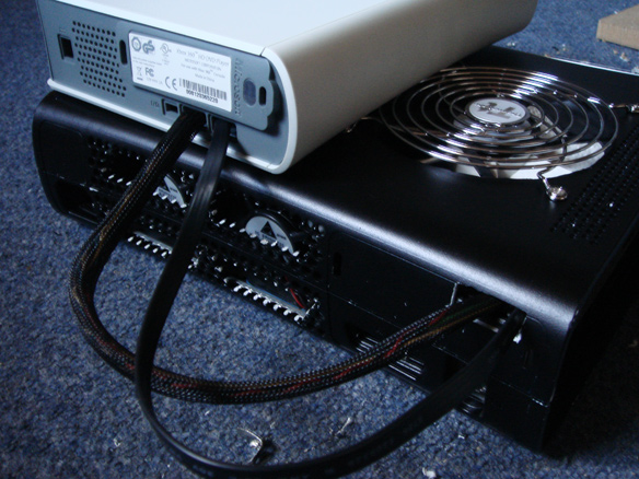

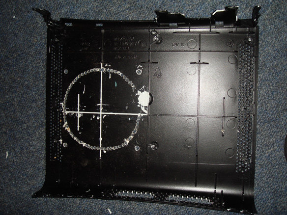

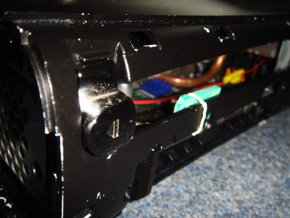

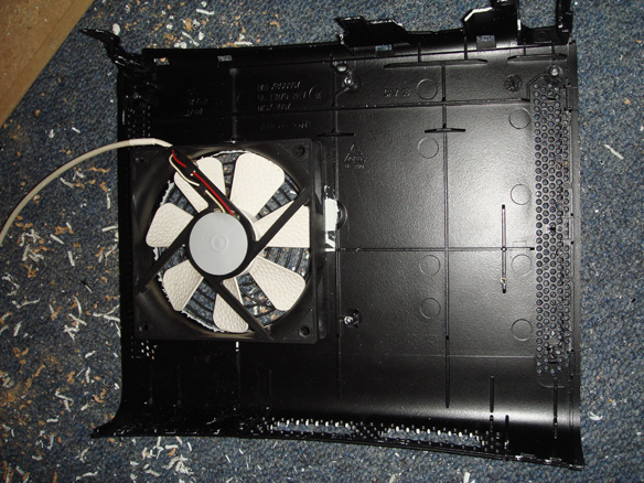

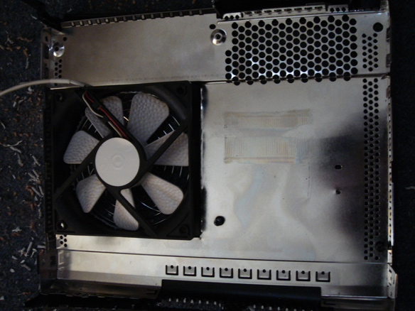

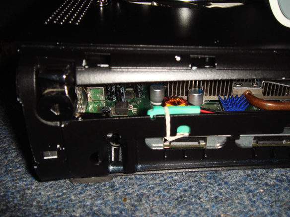

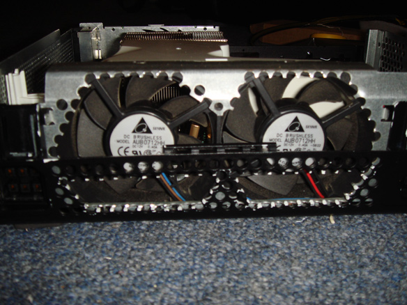

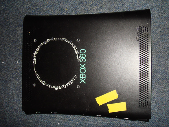

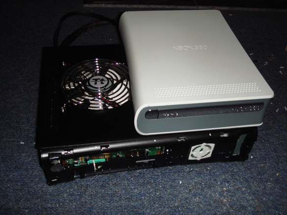

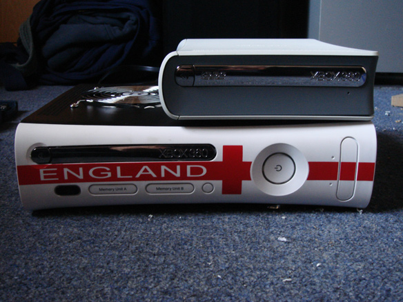

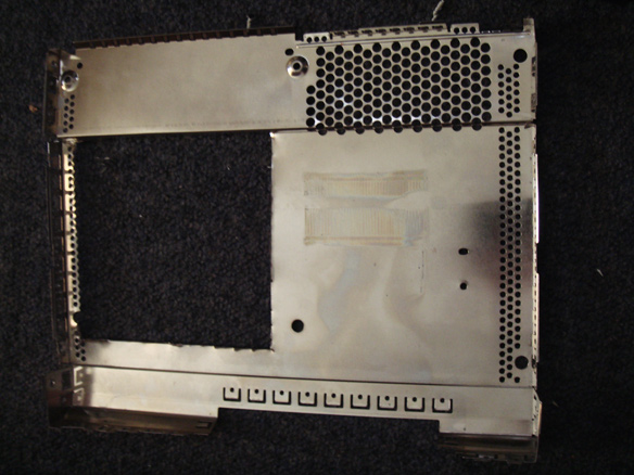

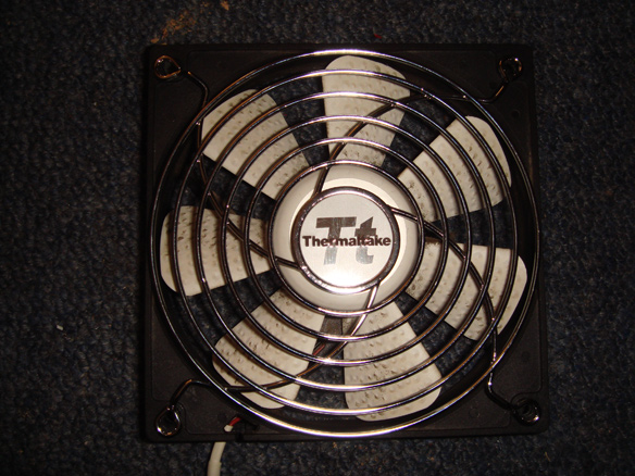

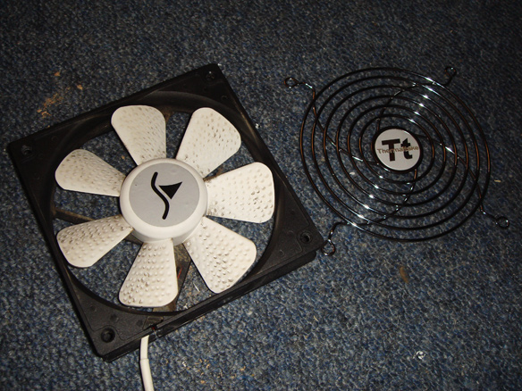

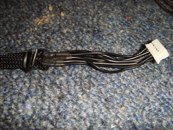

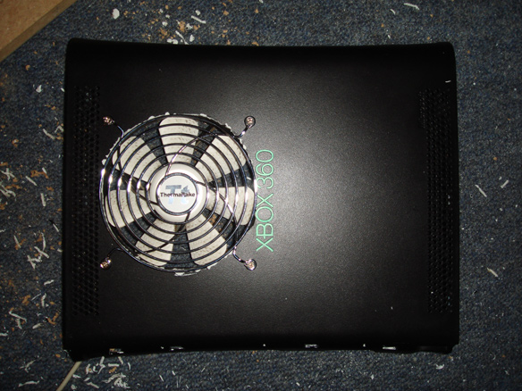

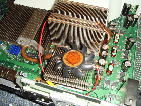

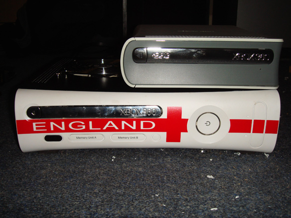

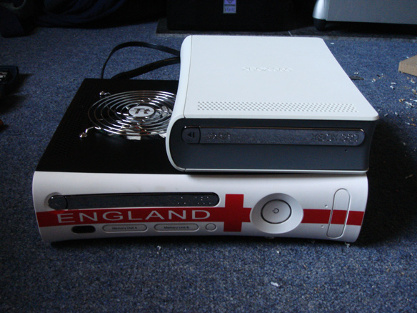

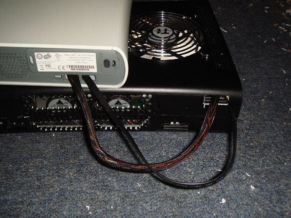

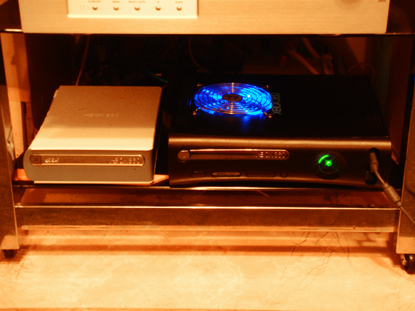

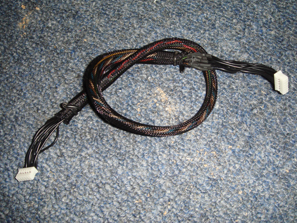

FiB3R Posted February 11, 2009 Author Share Posted February 11, 2009 This is my last attempt at a fix, before I start the "DARKFiB3R Xbox360 Fund". (I can see that going well :p ) I've taken the DVD drive out of the 360 and put it in my un-used HD-DVD drive enclosure. This was not as straight forward as I thought it would be, and involved a hack saw lol. And I had to extend the DVD drive power cable, that was a right pain in the arse, but came out quite well I think. The point of that was to reduce heat in the 360 and to allow me to fit an 18cm (I think) fan to the console. I've also cut out the rear grill to try and maximise the exhaust airflow. Added another little fan in there too, for what it's worth. The eject button for the DVD drive is actually on the console, and not on the drive like standard PC drives. Thankfully, a cable tie was all that was needed to hold the button to the case. Looks dodgy, but there is no real force against it, so it's not going anywhere :) It is kinda strange though, pressing the button on the 360, and having the (ex) HD-DVD drive open, but I think I can live with it. Also, the 360 and the HD-DVD drive are now inseparable, without resorting to screwdrivers. Link to comment Share on other sites More sharing options...
Brad. Posted February 11, 2009 Share Posted February 11, 2009 If that doesn't work then I'll feel bad for you :( Can't you sell a few games and put some money towards a Jasper Arcade? :/ Link to comment Share on other sites More sharing options...
+Audioboxer Subscriber² Posted February 11, 2009 Subscriber² Share Posted February 11, 2009 Sorry dude, but that white faceplate on a black 360 looks like absolute ass! (nothing to do with it being England :p) And man, you've put far too much effort into this - Nice work, but seriously the console is going to keep dieing dude, just buy a cheap Jasper arcade :p (at least then your faceplate will match!) Link to comment Share on other sites More sharing options...
FiB3R Posted February 11, 2009 Author Share Posted February 11, 2009 LOL I know, I know, the faceplate looks pants. It was a gift (honest) and didn't look too bad when my 360 was still white. My mate sprayed the 360 for me, but he made a right mess of the face plate. You can barely see the ring of light through it, I doubt the IR receiver works and the flaps are kinda sticky :p I'm kinda confident that I've cracked it this time, but we'll see. The next step would be to water cool it, but at that point I'd just get a jasper. Money is tight right now though, I've got a holiday coming up, I want KZ2 and I want to buy the parts to build my Joystick for SFIV. I had those fans laying around so it hasn't cost much doing all this, and I kinda enjoy it (though I'd rather it just bloody worked lol ). So... the battle continues. Link to comment Share on other sites More sharing options...

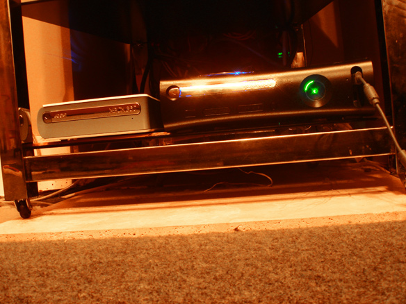

FiB3R Posted February 11, 2009 Author Share Posted February 11, 2009 I appreciate the going off of your hate to me lol. Thank you :) The next pics I post will (hopefully) be of the HD-DVD enclosures paint job and some lighting. I might try and do some sort of paint effect on the face plate, then match that on the dark grey part of the HD-DVD enclosure. Not sure, any ideas? Link to comment Share on other sites More sharing options...
Brad. Posted February 12, 2009 Share Posted February 12, 2009 I appreciate the going off of your hate to me lol. Thank you :) Oh my lawd! Typo on ''hat'' LOL. Sorry dude. T_T Link to comment Share on other sites More sharing options...
FiB3R Posted February 13, 2009 Author Share Posted February 13, 2009 Sexeh! I think some blue LED's for the ring of light are in order :) Link to comment Share on other sites More sharing options...
Elite Prime Posted February 13, 2009 Share Posted February 13, 2009 Sexeh! I think some blue LED's for the ring of light are in order :) That looks great very nice :) Link to comment Share on other sites More sharing options...
