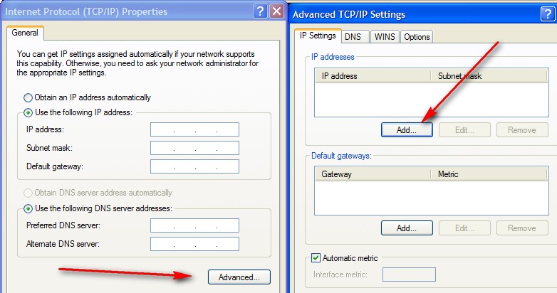

Are you just wanting multiple IPs? You do not need a virtual interface for that -- you can put many IPs on one interface.
Im not sure what your trying to accomplish exactly?? But you do not need any 3rd party software or running virtual machines to give your machine more than 1 IP.. You just can not be running dhcp and then add multiples.. Change to static - ie assign the IP on your machine, and then you can add lots more.

I already told you how to get 2 IPs, or 3 or 4 or 7, etc.. Just set your IP as static -- and then add more. But no you can not get multiple IPs from dhcp to the same interface.
