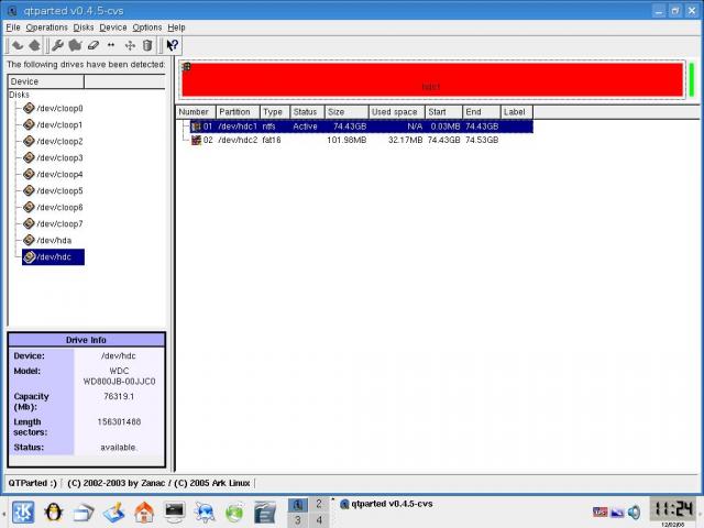

Again in Knoppix, qtparted showed the partition table as the same. The FAT16 partition can be mounted, read; it's fine. When I try to mount the NTFS partition, Knoppix throws this error (attached picture). Obviously I should have at least done a full backup while the disk was still readable, but alas, it's too late now. I also attached a screenshot of what the qtparted windows looks like.
Oh, and one last note. I did try to use chkdsk from the XP CD like the error recommends, but chkdsk said something like "unrecoverable errors detected" before even beginning to scan. Sorry for the super-long post. I'd like to get the NTFS partition at least readable if bootable isn't possible. Thanks!

When you removed the GRUB boot code that remained and was working, all you had was the 440 bytes in your MBR that pointed to the (now removed) code.
At that point, if you posted here, or googled a bit, you would have seen that you could have thrown in your XP CD and have done a fixmbr to reset those 440 bytes to Microsoft default, giving you what you wanted.
You may have inflicted some damage to your filesystem.
From your knoppix (or other Linux LiveCD) see if you can do a testdisk which will attempt to look at the data sections of your drive and re-create a valid partition table. I have been 1 for 1 on success of this tool. It worked perfectly the one time I used it.
If your LiveCD doesn't contain testdisk by default, see if you can install it within your Live session (apt-get install testdisk).
