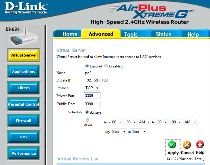

I have set this up multiple times on many different routers. If your router does not support this would be the only reason you would have change the IP your PC rdp listens on. Any decent router would allow you to listen on a different port on the public side and then forward to different port on the private side.
Here is an example from a very common dlink router.

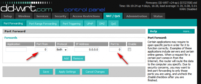

As you can see dd-wrt clearly supports changing the port on a forward.
Yeah that linksys native firmware is lame at best.. I would suggest you put 3rd party on that wrt54G of yours -- what hardware version is it?
