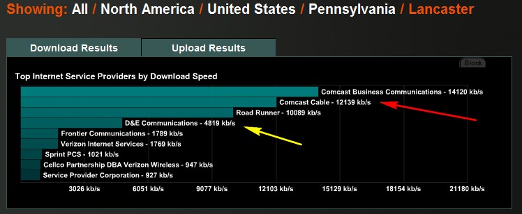

This is what I get now
Now any other day, i get only 100-110kb upload.

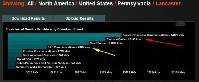

I show comcast as blowing away that 5mb your saying.. And they sure are faster than the ISP your currently using. Are you going getting some different ISP?

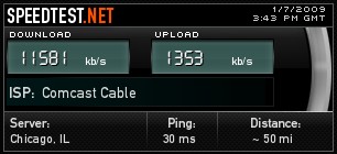

i am paying for a 5mbit down and 512 k upload with COX and i got this
Yeah I get always get faster than I am paying for as well ;) Im suppose to be on the 6mbit plan.. Im grandfathered in I assume, I have called them a few times about it.. But to make changes would cost me like $20 more a month.
