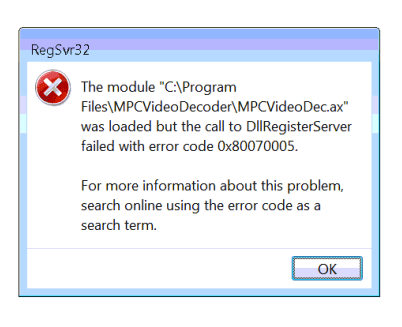

I'm trying to register MPCVideoDec.ax on my HTPC test box and I'm getting the attached error.
"The module "C:\Program Files\MPCVideoDecoder\MPCVideoDec.ax" was loaded but the call to DllRegisterServer failed with error code 0x80070005."
I know in Vista you need to run these as administrator but not so in 7. Any ideas?

"not so"? Did you run this in an administrative cmd.exe prompt or not?
WHy not use the installer?
If you're really wanting to test this, run a registry monitor and watch what it's trying to write out. What keys is that registration getting access denied to?
