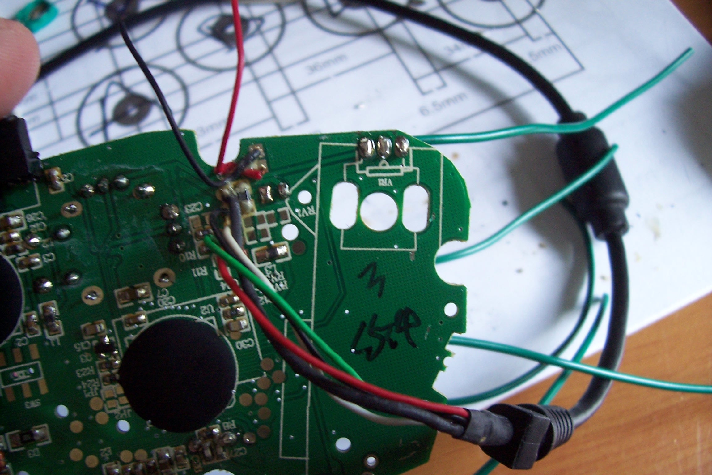

I'm including 2 pics of the trigger areas that I need to wire up in hopes someone can help me out. I have a madcatz board 4716-2007 wired. I have all the buttons and d-pad hooked up (just waiting on my stick and buttons to come in) but I'm at a hard stop not knowing where to solder the resistors. I have a total of 5 resistors all of which are (10k-ohm, 1/2watt, 5%tolerance).
post-302252-1245858769_thumb.jpg Left Trigger
post-302252-1245858818_thumb.jpg Right Trigger
Once again thanks for your help
p.s. Thanks Dead_Monkey for the link.
