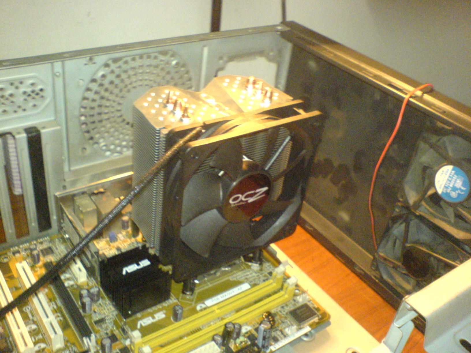

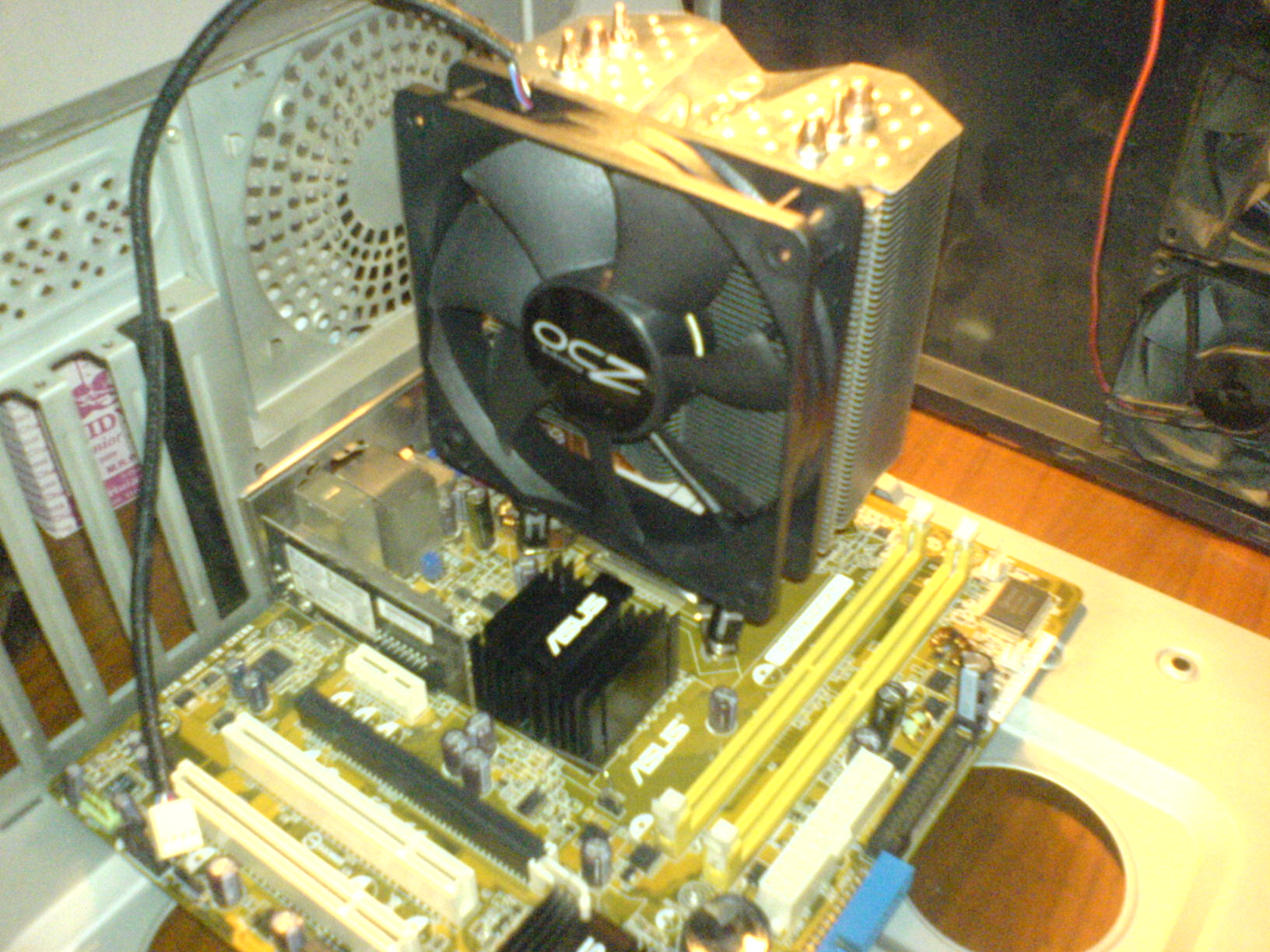

I wanted to ask one more thing, how should I place the OCZ Cooler? Is there a specific way to place it or I can place it anyway, I'll let the pics do the talking..

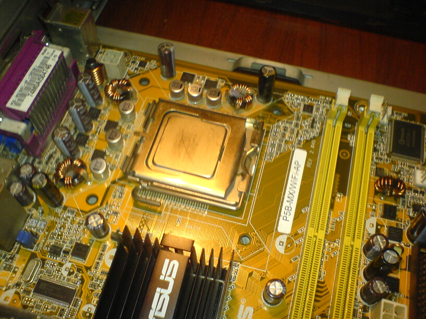

This is how my Processor is:-
Should I place the cooler like:-
OR
OR it just doesn't matter, they're all the same.
The first way, ideally you should have a front case fan sucking air in and upwards towards the cpu then the cpu fan will channel the air out of the back of the case, if you do it the second way it will blow all the hot air into the PSU.
