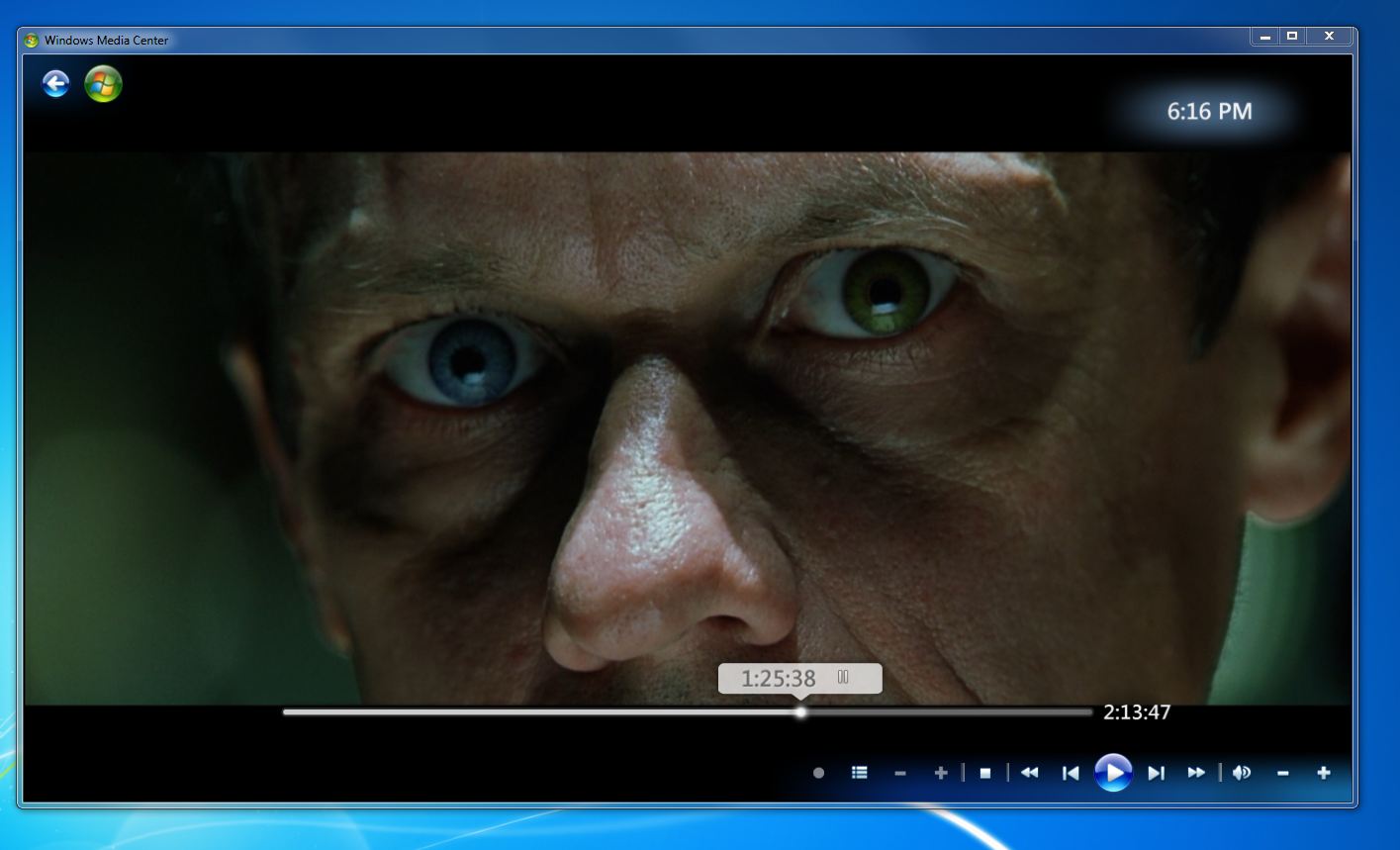

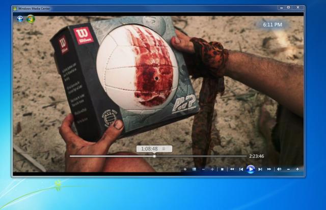

So I stumbled across something just now by accident. I used Windows 7 Media Center to share all of my video files on my Homegroup. After that, I setup Media Center to scan these folders and share them across the network. With this setup, I then went and added a Media Center Extender and input the 360's unique number.
I was watching some shows and saw an x264 file and said "**** it, worth a shot." To my amazement, the 360 started streaming it in HD and I watched it. I've tested other x264 files and they are working as well. :)
Now as far as I knew, the xbox 360 only supported h264. If anyone is on Windows 7 RTM, has a 360 and some HD x264 files, could you test and confirm?
These are MKV/x264 files.
