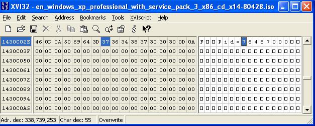

2. Changing your Channel ID
The first step to changing your Channel ID is to have an ISO image of the XP CD on your hard drive, and you must do this step before continuing. Most CD/DVD burning software offers an option to burn a copy of a CD to an image file. In order to proceed you also need have a HEX editor, I recommend XVI32 from this page http://www.chmaas.handshake.de/delphi/free...xvi32/xvi32.htm
After installing your HEX Editor, open up the ISO file. Hit CTRL+F in XVI32 and type the name of the PID from the first step and type OK. Your screen should now look like the below screen. (attached)
Modify the ?Pid=? value to have the last 3 characters to have the correct Channel ID, so if we wanted to create an OEM CD we would need to change ?000? to ?OEM?. It shouldn?t be necessary to change the first 5 characters
3. Saving and burning
You can save the file by pressing CTRL+S. It?s now safe to burn this image file with your favorite CD burning software. You should now be able to use a different license type and continue installing XP like you would with any other disc.

This is more for people doing work that need to have multiple types of CD's on hand. For example, a PC Technician that fixes peoples computers. You would follow the licensing requirements, each PC would have a license. Let's say you have a customer with an older PC that has a Windows XP Pro w/ SP1 Retail copy, and all you have is an OEM disc. You can use this method to use your OEM Disc (Likely with sp3 slip streamed and all the good stuff) to install XP with a retail product key.
Also, this doesn't work with OLP (VLK) discs.
And, as Fish said, what you wrote about installing a retail CD on a Dell is nonsense. Of course you can.
I converted a VLK copy (have a volume licensing agreement with Microsoft) to an OEM copy, but haven't tried converting an OEM copy to VLK copy. Used this method to reinstall XP on computer that are surplus and being sold with using the OEM key when I couldn't find an OEM disc (besides stupid IBM / HP recovery discs).

I made a small batch file that will replace key OEM files in the I386 folder of the CD that will allow the use of the corresponding OEM key so I carry a single copy of XP on a flash drive and just select the needed OEM and I'm all set. This flash drive goes everywhere with me.
