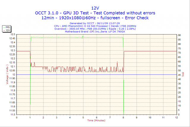

Possible but I will run OCCT to make sure.

So you have a total of 50A across your 12v rails. That comes out to a total of 600w. The GTX260 comes in at a TDP of 182w. You CPU at 125w with stock voltage. How is it that you are running short of power? Based on these numbers and your descriptions, I would start looking at a problem with your PSU. I run an i7 920 overclocked with 6gb memory, 2x1TB hard drives, an optical drive, and a GTX280 on an OCZ ModXStream 600w PSU. Your 700w OCZ PSU has plenty of juice to power that entire system. If it is giving you difficulties, it would seem to suggest that the PSU has a problem.
If that system is not even powering up on the 700w PSU, that should be an immediate red flag that the PSU has a problem. The GTX260 only pulls down about 25w in idle mode.
