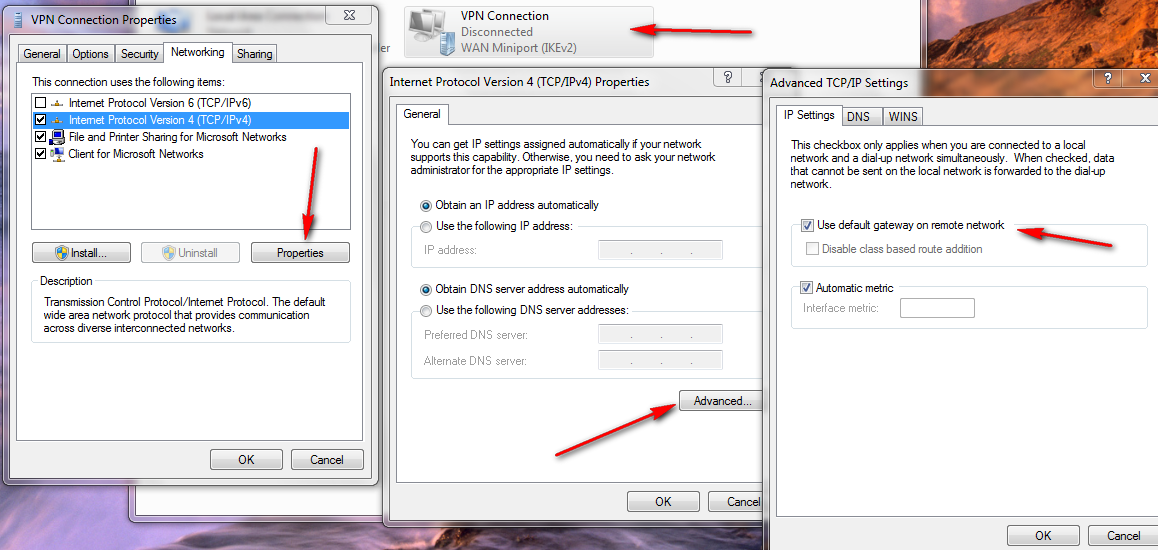

Depends on if your vpn connection is setup to be the default gateway or not. Sounds like your cisco connection is allowing for split tunnel - which normally is a no no and companies do not allow for that
On your pptp/vpn connection you can check
I would post a picture for the cisco client, but don't feel like firing up my laptop, etc.

Does not matter what OS your on -- the settings for a vpn are the same, either use the remote gateway or not, and just route traffic to the connection. Only thing that would change is the where in some gui you would make the change, or maybe terms slightly different
The cisco client would be setup by the vpn admin on the other end if you can split tunnel or not.
On the cisco client it would be call allow local access or something like that - would have to fire up client.. And then again it might have changed terms a bit.. Which cisco client are you using? 5 I would guess.. Cisco is going to end support for the ipsec clients -- need to move to the anyclient which is all SSL based.
Just take a look at your route table when you connect to your vpn and you will see what will happen. A VPN can either route all traffic through the vpn connection, or it can just add a route to the other network(s) on the other end of the vpn.
When your allowed access to local network, using your local networks gateway and also the networks on the other end of a vpn its called a split tunnel.
