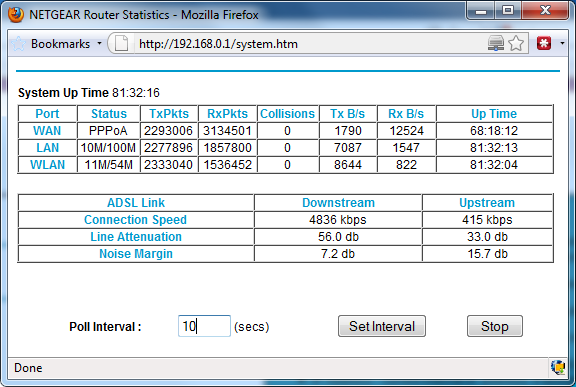

Yeah get it re-trained. Mine isn't too different from yours comparing downstream line attenuation (higher is worse), your line should be able to do 2.5 or 3mbit at most. Mine is 3mbit, the data rate translates into that (see table at the bottom of http://www.dslzoneuk.net/adslmax_explained.php)

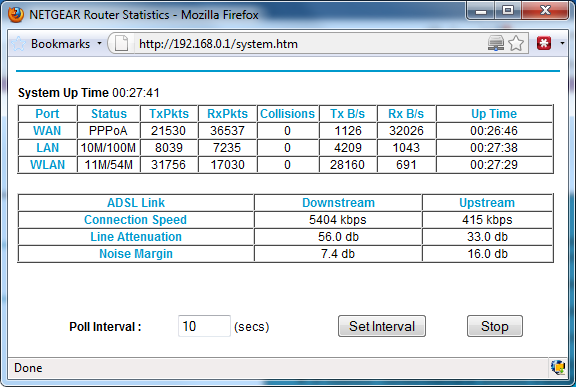

Well well well - I've just phoned Sky and had a list of all the suggestions for them to try, but before I got that far they said I should be getting up to 6mb. Apparently it looked like the DLM that monitors the line had overreacted apparently. They reset my router and changed something their end and I instantly reconnected at 5.5mb!

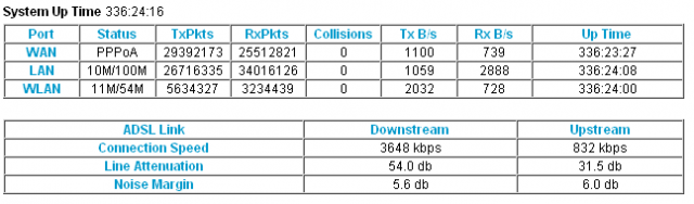

Damn! I have the same downstream attenuation and can only get 4Mb! Consider yourself lucky lol
