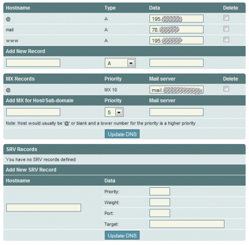

I set up the SBS VM with the, say, domain.local. The domain that i want to use with this (for email, VPN and RWW) is domain.co.uk. On the host where domain.co.uk is hosted, i have setup the following DNS records (see attached).
First of all, do these look correct? Do i need any more?
Can someone explain, the @ in the MX record (and the @ in the A record)? Further, i do not see understand if i have to have my mail.domain.co.uk match my servername.domain.co.uk - does that make sense?

Everything looks fine with your DNS, you don't need any more entries. VPN, mail, and webmail are all going to go through your mail.x.x.
MX record = Mail eXchange, this is how the internet knows where to route mail. The MX record has to point to an A record. The @ is your main domain ip address, if you just type in domain.co.uk it will direct to that IP Address.
"Further, i do not see understand if i have to have my mail.domain.co.uk match my servername.domain.co.uk - does that make sense?" <---- I don't really understand this question but will give it my best, The A record is just a friendly name on the internet, it has absolutly nothing to do with your internal naming conventions. In otherwords, it does not have to match your computer name as it doesn't resolve to an internal address, it resolves to your external address (external to your network or vmware network).

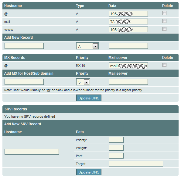

I understand the DNS record setup now (i think!). What i was trying to ask was whether in the SBS CEICW, where you create the webserver certificate and have to supply the FQDN of the server, does this (say servername.domain.co.uk) have to match what you have setup the MX record as. I now undertsand that the FQDN that you set in the CEICW is kinda arbitrary, because as long as you setup a matching A record in the DNS then it will all be fine to access RWW etc (so you can then have a separate MX record, say mail.domain.co.uk for mail - as long as that also has a matching A record to the external IP).
I have attached a screenshot of my new DNS records for clarity (78.xxx.xxx.xxx is the external IP of the router. 195.xxx.xxx.xxx is the IP used for web hosting - which is unrelated to any of this)

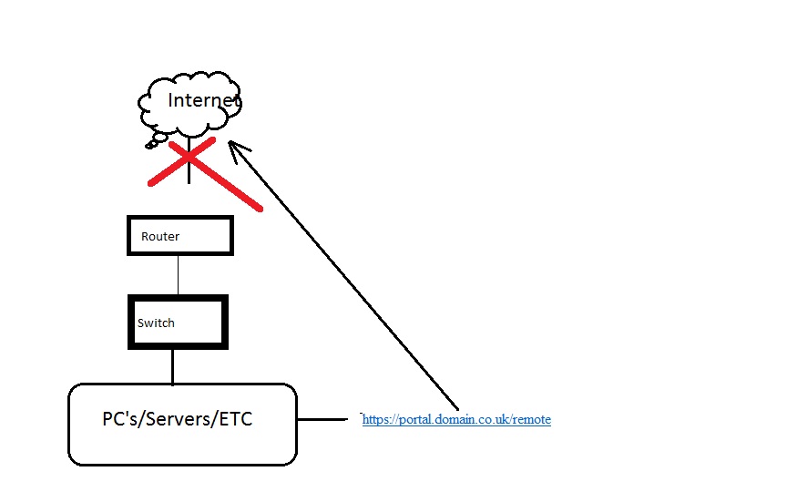

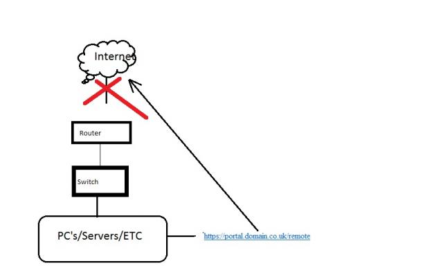

It has to be outside the inside interface of the router. In other words on the public ip segment. If you want it to answer behind the router, any pc behind the router not just behind the vmware server virtual ip range, you would have to put it in the internal DNS server.
I am attaching a very crude drawing but this is basically what you are trying to accomplish, and it is failing on coming back into the router.

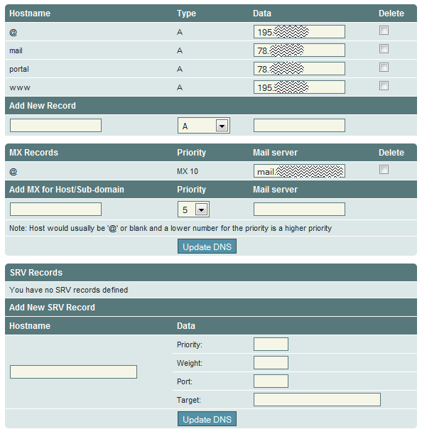

owa.domain.co.uk and being sent to portal.domain.co.uk/reomote
rww.domain.co.uk and being sent to portal.domain.co.uk/exchange
Can this be done? Does it require CNAMEs?
Thanks again for all your help. Much appreciated.
I am assuming that you have an internal dns server (if you are using AD you have to), Put in another forward zone matching your external domain name, then put in an a record for portal, owa, and rww. it is not going to default to the subdirectory exchange or remote. you could put in a webpage at portal that has the links pointing to exchange or remote. You can have the default web page automatically point to one or the other when the page is hit, but that is about it.
