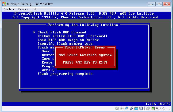

+BudMan MVC Posted January 25, 2010 MVC Share Posted January 25, 2010 (edited) here you go dude -- I did a test run.. I could not get the latest version of tftp32 to work (will look into that later I think), backed off to version 3.03 or something. Anyway.. I even made a floppy image for you ;) Everything you need is in the Zip file.. Just unzip it to say c:\tftpd, run the tftp32 exe and make sure you setup the dchp server stuff. here is screen shot of mine. You might need to change the network to match up to your machines IP etc. Make sure you turn off any other dhcp servers on your network (your router for example when doing this) Then boot your machine with pxe.. You will end up at a A:\ prompt -- and then just run the bios boot file for the L400A9.exe I put into the image. See here is the virtual machine booting from the pxe server. You will then see it load the image file and boot caldera dos, etc.. Now If this F's up your machine -- thats on you dude.. Just trying to help.. Don't use my bios update file if your worried, etc. I grabbed the one for the L400 so if that is what your machine is - it should work. tftpd.zip Kondrath and whoisit98 2 Share Link to comment https://www.neowin.net/forum/topic/868520-installing-xp-via-network-boot/#findComment-592156138 Share on other sites More sharing options...

+BudMan MVC Posted January 25, 2010 MVC Share Posted January 25, 2010 Im not sure why he think he needs some 64bit virtual floppy drive? Unless he was looking to create the floppy image.. I just grabbed freedos.exe and extract the files using winimage, then added his bios file to create the imz file. I agree with you more modern stuff allow for updating the bios by running a file inside windows - but for that old L400 the only bios files I saw were one to create a floppy image, and the exe you put on your own floppy. Link to comment https://www.neowin.net/forum/topic/868520-installing-xp-via-network-boot/#findComment-592156184 Share on other sites More sharing options...
Kondrath Posted January 26, 2010 Author Share Posted January 26, 2010 (edited) Sorry for that last PM, the boards were messing up and I couldn't update you on the progress. I figured out how to do everything, and the bios is successfully flashed! Thank you very much for all of your help! Though, I don't see a boot from USB in the BIOS... :rofl: ... Hopefully I'll figure the rest out! Edit: Nevermind, it added support for an F12 boot menu. Thanks again! Edit again: Still not booting into the USB. I really hope it's just my USB stick or something. But it seems that the USB is not getting any power until windows starts. Sigh. Edited January 26, 2010 by Kondrath Link to comment https://www.neowin.net/forum/topic/868520-installing-xp-via-network-boot/#findComment-592156574 Share on other sites More sharing options...

delukard Posted December 19, 2010 Share Posted December 19, 2010 HI! thanks for all this info and the files, But i get stuck at A: in dos, what file should i run? i dont see the bios file thanks!! Sorry i couldn't edit post. I runs the name of the dell bios file and it updated the bios , TY very much for this image!. all i need to see if i can boot fom usb now. Link to comment https://www.neowin.net/forum/topic/868520-installing-xp-via-network-boot/#findComment-593508622 Share on other sites More sharing options...
