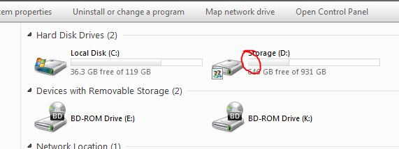

yes i tried alot to fix but this is there .. i dont know why.
I got problem at my system too =P
I fix it simply by just making sure that the left margin of the progressbars is not higher then 4 ;)

I have taken a look and it is only the following that needs to be changed: "Buttons, Boxes & Controls > Progress Bars > Normal > Fill > <4>" change the value of "SIZINGMARGINS:MARGINS" to "1,3,7,6"
Edit:
I changed it to your suggested numbers but I'm still seeing no change unfortunately.
it only seems to happen when a certain % of your hard drive storage is used.
I think you did something wrong...
I made for test a virtualbox with same hdd size situation and it just works....
if I did it wrong I'm not sure how...I adjusted the section you indicated and re-saved the theme but still no joy.
my bad....
I have taken a look again and following will work:
import following image: http://dl.getdropbox.com/u/4281191/progressbar-fix.png
then use at SIZINGMARGINS:MARGINS: 1,1,2,2
hmmm...same result I'm afraid...can't understand it...replaced image and adjusted sizes but still same problem
but I thank you for trying to remedy the problem buddy...:)
Sure that you choose when you was importing "replace old image" instead of "resize image" ?
