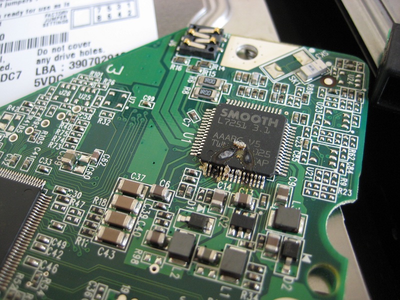

I wonder if someone else is having problems with PCB frying up in the Green Caviar line.

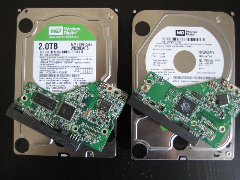

I had a 500 dead few weeks ago. I thought it was ok, was the first time a WD died on me. (i have 6 WD hard drives actually)
So last week i decided to increase my storage space and bought 2x 2TB Green Caviar for backup purpose and for my astonishement one stopped working.
I checked every SATA port and cable possible just to realize the drive wasnt working and i notice the PCB was very hot.
I decided to unscrew the PC (4 screw, no warraty seal) to check it out.
And on of the chips was kind of melted.

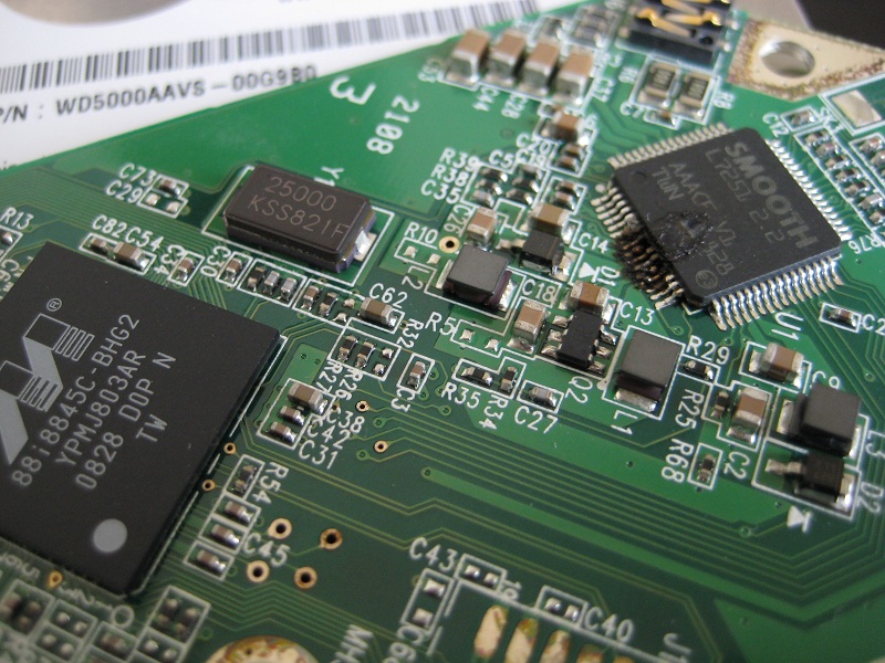

SO i got the dead 500GB and did the same to realize it had exactly the same chip fried.
The impressive part is that there is 2x 120mm fans directly infront of the HDs, the case is always very cool since it is a storage PC.
Has an excellent PSU too, a Corsair 850W (few months old).
What do you think it might be buring the chips ?
Faulty product ?
The previous day i had set a huge backup of 1.5TB of data.
Im kind of disappointed with WD.
What are your experiences with it ?
Thnaks for your input.

It looks like both motor controller chips were burned out.
From my knowledge, there are two likely scenarios:
  1. It's susceptible to power fluctuations so your PSU (or a power surge) may have overstressed it.
  2. It was defective.
I'd say the former is more likely since both hard drives were affected.

they didn't fry with the same computer....the 500GB fried before under another PSU.
but i agree, the MOBO i was installing kept rebooting. It was a Zotac. Maybe this is the culprit.
Anyway, i took the Mobo and HD to the store....i hope they will replace them.
Today those ******* find any excuse to not give you warranty.
