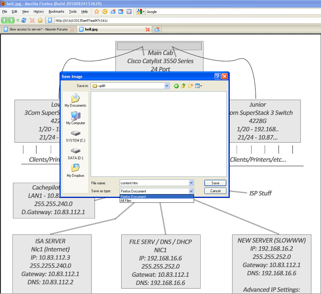

What did you use to draw that?? Its freaking HUGE!!! I had to zoom all the way out to even get most of it to display, still have to scroll down.
Its a START.. But what does ISP actually mean?? Do you have a router there? What device? and what exactly is this cachepilot.. Is it this?

Used photoshop A4 just to have enough room, if you save it you'll get a screen sized view of it.

if I try and save that -- it wants to save it as a HTML file -- its not a picture.. And A4 is standard picture size.. So I have no idea what is going on there.. Photoshop is not a networking diagram tool -- why didn't you just use one of the FREE tools I pointed to if you don't have visio? I will convert it to an actual network diagram using one of the tools - then we can actually collaborate on the drawing(s)
this is what I see, and can not save it as a image. After zooming ALL THE WAY OUT!!

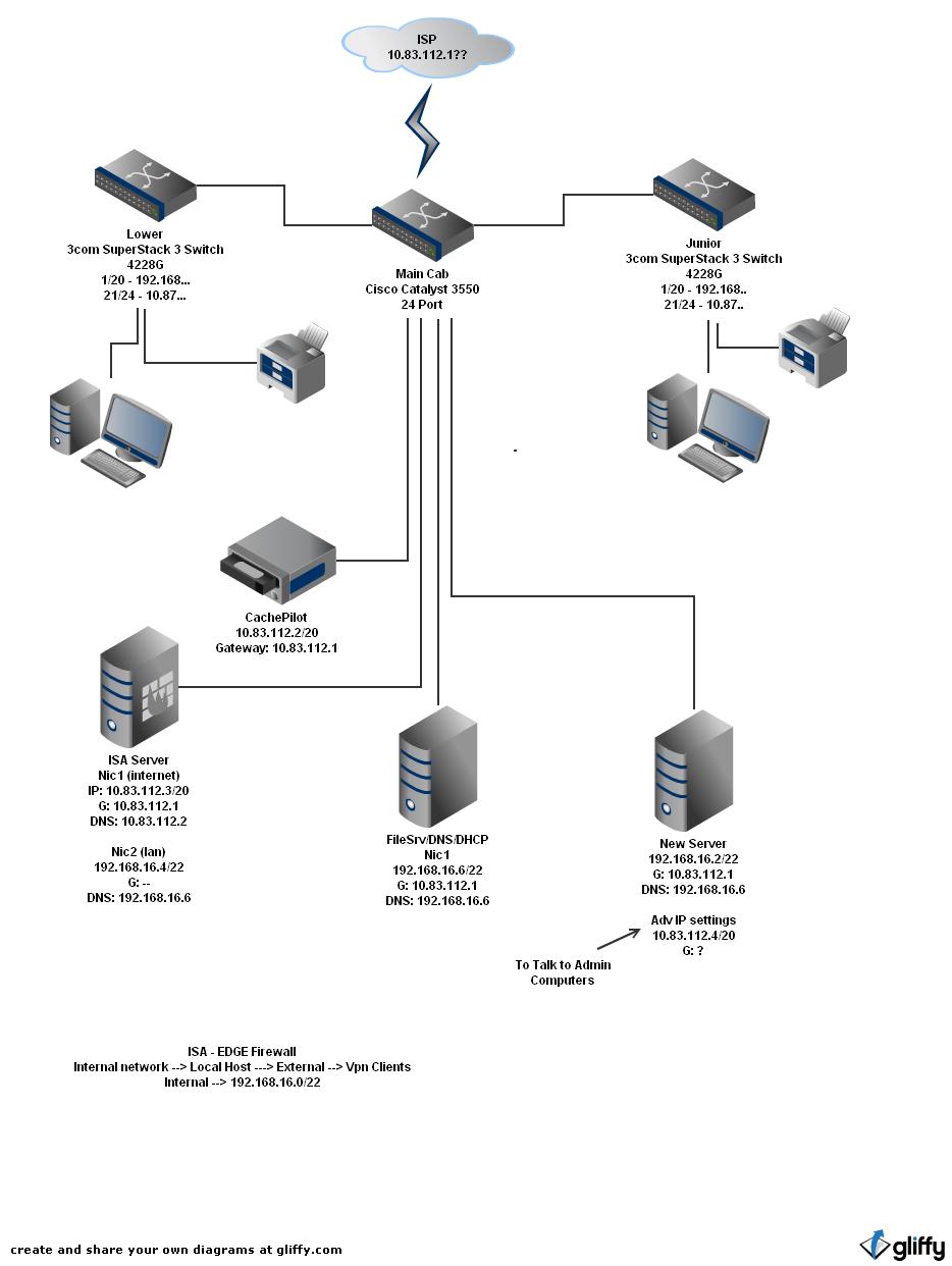

edit: hey PM me your email address, and I will add you to the gliffy account just set up and we can work on the drawings that way.
Ok -- I have what you have in gliffy so it will be easier to work with. Here is what it looks like in gliffy
PM me your email and will get you access so we can work together on the drawings and fix, etc.
Ok -- now we are getting somewhere.. You you have clearly left out some very key info!

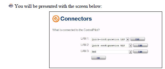

Seems these cachepilots all have atleast 2 interfaces.. Every model I looked at did
So why are you only showing it having 1 IP??
And looks like you can configure which interface is used for what.
So we seem to have a drawing - but missing lots and lots of key information on how this network actually functions. For the life of me can not figure out how anything in the 192 network is getting to the internet.. Since there is no gateway listed in this network. Only thing that should be able to talk to the internet is devices that have an IP on the 10.83 and point to this magic 10.83.112.1 address from what I can make out..
Also from this
"Yes, the 'admin lan 10.87' is (almost) completely isolated from the curriculum network. The old setup had SIMS.net running from the main admin computer as it was only required for the 4 admin machines, however we now have SIMS.net in all classrooms, so we installed the 'new server' to run SIMS, the server is on the Curriculum Network, we added the extra IP range to it's NIC (as shown on the drawing) so the admin computers could access it."
So I take it we can just re-ip these 10.87 boxes and put them on the 192 network??? You have no need for anything on the 10.87? Because from the drawing I can not make out what they would be talking to other than each other.

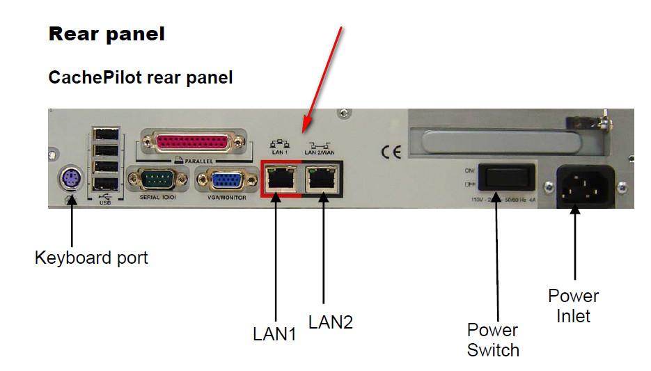

We only have one LAN on the Cachepilot
LAN 1:
10.83.112.2/255.255.240.0 (Private LAN, Trusted)
Default route via LAN 1:
gateway 10.83.112.1

"We only have one LAN on the Cachepilot
Then HOW and the HELL does any of your machines on the 192 talk to it???
Please post the ipconfig of a machine on the 192 network. For example your file server at 192.168.16.6 has NO way to talk to that cachepilot, and NO way to get to the internet.. Since he should not be able to even talk to his gateway since its NOT on his current network.
How an the hell is doing any filtering??? From that config its NOT going to work! Are the clients setup with browser proxy pointing to it?? They really should not be able to talk to it, for sure could not broadcast for name, etc.
Please post configuration of a client machine and how it gets to the internet -- since from what I am seeing they should not be able to.. So we are clearly missing some info.
Also post the config of your 3550 and your 3com switches.. Do they have IPs? Or are they running as just complete dumb switches???

I've just been speaking to one of the tech guys about moving the network onto 10.83, he said i'd need weeks? 99.9% of our stuff is dynamic with only a couple of static devices mainly the servers.
"'he said i'd need weeks?"
BS, at most you need a lunch hour.
Your clients settings are nonsense -- you don't point them to a gateway at all.. So the best I can assume is setup a proxy for them??? To what the ISA? That would be the only possible box you could talk to that can get off your network.
What about this software that needed the 192? again so your cachepilot only has 1 interface?? So its a 1 arm bandit proxy??
Sorry, the cachepilot has 2 interface but only LAN 1 is being used, there is nothing connected to LAN 2.
The software we use has 2 categories 'software management' and 'internet Management'. ISA is only required for internet management, which doesn't get used anyway, i've done some digging and i don't think the IP addresses would make any different for the 'software management' side of the software. Of course i'll need to test this first but it basically runs off the group policies so should be work just fine.
After removing the ISA server from the network, everything would go through the cachepilot. IP addresses should be assigned 10.83. instead of 192. to work with the original network set up. as mentioned above, before ISA we had:
10.87 = Admin Side
10.83 = Curriculum Side
