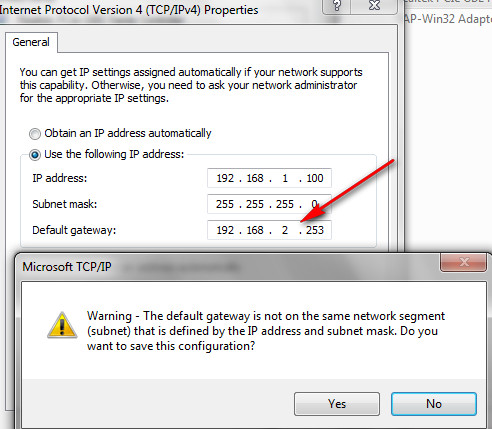

To be honest -- from what I can make of your setup -- nothing should work.. Your running 2 different addresses spaces on the same physical wire, but not putting IPs in the space on the machine.
So no you should not be able to rdp from your box on the 192.168.16/22 -- why are you using that mask I am curious -- how many hosts do you have on that network.. with a /22 like that you could have 1022 hosts, then on your 10 your using a /20 = 4096 hosts... Why are your masks so large?? And no from what your showing even the server should not be able to rdp too it.. Unless you have another IP address setup on it that your not showing in the 10 network?
Your telling it its on the 192.168.16/22 -- but telling it to talk to gateway with IP 10.83.112.1, which device has that IP?? You posted that the internet box has a 10.83.112.2 address -- so what is this .1 device? You can not talk to devices on other networks without routing it.. What your doing is not according to how its suppose to work.. So yeah your going to have all kinds of weird issues.. Remember how my windows machine bitched at me when I told it its gateway was on a different network than its interface.
If for whatever reason you think your locked to the 192.168.16/22 address space??? If you also wanting a machine to talk on the 10.83.112/20 network then you need to give it an IP address in that space on that interface.. So for example..

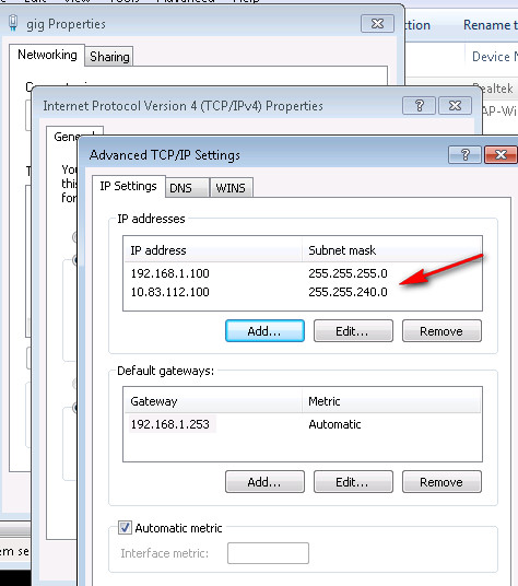

ipconfig /all
Ethernet adapter gig:
Description . . . . . . . . . . . : Realtek PCIe GBE Family Controller
Physical Address. . . . . . . . . : 00-21-9B-03-AC-A7
DHCP Enabled. . . . . . . . . . . : No
IPv4 Address. . . . . . . . . . . : 192.168.1.100(Preferred)
Subnet Mask . . . . . . . . . . . : 255.255.255.0
IPv4 Address. . . . . . . . . . . : 10.83.112.100(Tentative)
Subnet Mask . . . . . . . . . . . : 255.255.240.0
Default Gateway . . . . . . . . . : 192.168.1.253
DNS Servers . . . . . . . . . . . : 192.168.1.4
NetBIOS over Tcpip. . . . . . . . : Enabled
Now I could put other machines on the same wire as my 192.168.1/24 with a 10.83.112/20 address - and this machine could talk to it.. But if wanted to get off either the 192.168.1/24 or 10.83.112/20 networks it would talk to the gateway at 192.168.1.1 to go to say the internet, or any other network that it is not directly connected too.
