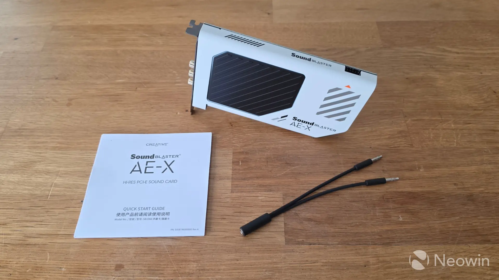

What's in the box:
  • 1 x Sound Blaster AE-X PCIe card
  • 1 x 3.5 mm CTIA TRRS to Dual TRS Headset Splitter Cable
  • 1 x Quick Start Guide
Aside from the Quick Start Guide, which someone at my age (I guess) needs a magnifying glass to read thanks to the tiny fonts, Creative Labs also has the manual online, which first requires you to prove that you're human in order to access it (so I can't direct link it).
Anyway, the box is mostly made up of cardboard, and the only plastic in it is the anti-static bag for the card itself.

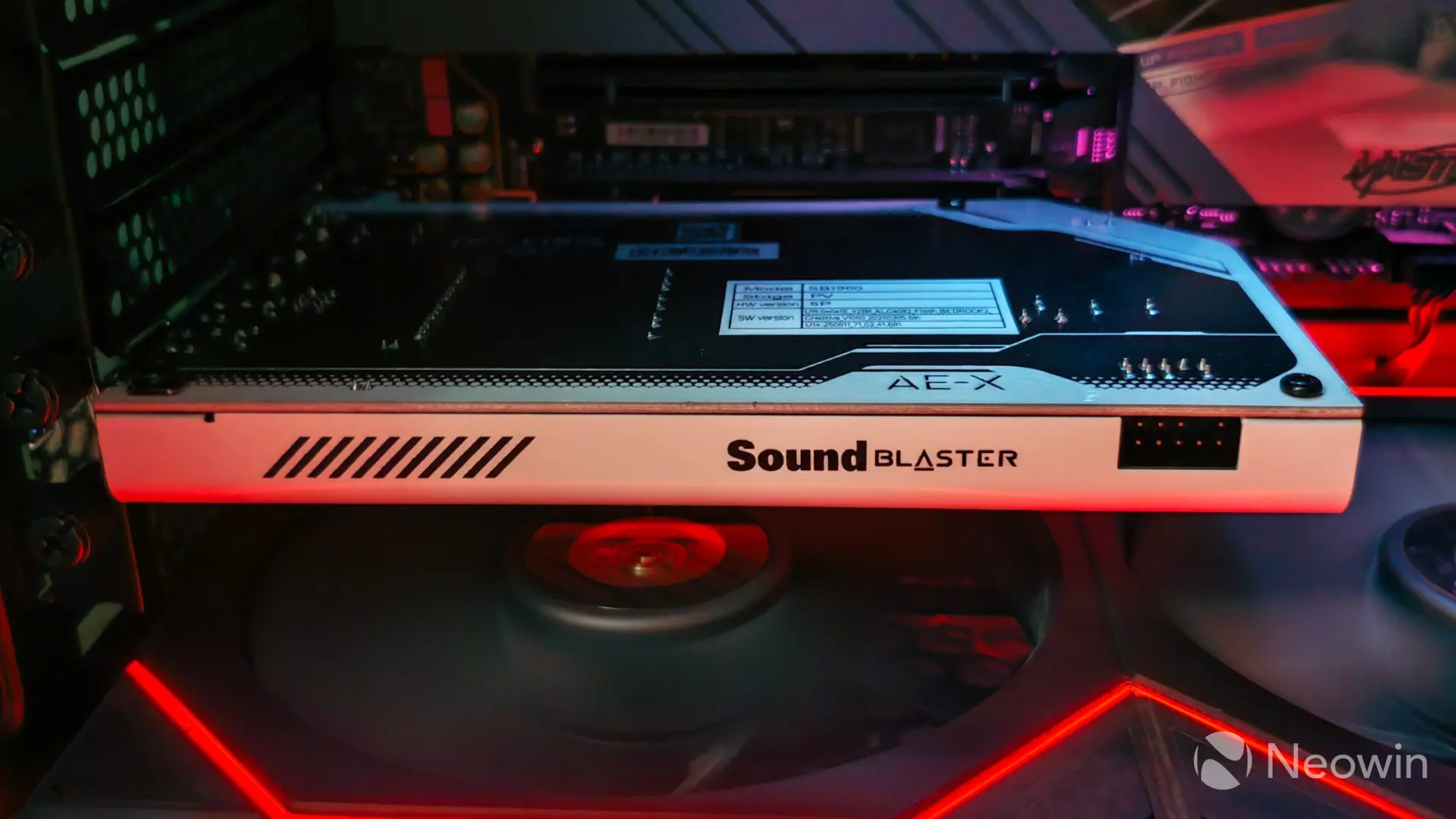

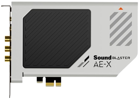

The card itself looks pretty cool and actually wouldn't look out of place in an all-white build. There's only one connector, and for some reason it is awkwardly placed on the side (front-facing) that is for the front panel audio connector, which will let you use the headphones through the front PC audio jack. Since the front panel Headphone Amp has fewer capabilities than the rear headphone port, I decided not to use it.
Rear of card PCI-e interface
The rear of the card is completely open and is normally where you would find the front panel connector. The PCIe interface side is completely covered, which initially made me think it was EMI shielded.
I/O panel Side (front-facing) with Front panel connector

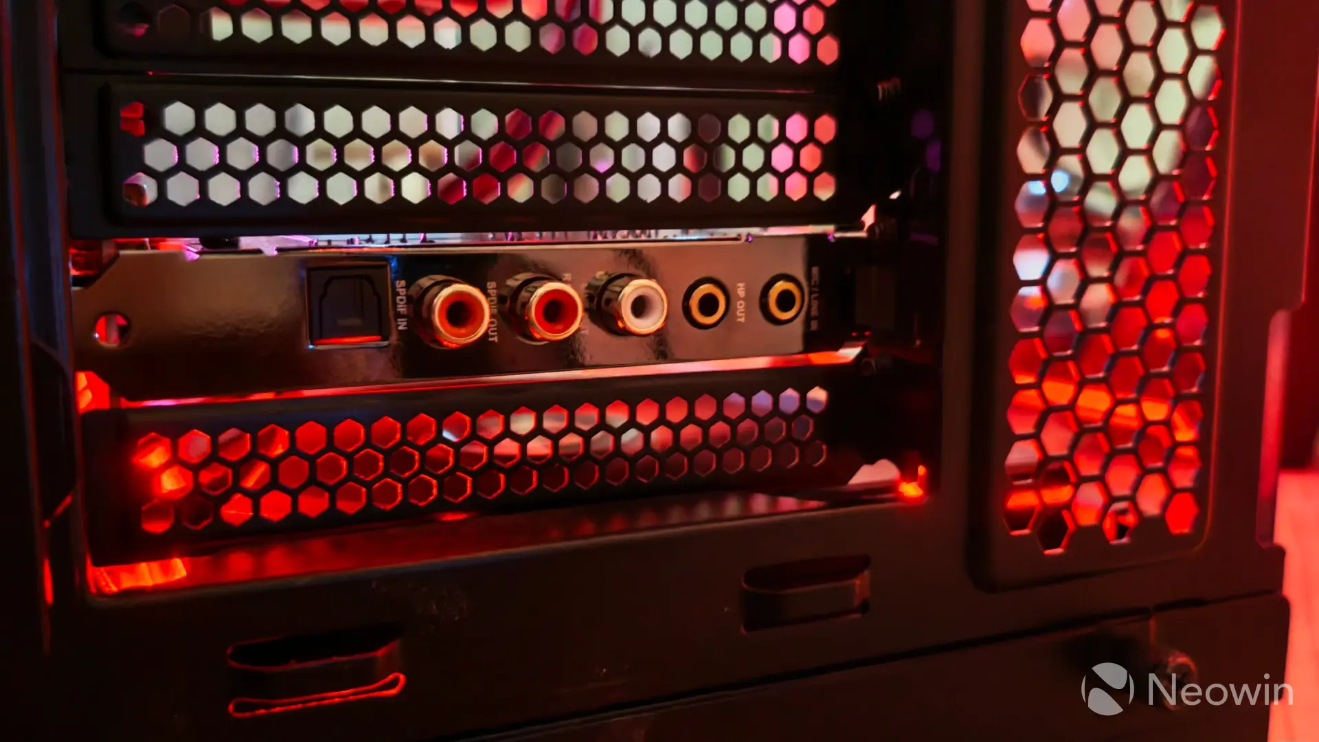

On the outer rear bracket side we have the TOSLINK SPDIF in, Coaxial SPDIF out, RCA line out (Right), RCA line out (Left), Headphone out, and Mic/Line in ports. On the front facing portion of the card itself is the F-panel connector.

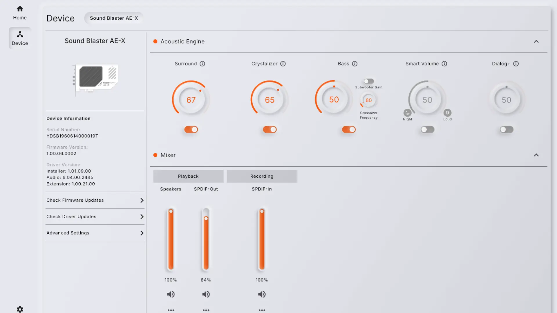

After installing the audio driver, I installed Creative Nexus, which is a relatively new app designed for the latest Sound Blaster cards. Then I discovered the AE-X needed both a driver update from 1.00.15.0001 to 1.01.09.000 and a firmware update from 1.00.06.0000 to 1.00.06.0002, then I was set to go. It should be noted that the card did not work without the driver (not Plug and Play).
creative sound blaster ae-x

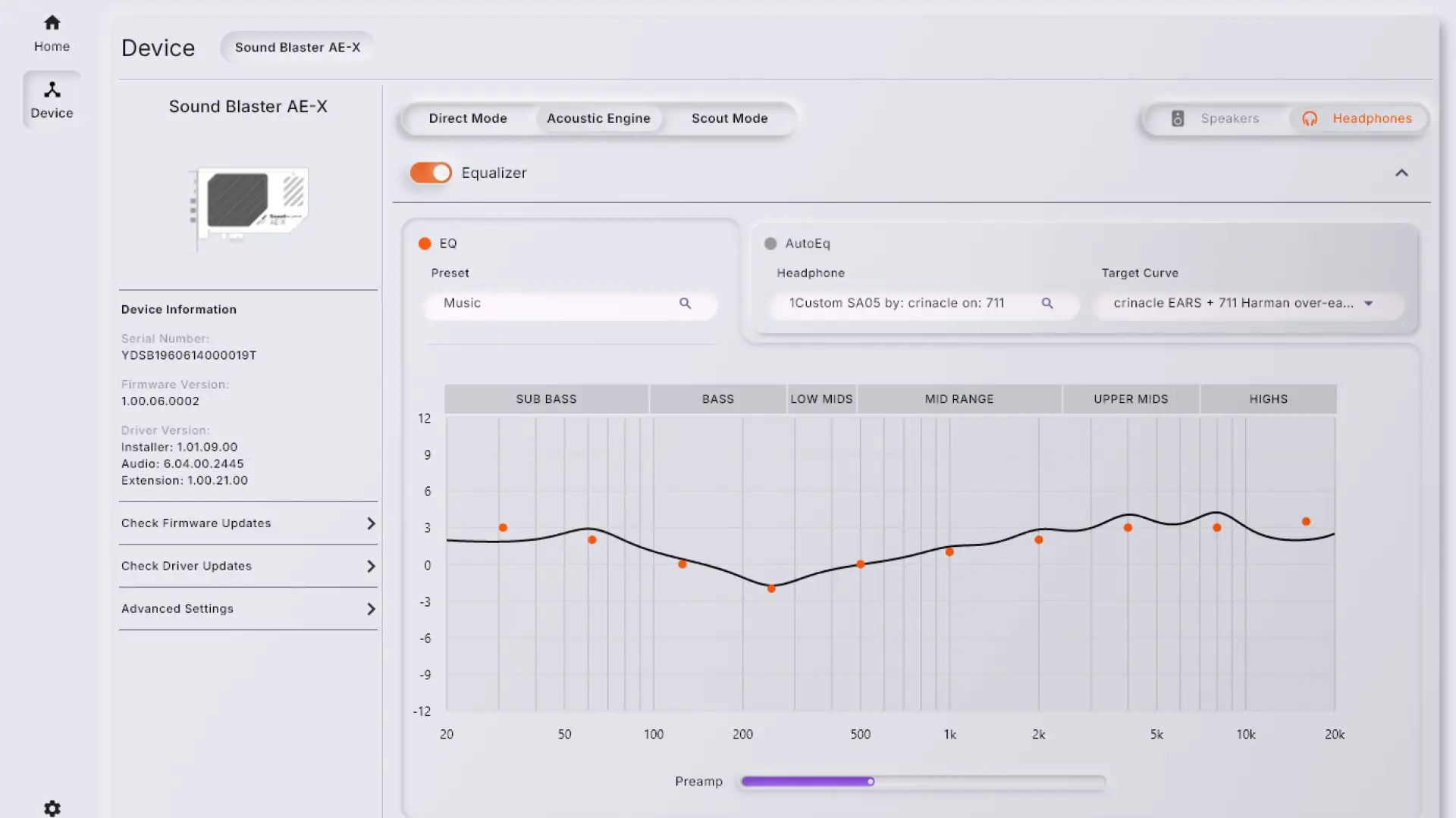

As you can see above, you can manage the firmware, driver, and inputs via Advanced Settings on the Device tab. By default Nexus enabled "Direct Mode". Upon clicking on Acoustic Engine, the Equalizer can be enabled and set to four different presets, which are:
  • Gaming
  • Music
  • Movies
  • Footsteps Enhancer
There's also a dedicated Scout Mode for gamers.

As I said in the Sound Blaster Audigy review, the EQ in the Creative Nexus app offers safe presets, which allows a user to further tweak the lows, mids, and highs for a personal listening experience. Of course it all depends on the headphones you hook up to it.
