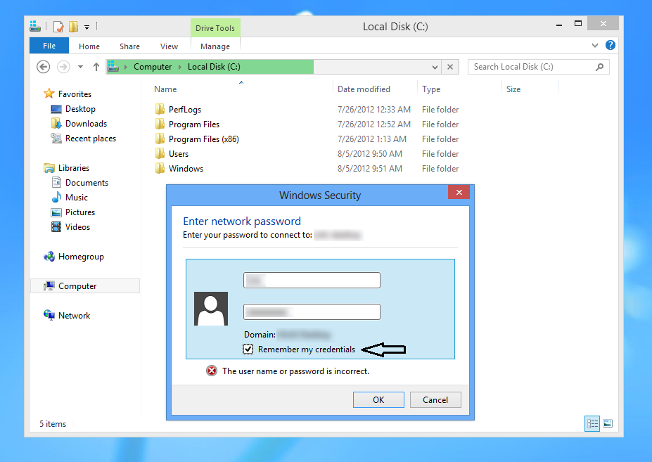

Alright, so while I don't like the solution for my personal issue, I think this should solve your issues.
It's very simple and I overlooked it on the first try. Create a Microsoft Account on Win8 and browse to the machine you want to access via \\computername.
Authenticate and check the remember password option. You should be set from then on out.
