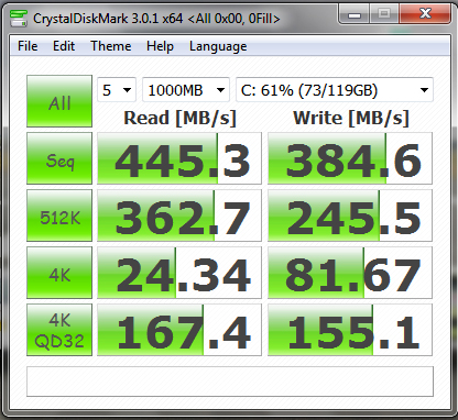

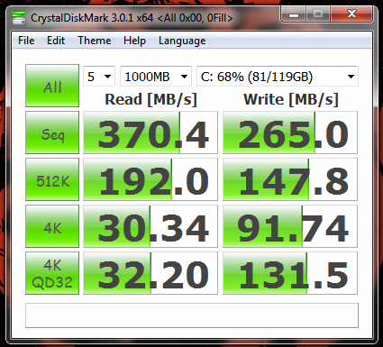

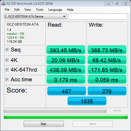

Well, I got my SSD installed and running, and I'm sad to report that I'm less impressed with the benchmark than I expected. It is noticeably faster than my WD Raptor though, so definitely an improvement. I realized that since I transferred over my existing imagine (as opposed to a fresh install), the drive wouldn't have as good as results in CDM as a completely empty drive, but nonetheless, I thought they'd be better than this (see attached).
Few PC Specs:
X4 955 @ 3.4
4GB 1600MHz RAM
(SSD, obviously), which is connected through SATA III. It's the only drive connected ATM.
Thoughts on what could be going wrong here?

Don't worry about synthetic benchmarks. Even low end SSD's should still provide much better system responsiveness than mechanical hard drives so I'd just ignore what the benchmarks are saying and focus on the real world performance.
While quite true, shouldn't I at least get something near the advertised results in benchmarks? While the drive is still much faster than my mechanical one, it bugs me that it isn't even close what I thought it would be.
** And yes, most importantly: I've updated to firmware v1.4.
On Monday, I'll run through those same benchmarks on my Vertex 4 and post the results. I'll also attempt to run them both in Win7 and Win8 Release Preview, which I just installed on Friday night. It should be interesting to see any differences between the two operating systems. Right now I can say that Win8 definitely boots faster than Win7, which is pretty impressive considering how fast Win7 already boots-up.
