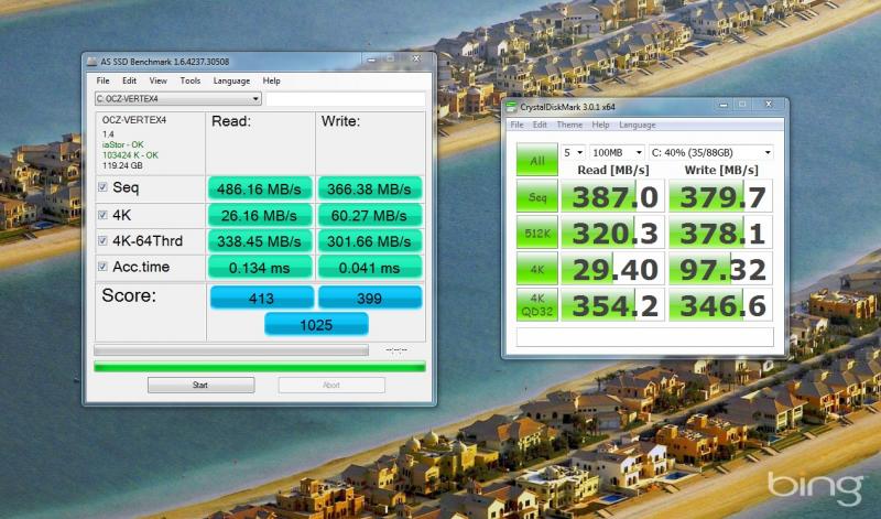

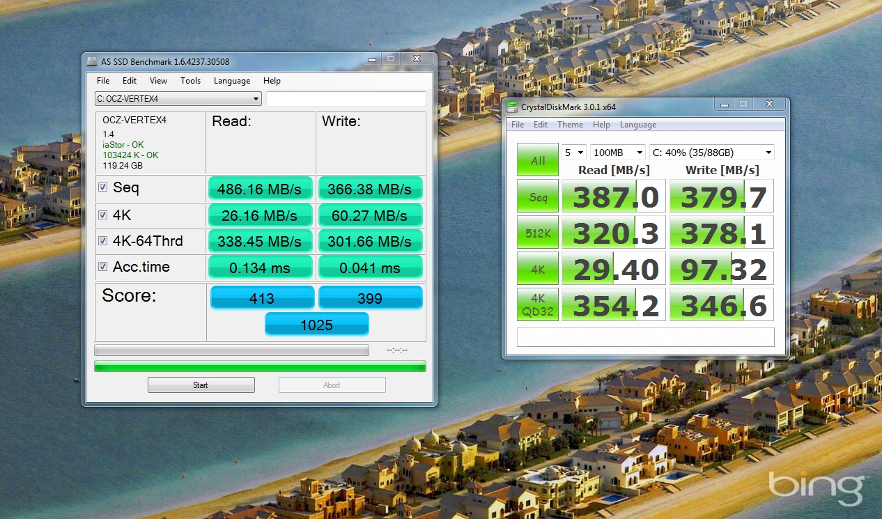

Interesting to say the least. Notice how my ACHI driver is different than yours. Could that be the reason for such different results?
You think so? Maybe.. on AS SSD, I actually have a higher "final" score than you :p due to my surprisingly high 4k-64thrd read speed... And I have no idea about CDM: yours is better in every category there...
Edit 1: So the guy I'm talking to from OCZ has scared me into thinking running benchmarks ruins the drive. This is false, yes?
Since my last benchmark, I've changed quite a few settings and freed up a significant amount of space (~15GB).
Edit 2: Also, I see that on CDM you're using "100MB" on the drop down, whereas I used 1000MB on my benchmark. Would this make a difference?
Something that constantly writes to measure the speed would obviously affect it somewhat there are write limits imposed by the SSD memory type before it begins to degrade. However, I don't think even running it every hour would have a significant impact.
I've observed differences in motherboards can cause a variance in benchmark results between the best and worst performing boards of up to 10%. E.g. - http://www.anandtech.com/show/5850/gigabyte-gaz77mxd3h-review-z77-and-microatx/5
And yes, you'll always be fighting a free space vs what games to have currently installed on the SSD if you're like me :)
I've observed differences in motherboards can cause a variance in benchmark results between the best and worst performing boards of up to 10%. E.g. - http://www.anandtech...-and-microatx/5
The "shouldn't be a problem" is good to hear (On a side note, how many cycles are SSD's these days rated at? I couldn't pinpoint number with OCZ, and I've heard everything from 10,000 to 1 Million). About the space problem, I just hooked up my old 160GB WD drive, so that's going to help me out a bunch :)

I thought I'd go ahead and post this on both threads of mine, since there are some people following this one. Installed SSD, enabled AHCI, and fixed my random keyboard problem. Here are some benchmark screenshots! :D
Real world performance is almost never as high as the advertised speed, which is only really ever achieved on large contiguous reads. It's also worth noting that a great deal depends on the chipset you're using, it tends to average out that the best performing SSD's are paired with Intel chipsets or SATAIII Raid cards in most top benchmarks
So I hear :( I wish I'd known that before buying an SSD; then again, it probably wouldn't have changed my mind. Anywho, I updated my drivers to AMD AHCI from MSAHCI, and here are my (hopefully final) benchmarks:
