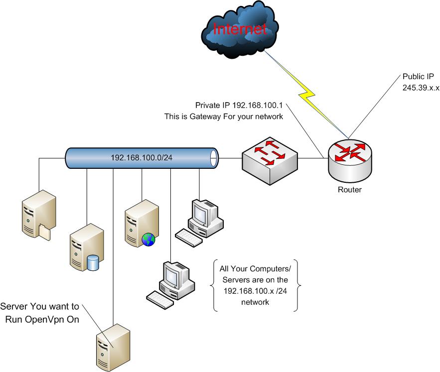

Forget the openvpn server -- draw me your network as it exists today -- did you throw in that second router because you thought you needed it for the vpn?

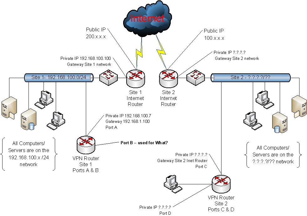

edit: Ok this is how I see your network BEFORE doing anything with VPN -- is this correct?

Its better if the actual gateway/firewall/router on the edge of your network run openvpn vs a server on the inside. At least from running a routed method of client access.
post-14624-0-67564500-1340972090_thumb.j
completely correct. that is my current network as of right now (xcluding vpn)

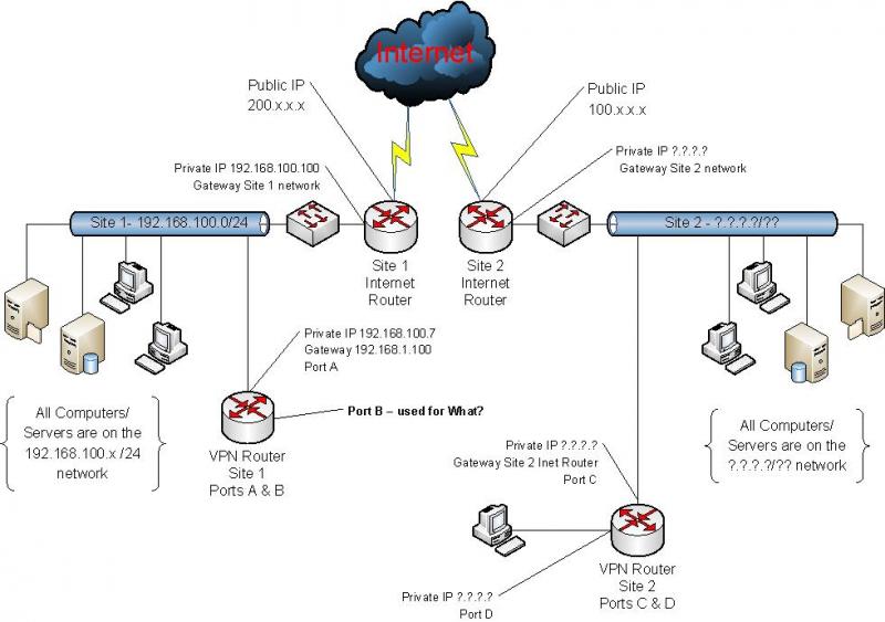

Ok here is how I understand your network -- have not put in any vpn details. But this is your 2 sites, with the 2 routers your wanting to use for your VPN to connect the 2 sites together and how they are attached to the current networks. How I am understanding it so far.
post-14624-0-52676100-1340989051_thumb.j
What I don't understand is why the 2 vpn routers in the first place? What are the model numbers of the internet routers at these 2 locations. The same devices that you PM'd me?
And I can understand at site 2 hanging something off of port D that you want to access from site 1. But I am confused on what you think port b on vpn router in site 1 is needed for?
Where do you want to access this PC connected to port D from in Site 1?

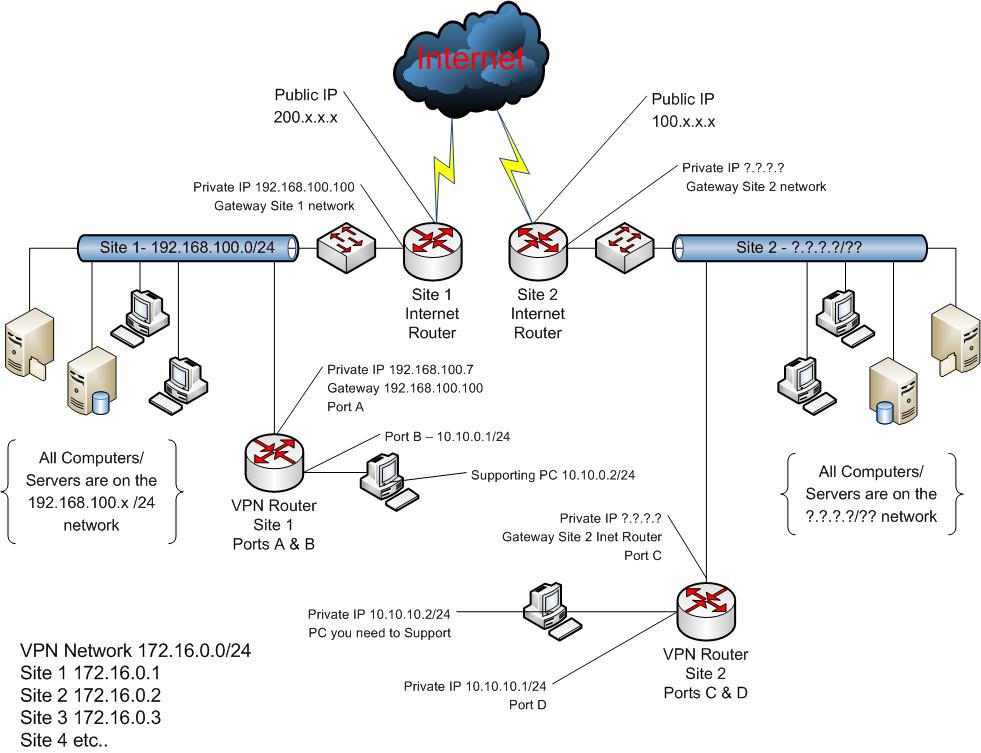

"Router 1's port B will be used for servicing the device (another network different)"
What is the network ?.?.?.?/?? Is this another PC, why can you not just access the device on site 2 vpn router port D from some device on your 192.168.100.x/24 network.

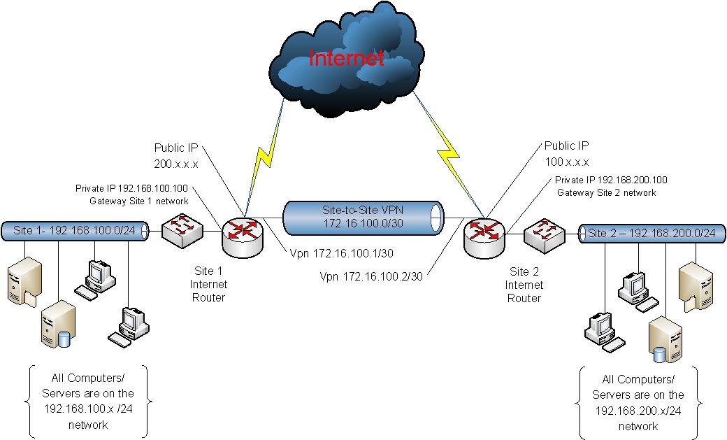

If you want devices from site 1 to talk to devices in site 2 I would just setup a site-to-site vpn something like this.
post-14624-0-70413500-1340990310_thumb.j
then all your devices could talk to each other - like they were the same site really, just a bit slower depending on your internet speeds.
it looks i believe correct. vpn router at site one should have gateway of 192.168.100.100 insteda of 192.168.1.100 right?
port b (afaik) is just to service the router (configuration)
the reason for the 2 vpn routers is because one (site a) will act as a server and the other (site b) will act as a client.

yes, at port d there is a posibility of being 1 or more devices (via switch) hanging off that.
the "?.?.?.?" network is another network not located at site a. it means i can have a site b, site c, site d, etc.
speed for now isnt really that important as it would be simply switches to be seen and editing/sending text files.

Who told you that? You can not have a vpn with with the same network on both sides! Yes in general if your running an ODD ball network on your side, its unlikely that you will run into a problem.
But sorry you can not vpn network 192.168.100.0/24 at site A if site B is using the same address space, ie 192.168.100.0/24
Now you could NAT in the case of same network on the other side, etc. So you can work around it - but understanding the address space on both network is kind of requirement!

But I think I now get this -- so your going to throw these into a remote site to monitor and remote access 1 specific piece of equipment or the PC that manages this industrial equipment.
This is not you creating a vpn to another site of your company, but some remote customer your supporting 1 piece of equipment with?
I am thinking there is more of language barrier here than I thought - so you have 4 of these NB1600 wireline currently?? This seems unlikely. This customer your supporting at the remote site is using this NB1600 as their "internet" router for their whole network? That seems unlikely to me after reading the whole manual, and not just jumping to see what it supports for vpn solutions.
Here is the thing. If what you want to do is connect some ethernet device to this, and plop this into someones network, then no it does not matter what network they are using because YOU control the network that is connected to the lan port of this router.. Its not their network - this is where my confusion came in. But what you will need is the ability to get out of their network via whatever port your using as the openvpn port. And I can tell you right now, that most companies don't allow 1194 UDP outbound from their network. Now if your going to work with their IT to allow this to happen, sure that is not a problem then.
So now on your end. If your going to access the device that is on the other side with a PC connected to port B of the device on your end does not matter what network your lan is using because you can control what network is on this device. If you want any device on your network to be able to connect to this device on the remote site, then this should be your gateway device.
So now this is how I see what you want to do.
post-14624-0-04746900-1341055878_thumb.j
And as you add different sites their PC your supporting would be on say 10.10.20.0/24, and then 10.10.30.0/24, etc.
What I would REALLY Suggest you do is the company that sold you this - to get their butts back into your place and show you how to use this so that you understand it.
Now if your internet router supports vpn connections, then you could endpoint the remote clients vpn to your gateway device and anything on your network could access the vpn clients PCs
But if you have the endpoint inside your network, only PCs connected to this router other B port would be able to access the vpn clients PCs. In the above example, PC on your 192.168.100.0/24 network would not know how to get to 10.10.10.0/24 -- you would have tell the PCs on your 192.168.100.0/24 network that 192.168.100.7 was the hop for the 10.10.10.0/24, and you would also have to tell the remote router how to get to a 192.168.100.0/24 network - would not be a very efficient setup if you ask me.
Either we are having more of language barrier than I thought, or your not very good with routing? And how different networks know how to get too other networks, etc.
edit: Question, if its a PC on the remote side you need to support, why don't they just run a openvpn client on the PC directly - why do you need this vpn router?? Is the other end actually a piece of equipment and not say a PC running windows or linux?
And not sure why you need this router on your end - if your using openvpn, any linux box would work you don't need a piece of equipment that has a limit of 10 vpn connections on your end.
no no no. there are only 2 NB1600: one is ours at our site (server) and the other will be at the remove company's site on our equipment client. neither of them act or will act as the internet router for their whole network.
i also had this doubt (about their port being opened/unopened)
the thing is on the product page is speicifcally says this:
Using TCP port 80 for the VPN allows passing most firewalls in a factory or on customer side.
the link i sent u in the pm says that so i imagine this is how it gets pass the firewall. i have doubts about this but maybe you can clear it up as to some "trick" it has to be able to do this
heres one of the oddest of the parts which i completely do not understand why: he told me that if i in port d i connect a switch and have different equipment i wud have to assign something like this:
port d: 176.16.0.0 (the network range)
switch
equipment handing of the first port of the switch: 176.16.1.0
equipment handing of the second port of the switch: 176.16.2.0
equipment handing of the third port of the switch: 176.16.3.0
why wud this even be needed???
the guy doesnt "control" what he is doing. they were trying to sell us a product which was not in the catalog (because I phoned up NetModule to ask something and they said they dont make the product anymore and there isnt even any mention of it on their site) and netmodule told me that they dont sell it anymore because bascially what they sold was a pc with a openvpn server preconfigured and they dont sell it becuase most companies already have a server/router/etc with openvpn. anyways, i told my boss about this (wasnt happy) and he told the company trying to sell us the prodcut this (they didnt even know it was discontinued) and obviously they were still selling the discontinued product but never tried out the new product so they dont know how to configure it (the "if it aint broke, dont fix it" thing) so the guy really has no idea wha he is doing. he simply goes by trial and error and obviously i dont know anything that he even tries so........
the internet router controls vpn connections but i dont know what kind. might be pptp which is kind of insegure right?
