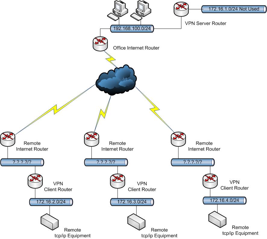

"if i connect to the openvpn server at my office, that makes me a client right?"
If use a VPN client to connect to it then yeah -- Why and the F would you do that??? Your on the same freaking lan!
If you don't use the openvpn client, or on the client network that the remote vpn routers then NO your not a client.
BTW, that drawing is the best you have put up so far -- other than leaving out all the NAT routers that are in front of all the vpn clients and the vpn server.
edit: Ok this is a better drawing of what your doing - is it not? You have no idea what the remote private networks are. And your remote devices are on some 172.16.x vpn networks. But your trying to admin/support them from boxes on the 192.168.100.0/24 network at your office. And your using 10.10.x addresses as your vpn tunnel endpoints.
And you have route in your internet router to point to the vpn router for the different remote 172.16.x.x/24 networks

I add this detail because its IMPORTANT to understand this - or your drawing just looks like a simple site to site vpn setup.
Nor are these 192.168.100 boxes "clients" of the vpn server router. They are not running openvpn client software? Are they?
i wanted to keep the drawing as simple as possible this time....hoping to explain it better.
yes. that drawing is correct, if i understand it correctly. i wont backpedal this time. i bolded what u wrote because that is what i ment when i put it should not matter what the other networks are and when i said it shud "magically" work. obviously not the best wording so i apoligize.
NO. I want to make it clear that the ONLY routes that exist are on the openvpn server/clients. no other device has routes what so ever (other than its obvious defaults).
i wanted to bold that "NO" to make sure that its also clear that the only routes exist on the openvpn server/clients. nothing else. the pcs and the remote tcp/ip equipment have no routes what so ever. the remote tcp/ip equipment have no idea they are on a vpn and the pcs know it because they have openvpn software on them. nothing else.
YES. The 192.168.100.x boxes are running openvpn client software so they can access the openvpn server and read the routes to get to the rest of the remote networks.

So now as I see your problem you don't want clients to be able to talk to each other that are from different sites. But you want client to be able to talk to all the sites?? Yeah I really don't think that is going to work???? Off the top of my head I can't think of way to do that.
i want me, client 1, to talk to all clients (2, 3, 4) but i dont want 2,3,4 to talk to each other. could i put firewall rules in my openvpn server???
