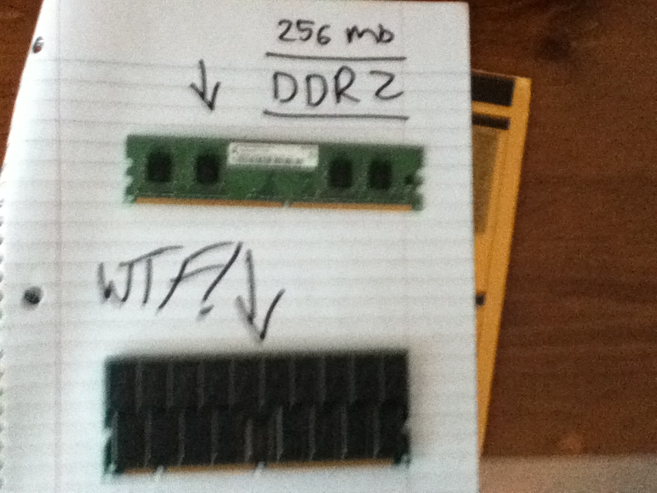

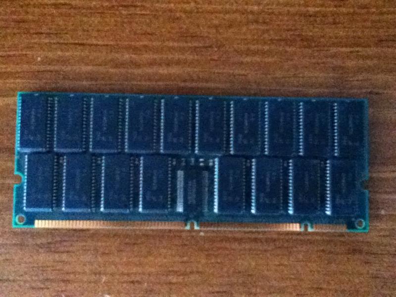

My friend gave me a bunch of his old computer stuff. I've been able to salvage and identify everything else but what you see below. Take a look at this. I've never seen anything like it. I think it's ram but not sure. There are no tags or serials on it, so I can't look it up. It's like ram on steroids! (3rd Pic) Sorry for the bad pics. The only camera I have is my iPod touch. :(
Thanks for your help! You guys are life savers!!!! :)
Side 1:

azspeedbullet    24
looks like the older style pc 100/133 ram
  • Like 1
Share this post
Link to post
TheElite    127
I don't think it is.
Share this post
Link to post
duddit2    194
that be SD RAM, Not DDR or DDR2 or DDR3, just plain old SD Ram.
Share this post
Link to post
capr    36
what does it say on there? I assume you tried just typing everything into google?
Share this post
Link to post
+jamesyfx    352
It looks like standard PC100/133 SDRAM to me as well, the pins and the notches look about right.
It could even be some really late DRAM, but I doubt it.
Share this post
Link to post
BigDavy    11
It looks like some kind of PC100 or PC133 SDRAM - I'm guessing that this memory module came from a server that uses registered/ECC memory.
  • Like 2
Share this post
Link to post
Michael Lacey    2
2 notches is SDRAM usually.. but that has a lot of chips on it so I'm going to go with a regular DIMM.
Share this post
Link to post
duddit2    194
that's a good point about it being from a server (registered/EEC memory) as there does seem to be a lot of chips/capacity.
  • Like 1
Share this post
Link to post
zivan56    22
Its ECC SDRAM. Notice the big chip in the centre, that's a telltale sign. Usually the only chip, apart from the RAM itself, is a tiny one (about less than 0.5x05cm) on the side.
  • Like 1
Share this post
Link to post

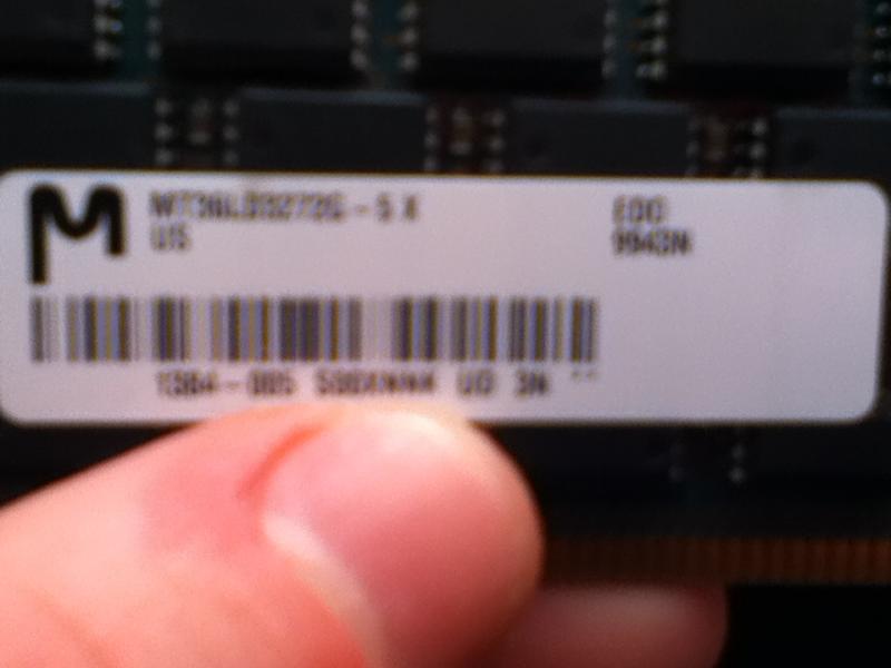

OK. I i did some more digging around in the boxes he gave me and I found a whole stack of it, some with tags on them. How manny MB do you guys think they are? What year?
Tag:
post-447111-0-78446800-1349040964_thumb.
Again I apologize for the quality. The tag says this ( I kept the format as written on the tag):
MT36LD3272G-5x EDO
US 9943n
-barcode is here-
1384-005 s00xnnk ud 3n **
Is this usable? What Mobo and Processor would I need or is it just too old?
Share this post
Link to post

azspeedbullet    24
MT36LD3272G-5x EDO
US 9943n
i googled, and i found this:
http://www.pchub.com/uph/laptop/401-24943-3697/Micron-MT36LD3272G-5-X-Server-Memory-Module.html
http://www.archmemory.com/ram.cfm/Dell-Parts-Dell-256-MB-Memory-DIMM-168-pin-43567-129136
it looks like it is also registered ram too, might be hard to find a motherboard that can work with that
  • Like 1

+goretsky    872
Hello,
It is a Micron Technologies 256MB (32MB?72) EDO ECC with Parity 50ns 168-pin memory module.
You can find the spec sheet for it here on Micron's web site: 8, 16, 32 Meg x 72 Buffered DRAM DIMMs
Regards,
Aryeh Goretsky
  • Like 1
Share this post
Link to post
