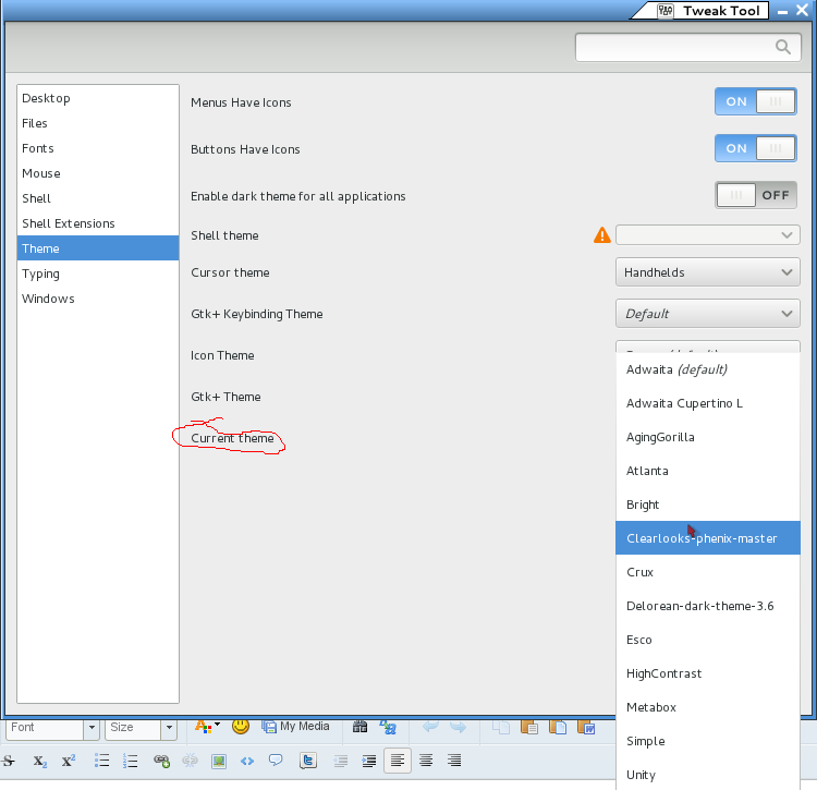

Also if you open gnome-tweak-tool and go to theme and change the bottom one, 'Current Theme', that works? Here it does nothing, maybe they've modified it so it only changed gnome-shell themes, only changing GTK+ themes does anything. If I use gtk-chtheme then it all works fine.

Also, I don't have gnome shell so it doesn't let me set that theme (shell theme).
Not shell theme no, 'current theme', here;

Also, on my screen "Current Theme" says "Shell Theme" and that I can't set it as Gnome Shell isn't installed.
Current theme says shell theme? Humm weird, I've got a shell theme above. Do you not have a 'current theme' on your gnome-tweak-tool?
