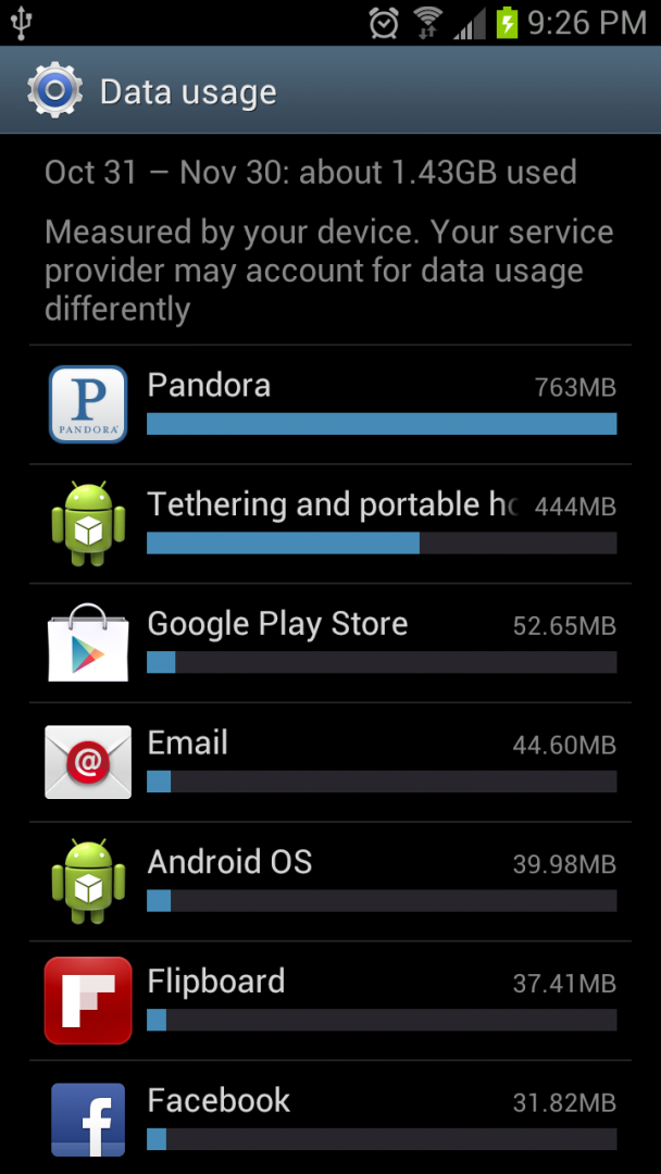

To answer your question, she doesn't view any videos & doesn't view many photos. She doesn't 'click on' the photos when they're in her news feed as they're generally big enough to see anyway. Here's the figures:
Facebook:
Mobile data from 1st Dec (when she topped up)...
Foreground: 114MB
Background: 9.90MB
As for over WiFi....
F/G: 22.96MB
B/G: 6.93MB
This info help you guys any?
Yeah 114 MB foreground, which means that is data consumed while the app is open with her actively using it, background data is for push notifications etc... So she's on Facebook a lot on her phone by the looks of it. You can't blame the phone for that.
with so much foreground data she is using facebook intensively. i hardly believe that there is any malfunctioning of the phone. if it was background data, ok, but foreground? if she keeps her using pattern then she better upgrades her data plan.
Comparing her baseline usage with yours is a bit fallacious when you're likely to have different usage patterns. I've never seen any real evidence that Android phones are any worse than any other for data usage. You want to do a real world comparison then get a fully wiped S3 and follow the same usage pattern you would on your iPhone and then compare the situations.
You've posted that it's foreground FB app usage by way of it using lots of date in the screenshot and sync is turned off...she's using the app. Maybe it's downloading upon opening new updates and/or photos people have posted, that's how the new one gets photos to appear so fast. But really it's nothing to do with the phone...it's FB's app. That said, if it's reporting usage while mobile date is off well I'm not sure how that is as under JB they're integrated...it can't count data with mobile data off, just how it works.

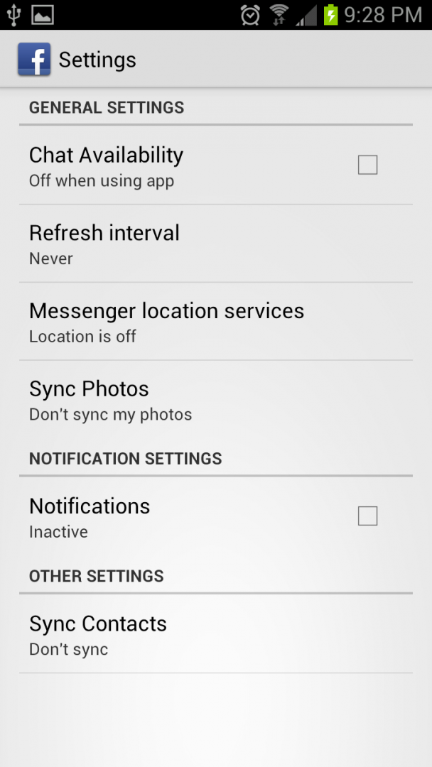

Here's a screenshot of her Facebook settings:
If you need settings screenshots of other apps or whatever then let me know.
Doesn't look like anyone has been able to put their finger on the problem. The response of "she's using facebook a lot" may be true, but she's using it no more than when she had her iPhone & her iPhone didn't munch data. She could revert back to the iPhone right now, use the phone as normal & be ok.
EDIT: Just to note - application requests is ticked in the 2nd image. This must be the default setting as she had it unticked before uninstalling - as in the 3rd image.
