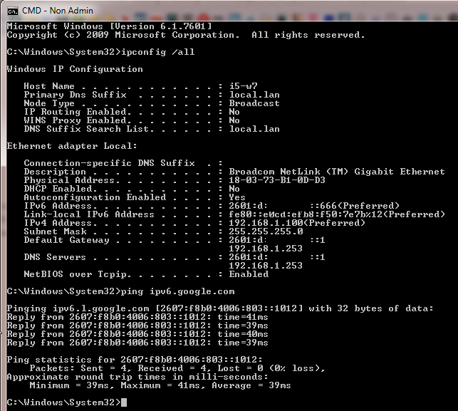

Post an ipconfig /all of your one of your dhcp clients. Also you should NOT be handing out 8.8.8.8 as dns if your boxes are members of AD.. In AD - YOU ONLY point to the AD DNS - PERIOD! This dns then forwards for unknowns.
So lets see ipconfig /all
Then I ping the dhcp server listed there, and I want to see the arp table
arp -a to see the mac of that IP your showing as dhcp server.
Please remember BudMan I did NOT build this network nor from scratch nor from anything; This is the first time they have asked me to look at it. My primary DNS address is the AD

Is this your machine - why is vmware interfaces on it? Looks like you have ipv6 still enabled - you using that? Doubt it, so just other **** that can cause problem your network.
I personally would do some clean up on your boxes and disable ipv6 if your not using it. Purely from a security aspect you don't run protocols you don't need! Simple fix to disable via a reg entry
Yes, I use VMWare on this machine and it is my machine. Noone is using IPv6 nor is there intrest.

You notice my ipconfig /all output only list my actual nic, not the teredo, 6to4 and isatap and notice actually work on ipv6.. You boxes have all that stuff enabled sending out noise on your network for what? Can you even ping ipv6.google.com ?
