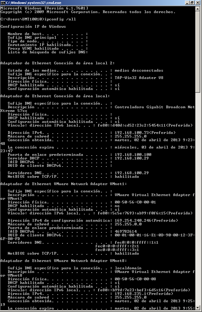

whatever dude - removing **** your NOT using CAN NOT BREAK ANYTHING -- are you using teredo?? NO - its a tunneling protocol for ipv6 over 4, are you using isatap?(Intra-Site Automatic Tunnel Addressing Protocol) -- again a method of doing ipv6 over ipv4, not USING IT
6to4 tunnel, again NOT using it!! if you want to leave a IPv6 stack in place sure go ahead, you sure do not need these tunneling methods enabled. If you want your nic to have a local link IPv6 address, sure go for it - pointless unless your actually using ipv6.. Do your servers even have it enabled? If your running 2k3 server then NO its not.
So what do you want to do enable or disable icmp - I would guess you want to enable, because most likely out of the box its disabled.. I would have to lookup up the manual, I don't use those firewalls - did you read the manual? Which should of be step one before you even took it out of the box!!
I don't know what kind of connection you have, so I could not tell you if your PPP or not..
And again - yes its good security practice to disable protocols your not using, and its also just over all good house keeping.. But sure if you don't care if your house is a complete and utter mess then leave all your tunnels that your not using enabled and just beeping away on your network.. Pointless nonsense you could clean up with a few key strokes in your GP.
"And our DC is Windows Small Business Server 2003"
Then it has NO ipv6 enabled out of the box - did you ENABLE it?? I highly doubt it!!
Then there is NO freaking way anything your doing with xp, vista, w7 or even 8 is doing anything with your server that has anything thing to do with you ipv6. Period - and they don't do anything to each other. So you HAVE NO USE if ipv6 on your network - NONE!! As I already stated disable it on a couple of machines if your worried. It takes 2 seconds and reboot to disable it, and same amount of time to re-enable it if something doesn't working. Which is not the case because if you have 2k3 server your NOT doing anything with ipv6, because its even enabled on that os unless you installed it..
And yes I read your link - it does NOT pertain to ANYTHING you could be doing because your not even running ipv6 on your server - so as I stated before everything ipv6 related on your clients is freaking noise! nothing more...

Here is the updated network with the DNS entry of my router removed and DHCP lease time increased to 1 day:
Next step that should be done? For now, with the new firewall and the AD updated to the new settings, internet access seems to be doing great without a hiccup (for now)
