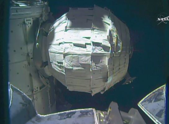

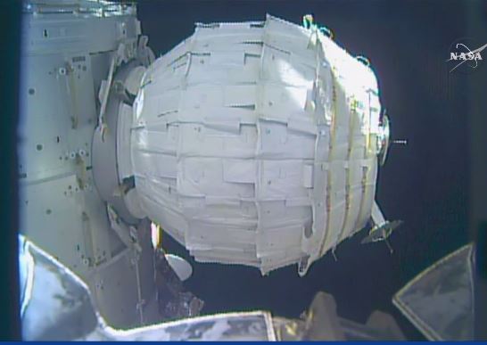

Like watching paint dry...but expected expansion so far. :)  Will be nice to have a time lapse on this.  They are taking a 40 minute break (KU gap) ... resuming in about 40 minutes or so (:35 past the hour).
  • Like 1
They are really expanding now...thought they were going to shut it down until tomorrow.  Anyway, they've been doing 8, 10 and 14 second bursts of air vs. the 1 or so seconds earlier that they've been doing.  Sounds like popcorn popping in the microwave. :)

15 seconds of air ... more popcorn sound which sounds awesome.
Edit...Holy crud...now 30 seconds of air. :)  May turn up my speakers and see if my dogs look at the microwave.
