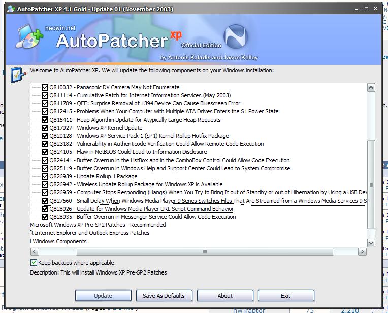

hey, i just did a clean install of XP then autopatcher XP and some updates came up:

also you should add this too:
http://www.microsoft.com/downloads/details...&displaylang=en

look at those 2 patches i underlined, one of them is old, there is a newer patch in the windows media player 9 updates section and the other one is not needed, you have it in the windows media player 9 updates in there..
Dude! Total good call!! (Y) I never would have noticed! Thanks! That'll save me a good 5 MB or so. :) If you notice anything else, please let me know! :D
