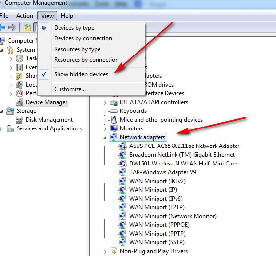

Can you post the output of your ipconfig /all and also this section in device manager - making sure you set show hidden.
