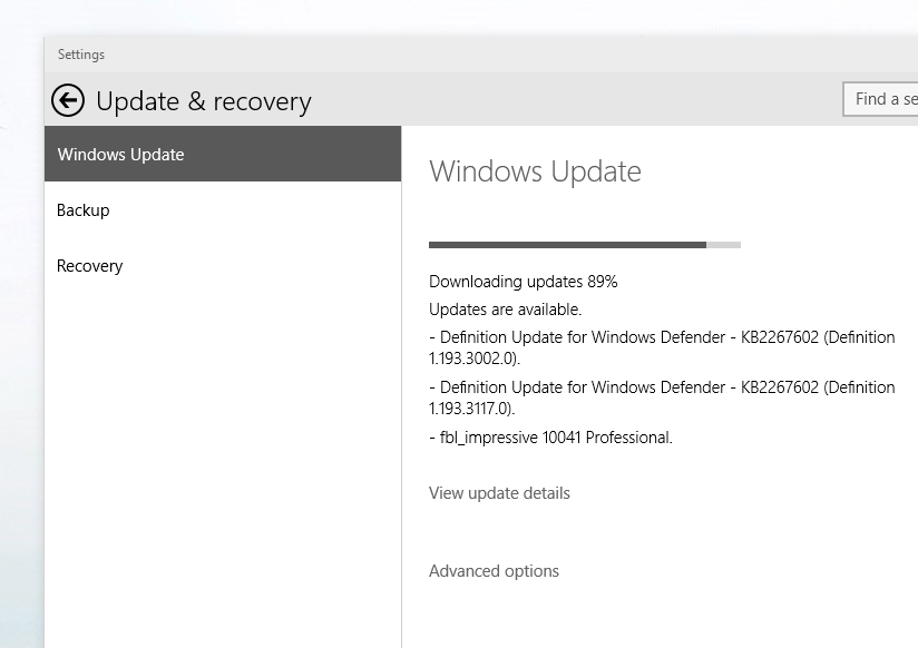

I had the same issue with my graphics driver.  I solved it by going to Device Manager, and uninstalling the driver and then rebooting and letting it be reinstalled.
I have an Asus Tab (me400c) same issue, can't update to 10041. I also have the issue with the Intel video driver failing to install which is preventing other updates from working on 9926. I have removed the driver as suggested by bpa above and rebooted. The 10041 update is now recognized and downloading.
