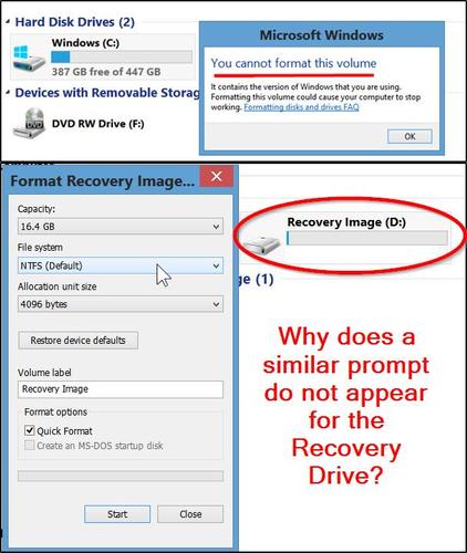

Hello Folks!
Please refer to the enclosed description & help suggest whether 'Recovery Image' or 'Recovery Drive' can really be formatted? Why is there a No prompt to forewarn a User from doing so?
Can a device be still restored to the Factory defaults in case the Recovery drive is done away with? If so, how?

The recovery image is used to replace Windows that was initially installed to your computer back to a clean, formatted primary partition that is used when you recovery your damaged computer to its factory state. If you wipe clean this recovery partition, you will lose this ability. It is a locked partition that was created by your computer's manufacturer.
It is not a good idea to wipe clean this recovery partition because your emergency recovery is gone.

Hi Barney T.
In such a case, an eye-opener Prompt is very much anticipated! Isn't it so?
What if one has already got rid of the Recovery image? What else options are left for him/her during apocalypse? :-)
Please suggest.
^ I suppose, but the partition is usually locked so no prompt is needed. Nothing can be done to it. If the recovery image is gone, you're out of luck and will need to use a Windows CD/DVD  or other installation media to re-install Windows. If you have a valid Windows key, you can use that once Windows is re-installed.
If that is so...how I have been able to get rid of the same through its Format?

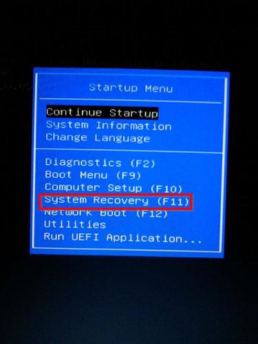

Nevertheless, you think the - "System Recovery" option would still work?..or will it pose some Error?

F12 option will not work because you have removed the recovery image. That image is what F12 will initiate to reinstall.
That partition should NOT be visible. Something isn't as it should be. Go to this path:
Control Panel -> Administrative tools -> Computer Management
and then click on Disk Management in the left sidebar. Now right-click on the Recovery partition and then click "Change drive letter and paths...". In the opened window click the Remove button, yes, and then ok.
Now it won't be shown in explorer and cannot be "accidentally" formatted by user.

Actually, some OEMs do make it visible, usually with a lock image on it.
I did not know that. That's not a good practice. Still, if that partition was unlocked on his computer, then something was not right then.
You would be surprised. I have seen that partition on OEM computers dating back to Windows 7, rarely were they hidden anymore. Usually locked, but still visible.
it sometimes becomes visible after an upgrade.
Anyway the reason for the warning on the system drive is because it literally cannot be formatted because it's the system drive.
other drives can all be formatted even if they contain your lives work, which is more important than some recovery files that can be replaced.

I have already formatted my Recovery Drive out of my free will! ..& it didn't invoke even a single prompt to resist me from doing so!
