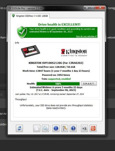

The Evil Overlord Posted May 14, 2017 Share Posted May 14, 2017 12 hours ago, bikeman25 said: Does secure erasing the SSD shorten it's life though? First ever SSD, so nervous on killing it too soon, Can't say for sure, but my Kingston ssd is 4 or 5 years old now (possibly older), and I've reformatted it a few times, ssd life still recons it's good for another 6 years (I doubt it personally, but time will tell) Spoiler +Raze 1 Share Link to comment Share on other sites More sharing options...
bikeman25 Posted May 14, 2017 Author Share Posted May 14, 2017 (edited) Yeah mine don't really support SSD life lol, states unable to determine life span lol, but rating in Western Digitals Lifeguard program shows 99 percent life rating, so guess its ok still, But does show Healthy though, so guess that's just fine then lol Link to comment Share on other sites More sharing options...

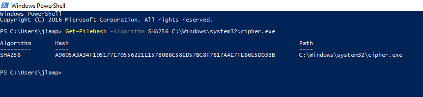

JustGeorge Posted May 14, 2017 Share Posted May 14, 2017 (edited) 20 minutes ago, adrynalyne said: I don't get an error, nor does it show any encrypted files on my drive. I do have them, but I'm not using efs for it. Whats the hash of your cipher.exe? Just tested on my PC @ work. Same result as the other 3 I've tried. Link to comment Share on other sites More sharing options...

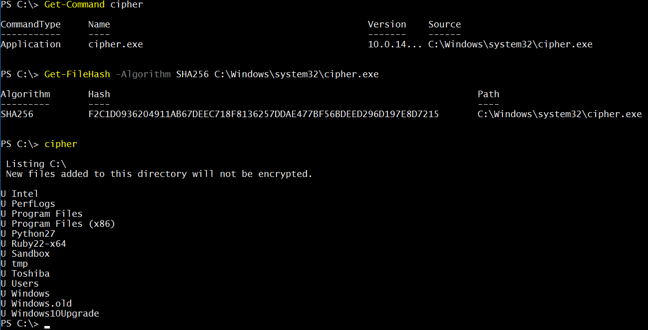

+DonC Subscriber² Posted May 14, 2017 Subscriber² Share Posted May 14, 2017 I'm getting: The first time I ran the cipher command, I got the error message but not the second time. (SHA256 hash included) Edit: This is on Windows 10 Home. Link to comment Share on other sites More sharing options...

+DonC Subscriber² Posted May 14, 2017 Subscriber² Share Posted May 14, 2017 1 minute ago, slamfire92 said: Here's mine: Here's mine: Oh wait, this machine isn't on the Creators Update since it's about to go in for repair and it's likely the drive will be reset to a factory image. (My version string starts with 10.0.14) Link to comment Share on other sites More sharing options...

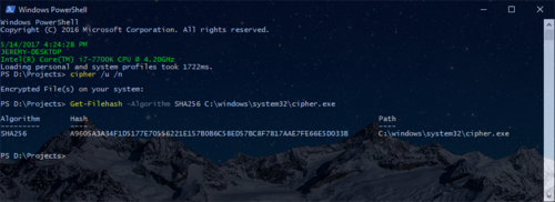

adrynalyne Posted May 14, 2017 Share Posted May 14, 2017 40 minutes ago, slamfire92 said: Whats the hash of your cipher.exe? Just tested on my PC @ work. Same result as the other 3 I've tried. I'm not at home to see. I'll post it later. Link to comment Share on other sites More sharing options...
adrynalyne Posted May 14, 2017 Share Posted May 14, 2017 4 hours ago, slamfire92 said: Link to comment Share on other sites More sharing options...
JustGeorge Posted May 15, 2017 Share Posted May 15, 2017 Well they match, so its not that. Link to comment Share on other sites More sharing options...
