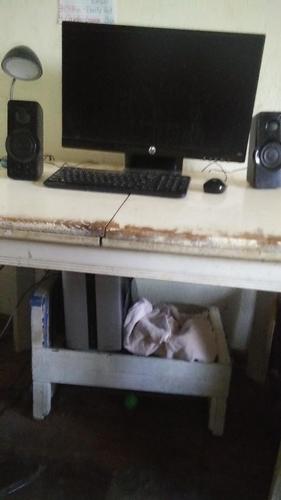

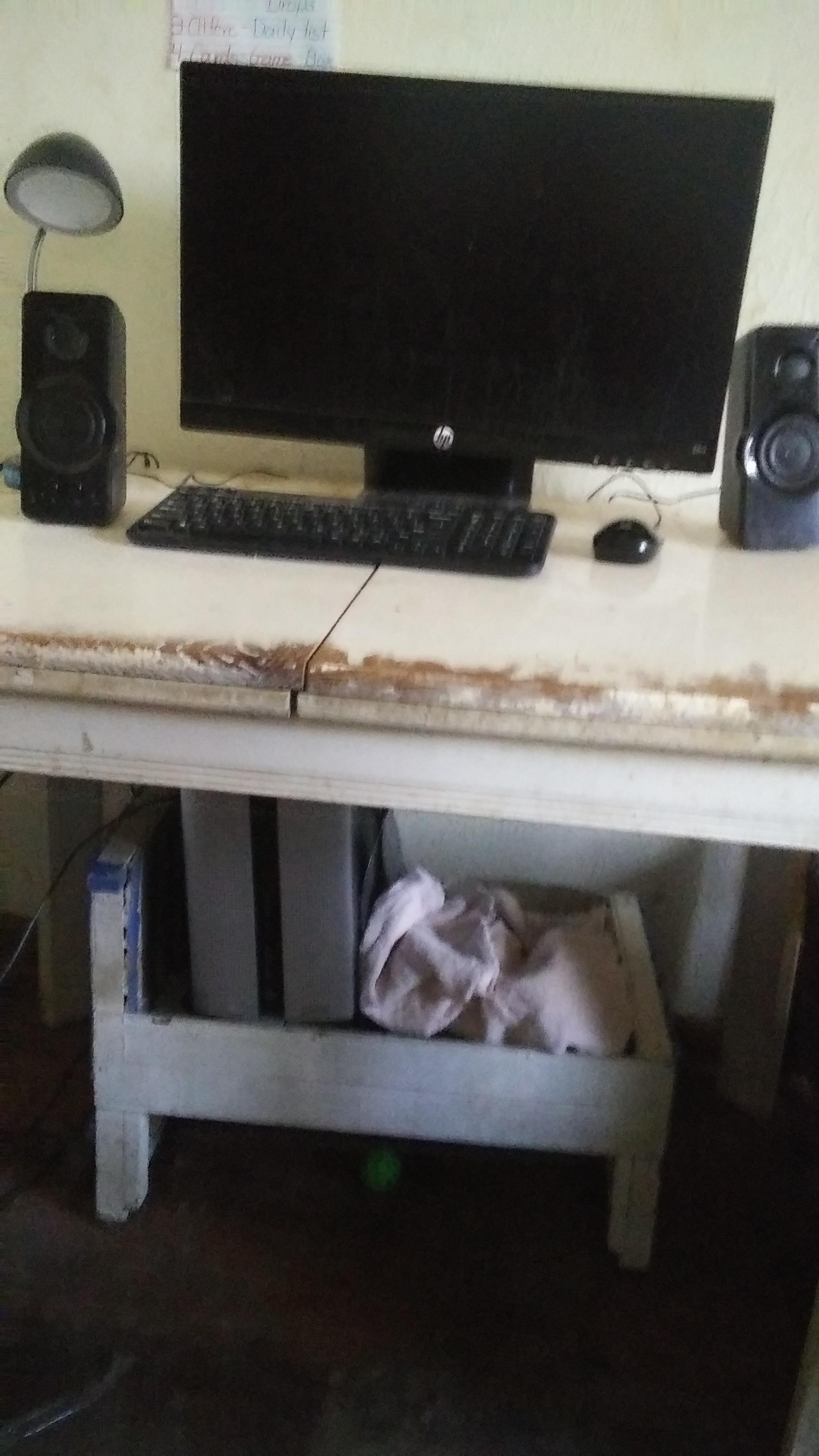

Here are pictures of my setup. I had the computer on a roller, but that wasn't high enough off the ground. My old dollbed came in handy. I took the wheels off the roller and set it all in the dollbed.
Darn. Both of my pics are too big. Let me get pets and people taken care of and fed, and I'll take more.
Here we go :).
It's a regular setup, nothing drastic about it.
Except a couple of my computers have died because of too much heat, the techs said. One worked fine at the shop after it died here one night. Never worked here again. And so on .....

That looks like a basement or garage workbench.
If you have enough room to the left or right on the "table" that would be a better place for the computer.
If you don't mind, it would help to know approximately where in the world you live, since Death By Heat is usually associated with places like Egypt etc. And your rough location would also give me an idea of what type of stores are available to you.
As a minor note, I have built all sorts of work surfaces over the years. Your work surface will be more pleasant if you painted it with cheap paint, or even glued photos or dyed flowers or whatever art would be fun and then the secret ingredient is to cover whatever you make with a high quality "Clearcoat" Polyurethane for which they have "single coat coverage" these days...

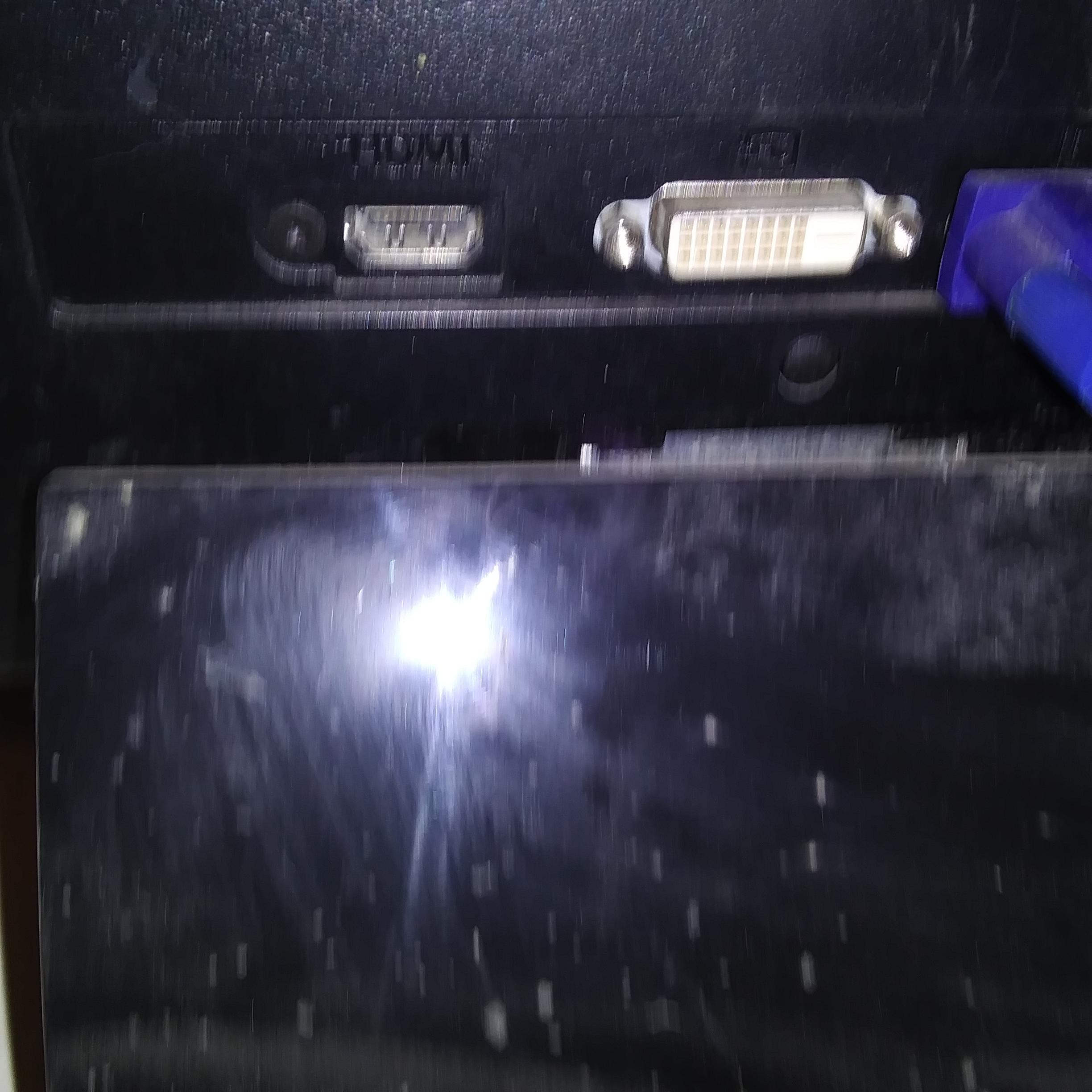

Computer is an HP Pavilion 550-153wb. Monitor is a 23" full HD IPS LED Monitor. The back of the monitor doesn't have any stickers, but has HDMI and VGA and another other connector space. Sorry for the dust.
Windows 10 home for the OS. 4th gen Intel core i3-4170 processor. 6GB DDR system memory. 1 TB hard drive. Integrated Bluetooth 4.0 and Wireless Lan. Intel HD graphics 4400, systems memory is used for graphics/video. (Ok, so I was lazy and did not go dig the box out to doublecheck before I first posted either.)  HP 7-in-one micro card reader.
That's the basics from the box. I switched to a wireless keyboard and bought new $20 speakers.

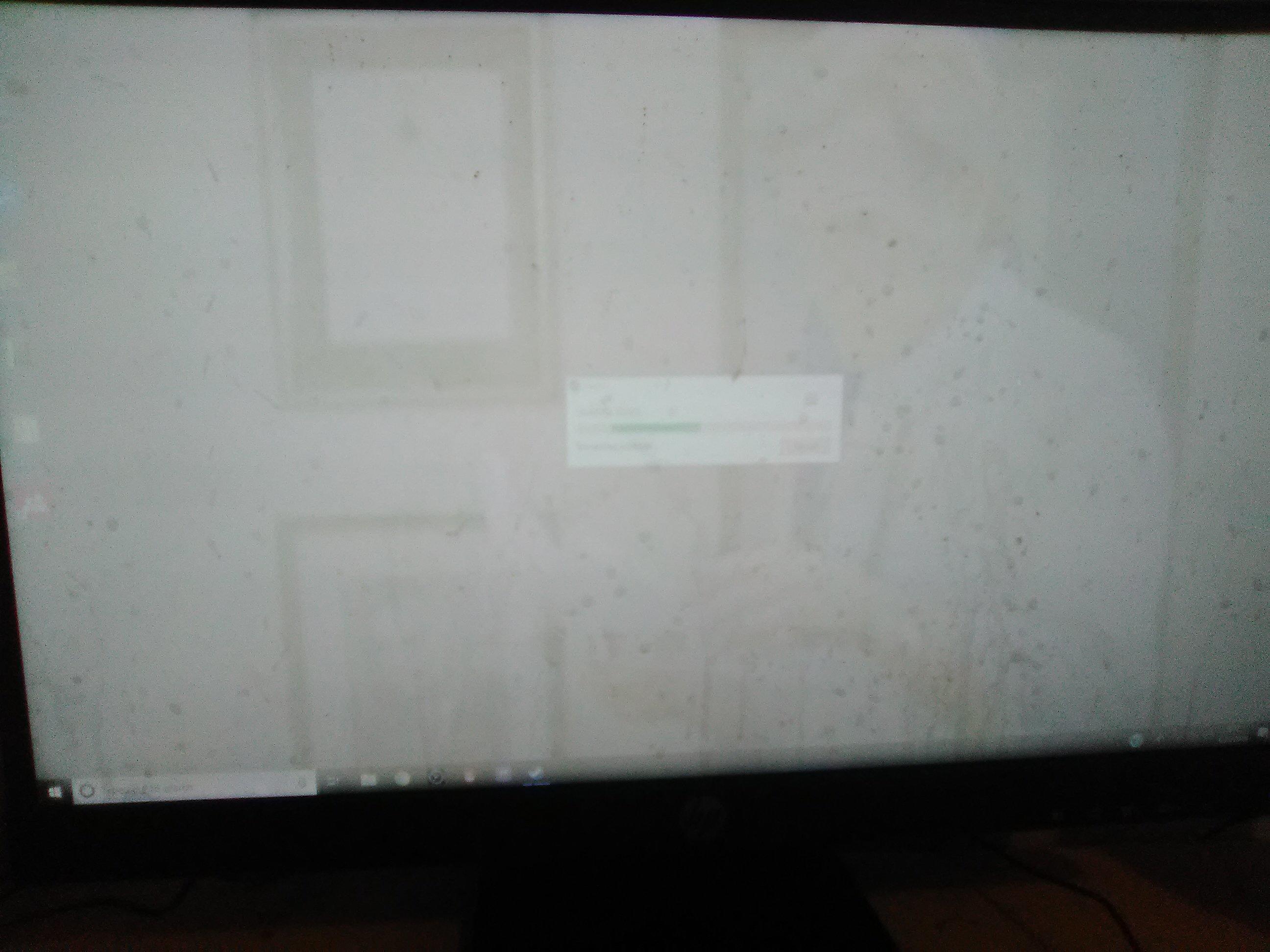

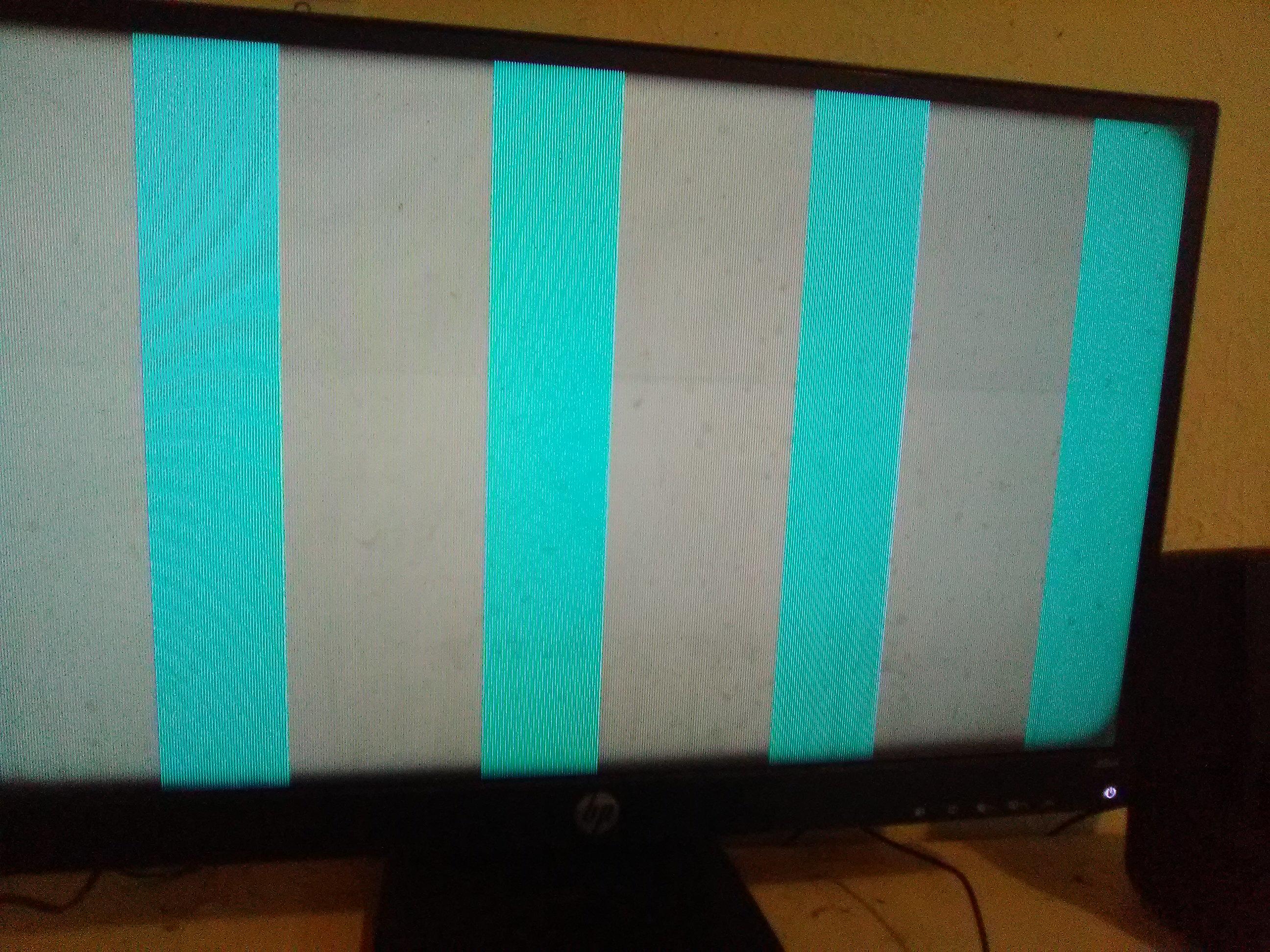

1. Monitor
- repair or replace
- I have started with a suggestion for low cost, we will see what you think of it and what your budget is
