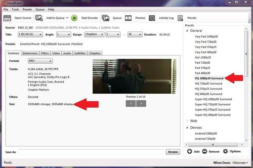

So i've damn near filled my 6TB hard drive and i've still plenty more to do ... that means some videos are going to need compressing (all these files are blu-ray MakeMKV rips).
My computer isn't the fastest at doing this which isn't a major issue because i can just set it up to do the job through the night.
To help advise as best as you can you'll probably need to know what i want to achieve and what i'm going to do with the file. If i miss anything out then just ask...
MY GOAL:
* I want to compress the file down from the original 20GB-40GB that it is. Not to a specific size but smaller without any noticeable loss in image & sound quality.
* I want subtitles to remain in the video file - finally figured out how to do this after some trial & error
* AUDIO - the audio currently comes through my TV speakers. It may well forever stay like that, i don't know. I've been looking in to soundbars for a while now and i hope to get one (but have other issues there - off topic) but it's no certainty. I may well move house in the future and have a 5.1 or a 7.1 setup. The latter two (5.1 & 7.1) are very unlikely but not impossible. The soundbar option is the one that there's actually a good chance of ........ my point is .......... i want to future proof the compressed file so that if i ever do get a soundbar (or indeed 5.1/7.1 setup) I can relax in the knowledge that my movie files can make the most of it rather than being like - damn i wish i'd converted those 300 video files that took me months a little differently.
Problem is ... i don't really understand the audio settings on the audio tab in Handbrake.
* The video files are stored on a specific hard drive on my PC and they are played on my TV in my living room via Plex.
So 3 key things really...
* Image quality - but i think my settings are suitable for my goal? So i'm not particularly worried here. Would just like someone to check.
* Audio quality & future proofing - i honestly don't have a clue.
* Image dimensions (we'll get on to that in a sec)
SUMMARY:
Fairly confident i'm right here. I've selected HQ on the right as a best of both worlds kind of thing - good quality without taking forever and creating a bigger file.
I note the size says 1920x800. More on that on the next screenshot.

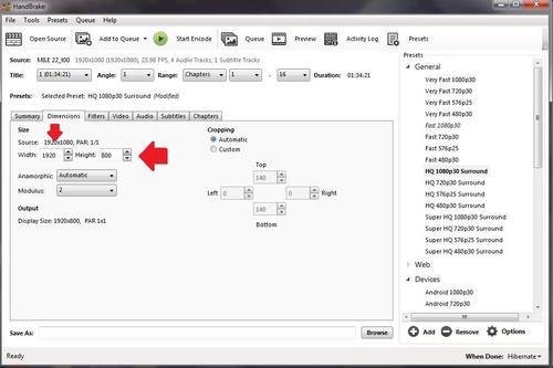

DIMENSIONS:
I see the source as 1920x1080 yet the entered numbers by default are less. What is correct here? 1920x1080 or 1920x800?
In this example i actually changed the 800 to 1080 simply based on the reasoning i've heard of 1920x1080 but not 1920x800, that's all.

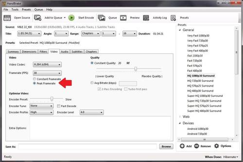

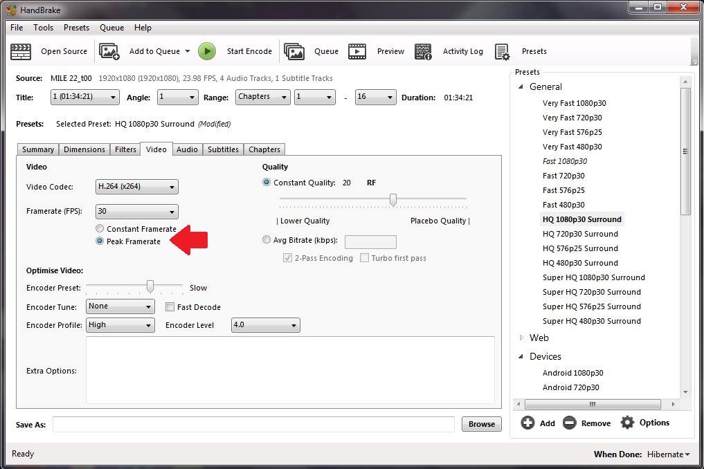

VIDEO:
Now i actually left this as default when i converted my file in this example, however where the red arrow is, i've since read that i should change from Peak Framerate to Constant Framerate.
Correct? Or leave as Peak?

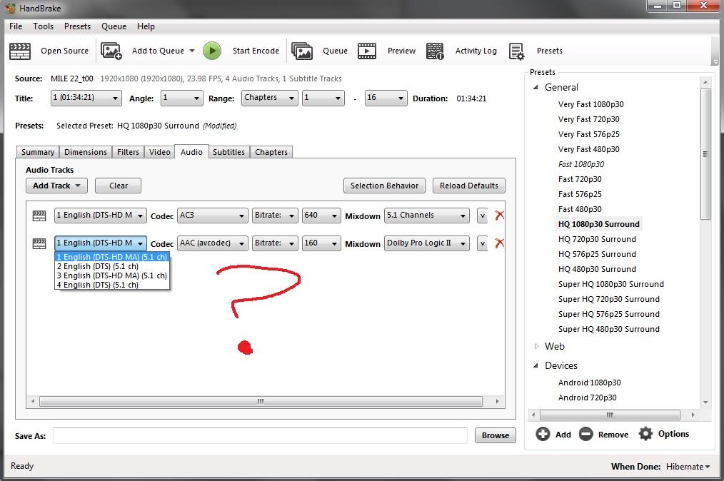

AUDIO:
Here's the problem where i've no clue. I don't really know what to select to achieve my goals. I don't know what codec, what bitrate, what mixdown.
I did a little reading but still don't really understand it. Based on this i changed the mixdown for one of the defaults to 5.1 channels.
Most my movies are English but some are in foreign language (Chinese martial arts movies). So not really sure what to select. I used this as an example since most are total English.
The reason there'll be so many options in that dropdown is because when ripping from MakeMKV i don't know which audio/subs to select as there's often many 'English' options. Based on this i just select them ALL. As a result as you'll know - i sometimes end up with that pointless audio of like the director talking over the movie.

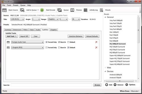

SUBTITLES:
Confident i've got this down now...
So with those options i just mentioned to you (such as changing the image dimensions & not really understanding it) i ended up with this...

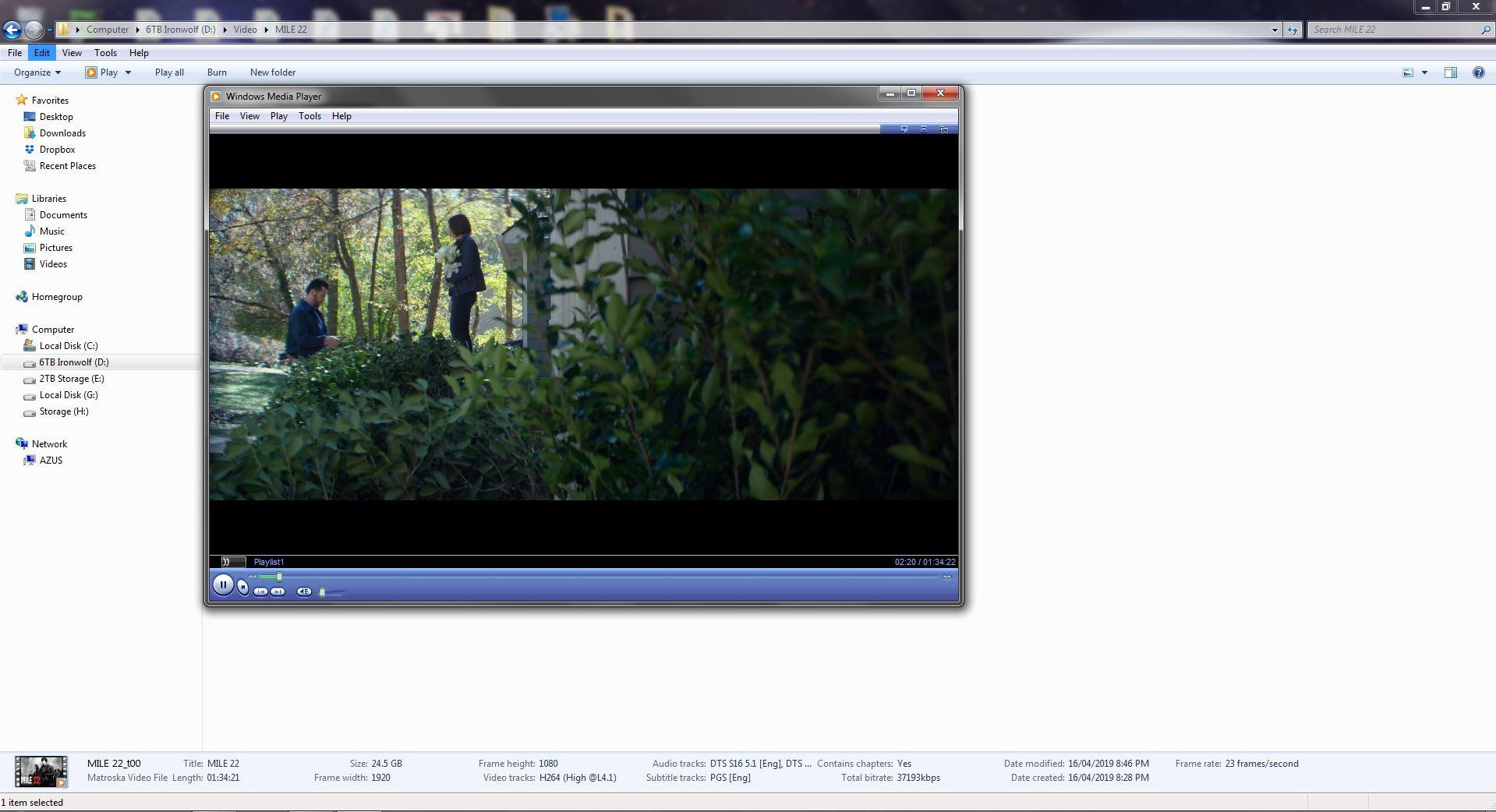

ORIGINAL MAKEMKV RIP:

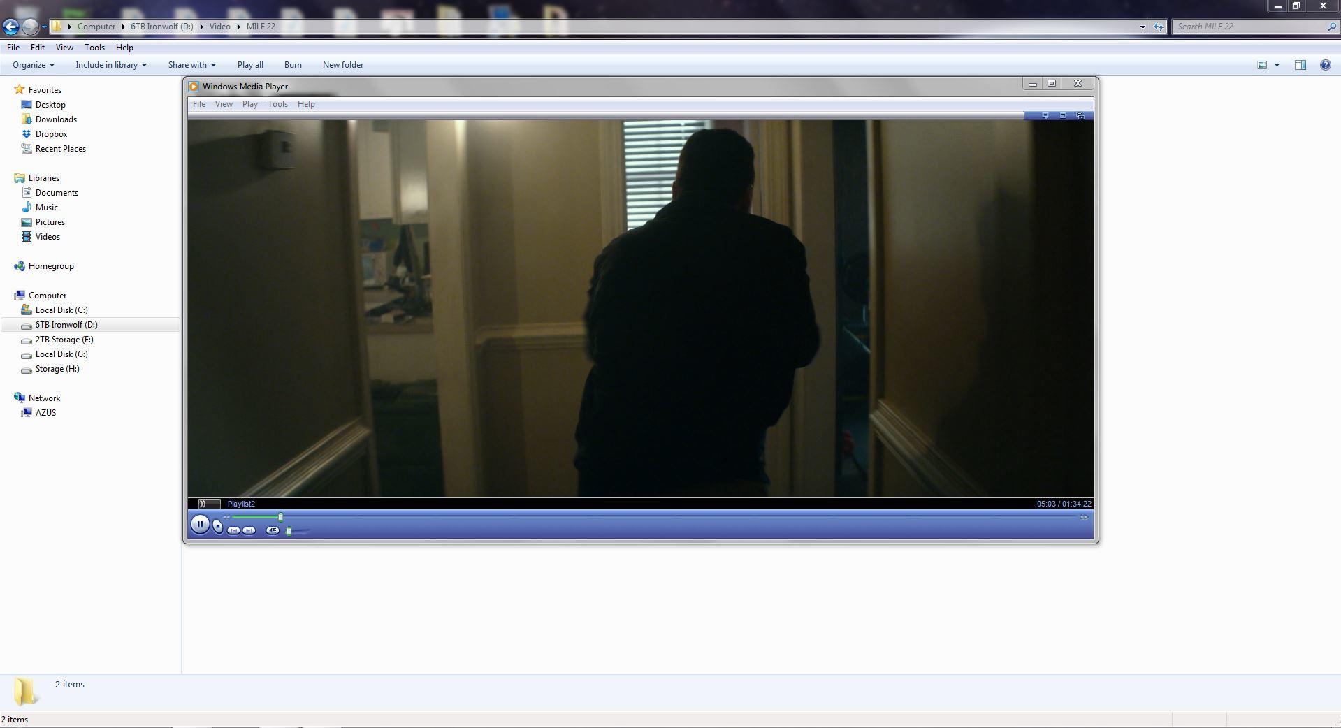

CONVERTED HANDBRAKE FILE with altered 1920x1080 (instead of the default 1920x800):
As you can see, it is a wider file than the original. Leave as 1920x800?

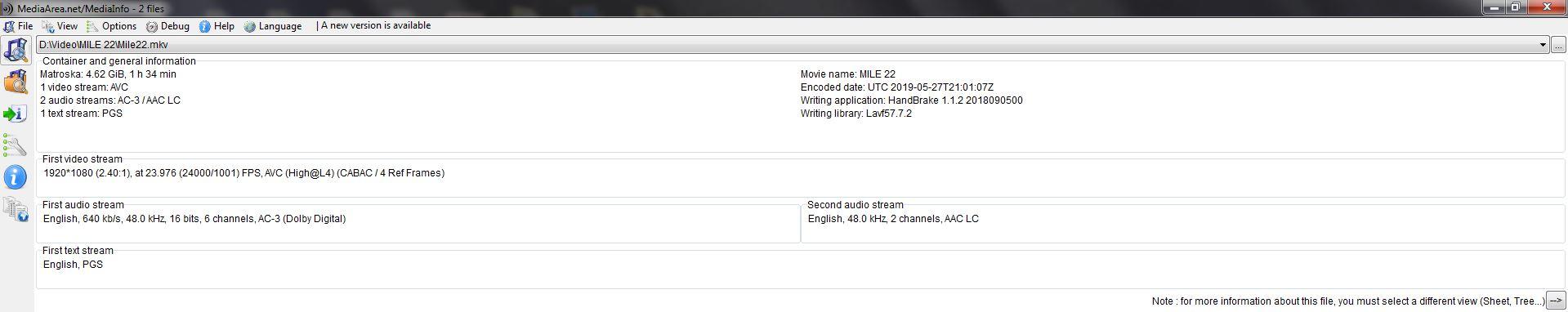

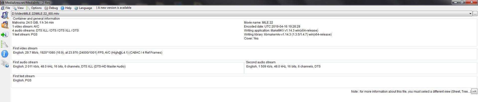

I also noticed though that the audio files are different:
CONVERTED HANDBRAKE FILE:

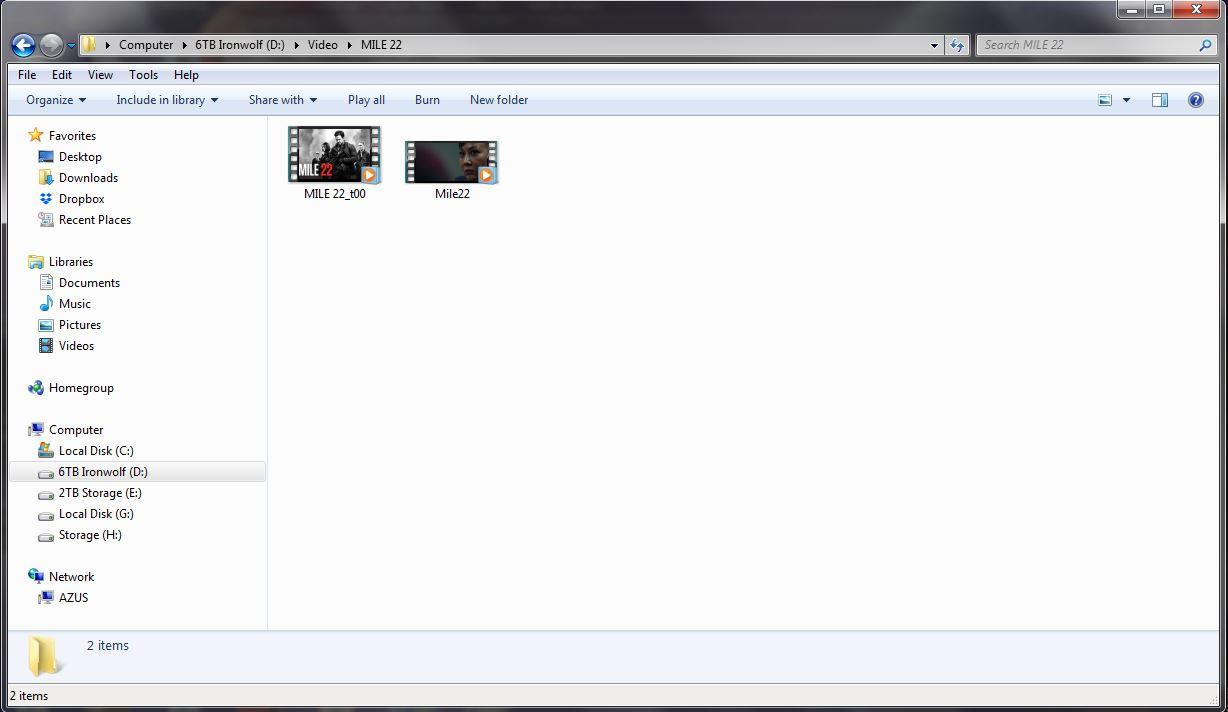

Oh and a final one before i finish. Nothing major but while i'm asking the others i just wondered about this one - on my PC many of the video files have like 'poster thumbnails' for the movie, yet the converted by Handbrake files do not.
Is there a way of changing this so that the converted files have the same thumbnail? If so, how? Like i said, nothing major, just me being picky.

3 hours ago, spacelordmaster said:
Leave the settings the way they are at default. They work just fine like that and the quality output is great and small files compared to the original.
But don't the default settings not include a 5.1 setup? So if i ever ended up having a 5.1 setup i wouldn't be able to make the most of it? Or have i got the wrong end of the stick there?
Like i said, 5.1 & 7.1 are actually unlikely even if they still are possibilities. What IS likely however is a soundbar of some description. I don't understand audio enough (for enough, read: AT ALL) to know whether default settings will be able to make the most of a soundbar or whether the sound quality will actually be quite poor (compared to if i had selected other options within Handbrake when compressing).

I usually do two audio tracks. One for stereo and the other 5.1 Master Audio AAC with highest bitrate. On your playback device, you can choose the audio source. Don't rip for what you have right now, or rip what you think you may have later. Rip for best case scenario so you don't have to re-rip.
What codecs do you use for each?
And which mixdowns for those codecs?
I see in the list there's AAC (avodec) and AC3 but then there's AAC passthru and AC3 passthru. I read yesterday that i should apprently be using this passthru for top quality. Don't know how accurate that is, so instead of AAC (avodec) should i then use AAC passthru?
There are cropping controls on that same tab. By default, it has auto-cropped the black bars from the video (140 pixels removed from top and bottom). That's a good thing, and is why the height is 280 pixels less than expected.

I use Passthrough because I want the best possible audio. The difference in size isn't HUGE, but it is noticeable. If you HAVE to use it, use AAC. If you do pass through, the audio track(s) will be pure, and if your receiver/soundbar has the codecs, it will process the audio, sounding even better.
So i should select passthru every time then?I know you said there's a little difference in file size but tbh it'll be less than the original so it's no big deal.
Would you select AAC and AC3 or just AAC?

1 hour ago, Technique said:
In the past i've always played this game of tennis with you
But since you actually have chosen ;) not to help in this thread by answering my question, i honestly can't be bothered getting in to it with you. Suffice to say your post, that one at least, is exactly that ... BS ;)
AAC. it's a lossy codec. It will provide better sound quality.
I normal do passthrough for movies where I care about the audio.  RomCom's or movies that I may only watch when I'm incredibly bored or whatever ... I'll do AC3 @ whatever bitrate (like 384).
Passthrough will increase your file size substantially though.
Hmm that surprises me. I spent the start of the week looking at AAC or AC3 and my understanding was that if you had to pick one then pick AC3?
What do you mean by 'substantially'?
I converted a movie that had passthru and again when it didn't and it was 3.41GB vs 4.62GB. I might've made other changes also (i think one may have been 1920x1080 whereas the other i let be the default Handbrake setting of 1980x800) - so it wasn't a total fair comparison of passthru vs non-passthru but still only 1.2GB difference.
To me that's not really a lot. Sure it adds up, i agree that much. Do it 3-4 times and that's another movie you could've had taking up the space. I also understand that some people want to shrink their movie to a specific size. Me - i don't really care. I just want it less than the original but not where i'm losing any noticeable audio or video quality. It appears that means i can shrink approx a 30GB file to approx 5GB, roughly speaking, which i'm fine with.

If you're not particularly bothered about getting the file size as low as you possibly can, and since the debate seems to not be crystal clear (regards AAC & AC3, similar to Apple vs Android, Mac vs PC, PS4 vs Xbox etc) would you not just include both AAC and AC3 on the compressed file 'to cover all bases' then? Since it wont mean jumping from 4GB to 20GB, it wont matter a great deal if they're both included?
Just posting back as i forgot to mention earlier. This one is perhaps more at Budman than others but just to put it out there - another reason i was looking at compressing, aside from creating space, was the bitrate.
Some video files i had trouble playing back on the TV with Plex. Most are fine but some have issues and the very small few are unwatchable. These are around 40000 bitrate as i mentioned earlier. Compressing reduces that bitrate massively.
Taking the 1 movie i've done so far, it took the original 37193 bitrate and turned that in to 5175.
Now i don't know if it's the bitrate or some other factor that's causing these particular movies to buffer a lot where other movies play without any issue. >IF< it's the bitrate then this should surely help?
