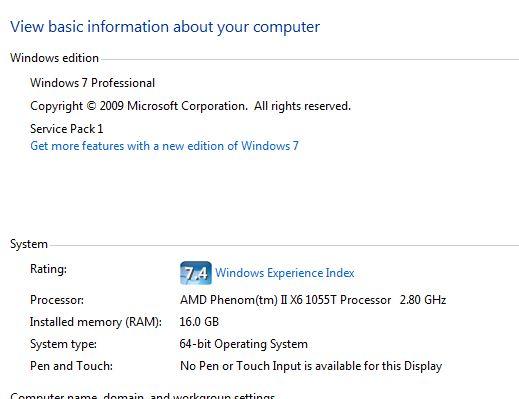

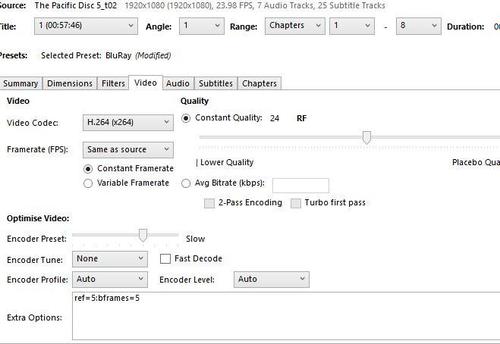

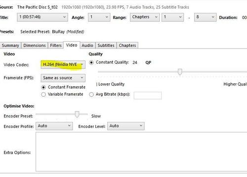

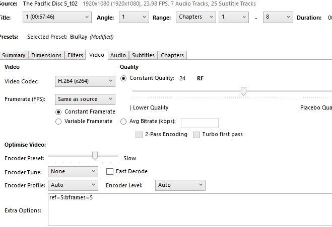

What are you running now?  You may have mentioned it (but I can't find it).
Can you use h.264 (Nvidia NVEnq) or h.264 (Intel QSV)?
I'm using a 3770k and GTX 980ti
I've historically encoded with just the h.264 (x264) video codec but I've started to play around with the h.264 (Nvidia NVEnq) ... and the results look promising.  I could never get Handbrake to encode with QuickSync ... so whatever.
With h.264 (x264) encoding speed was between 15-30 fps....so it was taking about 2-3 hours per movie.  With h.264 (Nvidia NVEnq), in my way to early testing, I'm encoding on average about 180fps.  In other words, I encoded a 57 minute episode of The Pacific (my test file) in 8 minutes.  It took 1 hour and 15 minutes with h.264 (x264).
The NVEnq rip was a little bigger for comparable settings (about a gig or so).  Hard to discern the difference (if any) in video quality.  Though this comes with a caveat since I haven't watched a full NVEnq rip on my HTPC/TV (just my desktop) so there could be something I'm missing.
  • 0
If you need info beyond that then just ask.
Oh, graphics card is a Nvidia GeForce GTX 460.
As for your second question, i don't honestly know.
My question is more coming from the angle of what could i get the compression time down to while using the settings that i'm using rather than the angle of what is the total fastest time i can compress a file in. The most important thing to me with this is compressing without noticeable loss of audio & video quality. If doing it in 8 minutes (i know yours was only an example) has me noticing some loss then it's not for me. If i have to take 4 hours then fair enough i take 4 hours. Like i say, the main thing is no noticeable loss. I'd just prefer it if it didn't take 4 hours to do but if it does then it's not the end of the world i guess.
  • 0
You seem to be unaware of GPU encoding which I mentioned previously. That is what he is asking you.
Your computer has TWO processors, the Phenom X6 and the NVIDIA GTX 460.
It turns out that GPUs are FAR FASTER at encoding video than a CPU. In your case, you should se a huge difference despite both components being from the dark ages...
If you just want to boost encoding speed, no need for a new computer, just a new video card.

From a few post back you seem to be taking a BluRay of 30 to 60 gigs original size and compressing to 30 gigs at 1920 x 1080
You don't want to see a drop in quality but you are not really bringing anything to the table to achieve that.
BluRay standard already uses H.264 to compress the original video so when you decode H.264 and re-encode in H.264 you are doing a transcode which guarantees artifacts at almost any bitrate. You are forced to do a transcode because original un-encoded video is stored in Hollywood movie vaults.
The ONLY way to focus on quality in this process is to use a better encoder than the original. For practical reasons that would be only the modern H.265 codec which would actually permit you to reduce your size quite a bit. Being a more sophisticated encoder, the encode times could go up quite a bit. Worth a test, particularly if NVIDIA has a GPU H.265 encoder. @Jim Kis that available?

Depends on the card...for example he is SOL with the GTX 460  which doesn't support NVEnc.  Pretty much everything from a 1050 and higher supports hardware encoding at h.264 and h.265.
Good ol' matrix here...
https://developer.nvidia.com/video-encode-decode-gpu-support-matrix
Hmm not sure i'm with you on that.
First off i think the largest blu ray i've done has been like 30something. 30-35 perhaps. Most are in the 20-30 region, hence why i said 20-30 and not 30-60. Never seen a 50+GB blu ray before.
Just checked one i suspected would be one of the highest i've done - Avatar. Even that is 39.7GB. I've checked others and they barely scrape 30GB.

Yea, it should.  When you have hardware that supports NVEnc you can enable it under Tools > Preferences.
So...right now your Handbrake looks something like ...
...when you enable NVEnc you can change your video codec to ...
(or H.265 Nvidia NVEnc)
...mind you ... these are the settings I've just been playing with and not necessarily a suggestion for you.
As I mentioned earlier ... I encoded one episode of The Pacific using each of those settings.  With the regular x264 it took about and hour and fifteen minutes.  With the NVEnc it took under 8 minutes though resulted in almost a 1GB larger file.
The 17GB is the original makemkv rip obviously
