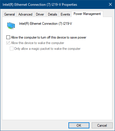

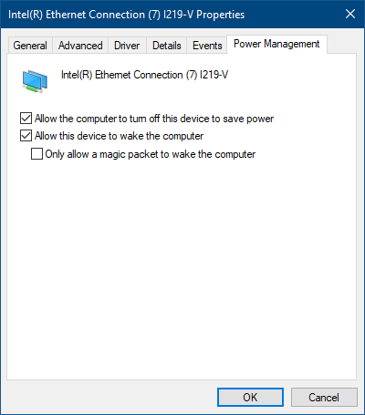

Ethernet can be disabled. I thought I already disabled Wake on LAN.
Run the command again and see if it's truly disabled.
Use this to disable.
powercfg -devicedisablewake "device name"
Replace the device name reported in the first command that you want to disable.

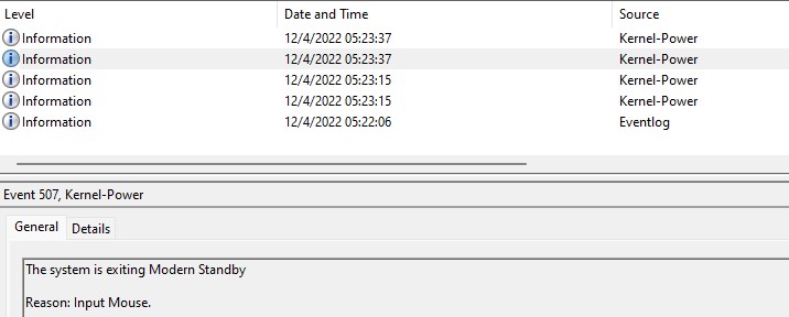

Have you simply looked at Event Viewer --- Windows Logs --- System?
As an example...I set my monitor to "sleep" after 1 minute. After it went to sleep I moved the mouse....
Yeah nothing in event logs about a disconnected USB and the screen waking.
