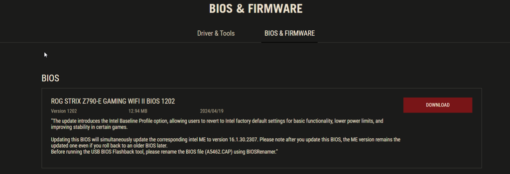

If you're correct with BIOS revision 1202 the current version is 2202 which is around 8 revisions newer, probably worth flashing that before returning anything and doing some further testing. Early BIOS revisions are often unstable and QVLs typically relate to the latest BIOS revision for the motherboard. If it was just a typo and you're already on 2202 feel free to ignore this :)

1202 is the Lastest BIOS Version for my Motherboard which I'm on right now

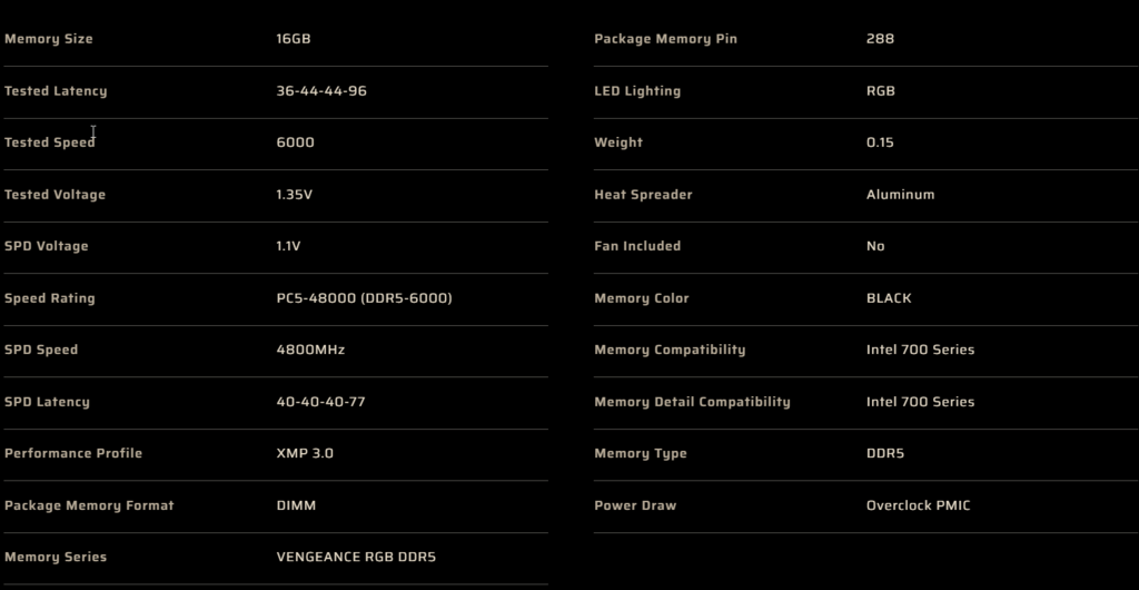

Here are the Specs for my RAM.

Your RAM is rated for 6000 at CL40 at 1.35v. Since it's unstable at these specs, you'll need to go for ~ 1.375 volts. Just make sure to stay under 1.4v.

Looks like Asus just released a new BIOS to throttle back the automatic overclock of 13th/14th gen processors which was causing reported stability problems (1301) I can only think I got linked to the wrong motherboard before!
https://rog.asus.com/motherboards/rog-strix/rog-strix-z790-e-gaming-wifi-ii/helpdesk_bios/
Interesting that your spd speed rating on the DIMMS is Cas 40, I guess that's a different XMP profile or lower voltage. If you're still struggling with stability you could try using the SPD ratings rather than the XMP and back things off a little, you probably won't notice the difference as the clock speed makes a lot more difference than the latency.
