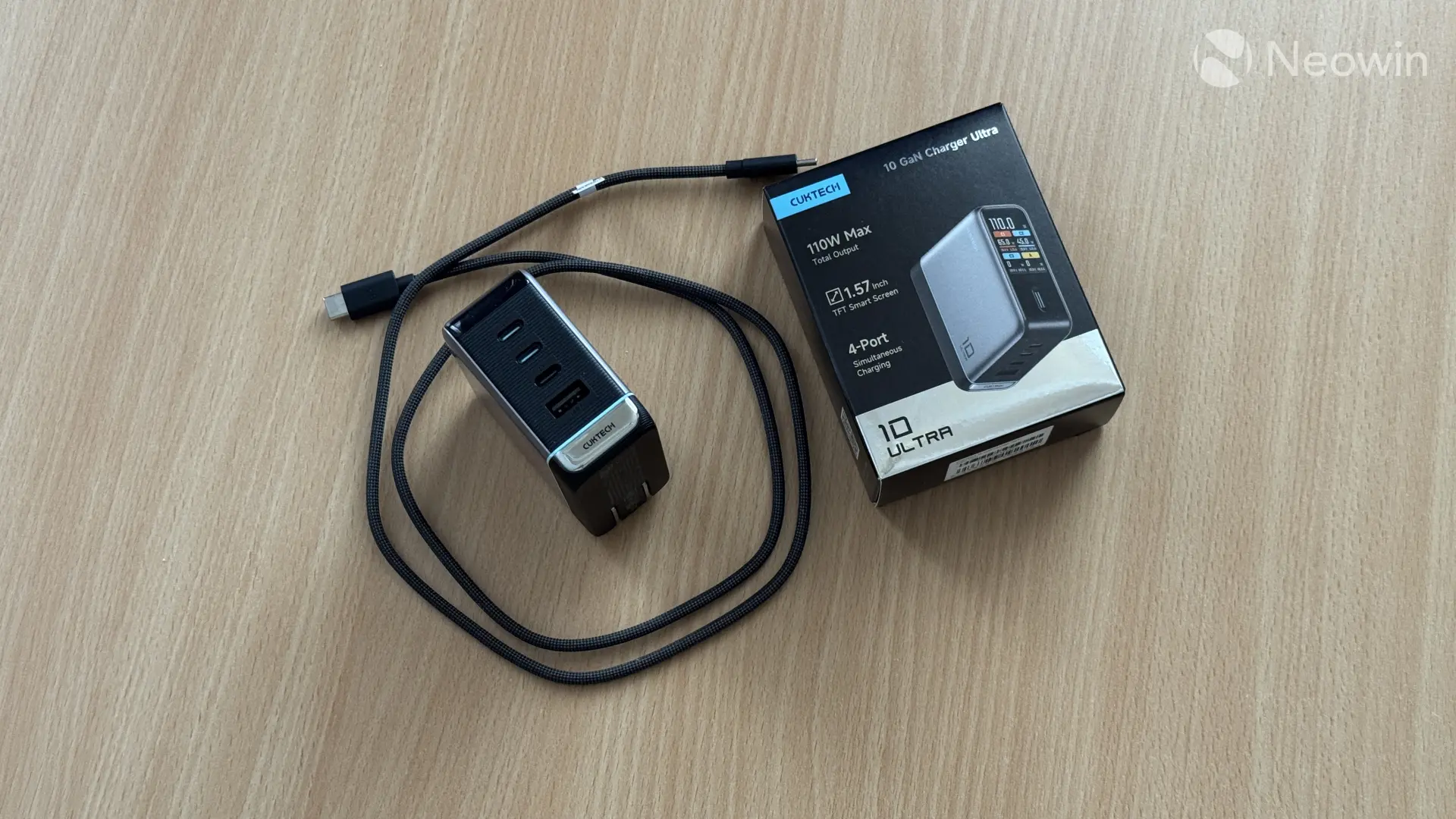

Like the 30 Ultra, the 10 Ultra arrived in a box made of nice cardboard with quality print all over it. Inside, besides the charger, you will find a 240W 6A charger, which, this time, is fully braided. While Cuktech always bundles high-power cables with its chargers and power banks, they are usually regular and unassuming. This time, the cable is much nicer, matching the charger's $59.99 price tag.

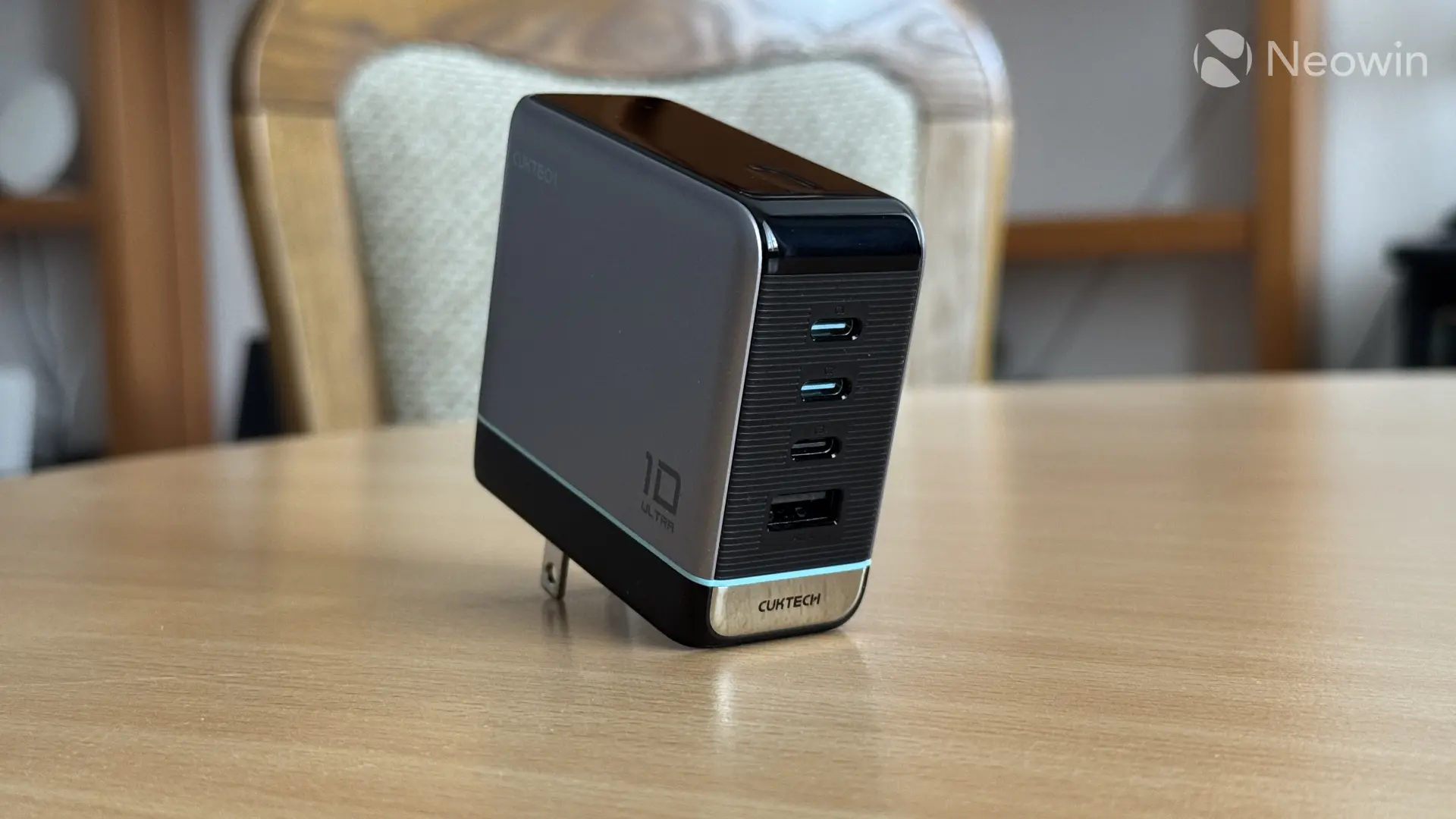

The charger itself measures 67 x 76 x 33 mm or 2.6 x 3.0 x 1.3 inches and weighs about 250 grams. Considering the charger has four ports and a big display, I would say the compact size is quite impressive, albeit a little hefty. The overall design is similar to other chargers from the manufacturer, minus the chrome Cuktech logo next to the four ports.
The Cuktech 10 Ultra has retractable prongs for better portability. Its front side is covered with piano black plastic housing two elements: a capacitive button with backlight and a quite large display for various charging stats. Ports are downward-facing, and I have mixed feelings about such a design. It is not the most convenient when you frequently connect and disconnect cables. It makes you bend over to find the right port to connect, and it is a no-go with outlets mounted closer to the floor. On the bright side, design like this eliminates clutter and sagging, especially when using four cables at once. Plus, you get plenty of space for a big display.

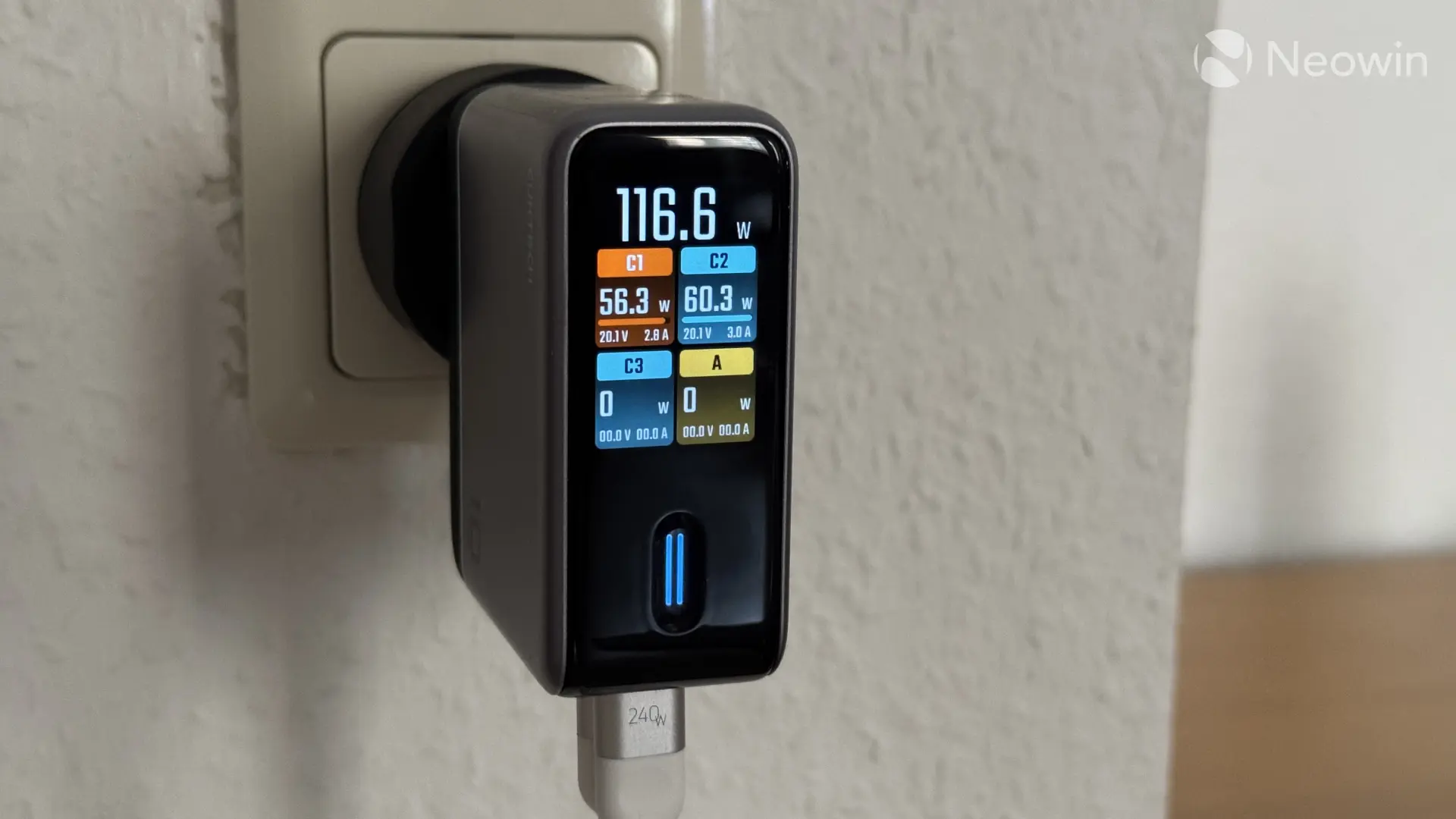

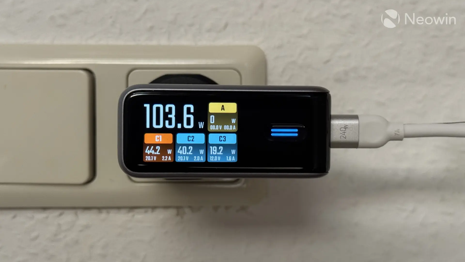

Ports include two high-speed USB Type-C ports, one Type-C for less demanding devices, and one classic USB Type-A. The first two ports deliver full 100W, while the third is capped at 45W. As for the Type-A port, its maximum output is 18W. In total, the charger delivers 110W of power, but in my testing, I managed to squeeze 117W when charging two power banks and a tablet. Quite impressive.
| Type-C1 | Type-C2 | Type-C3 | Type-A | |
| Single-port | 100W | 100W | 45W | 18W |
| Two ports | 80W | 20W | - | - |
| Three ports | 65W | 20W | 20W | - |
| Four ports | 65W | 20W | 10W | 10W |
The charger can detect handshake protocols and balance power across all four ports according to each device's needs. As such, power is not limited to the values in the table above. You can have two ports charging at 55W, three ports at 45W + 20W, and more. For some reason, Cuktech is not listing the supported protocols, but a quick test showed that it is compatible with PD3.0, PPS, QC5, DCP, and UFCS. When you connect a compatible device, the charger automatically detects its charging standard and displays it on the screen, for example, Apple 6A or Samsung 3A.

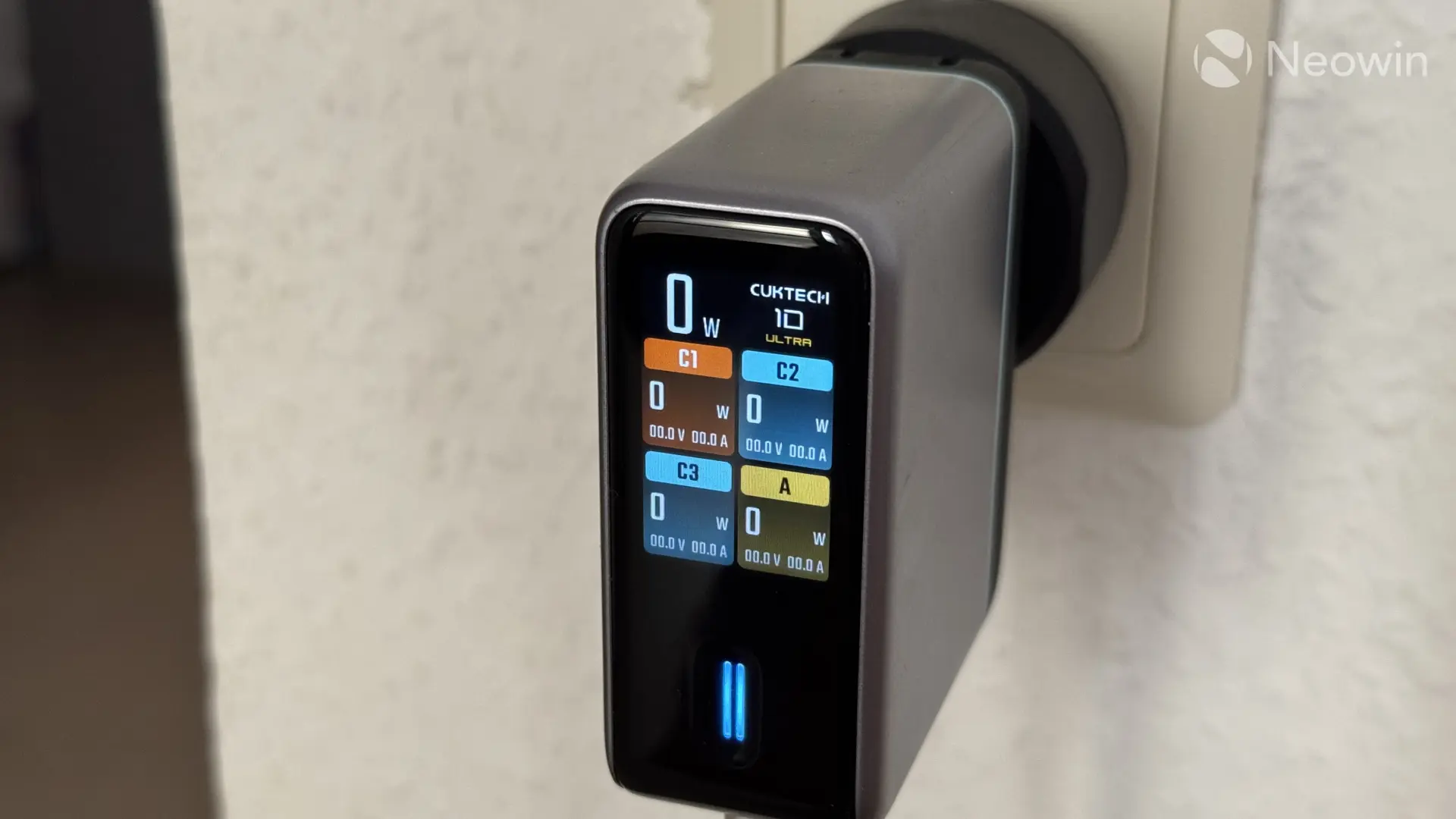

Speaking of the screen. The main highlight of the 10 Ultra is its 1.57-inch display with a maximum brightness of 700 nits and 160-degree viewing angles. The display takes up most of the front, and it shows various charging-related information, including total output power, current temperature, power distribution across ports with watts, volts, and amps, a screensaver, and more. You can toggle between the different views by tapping the button, and holding it changes the screen orientation (portrait or horizontal, plus flipped) according to your socket position.
The screen is very nice. It is sharp, vivid, and the fonts are easy to read. As for settings, you can change the following:

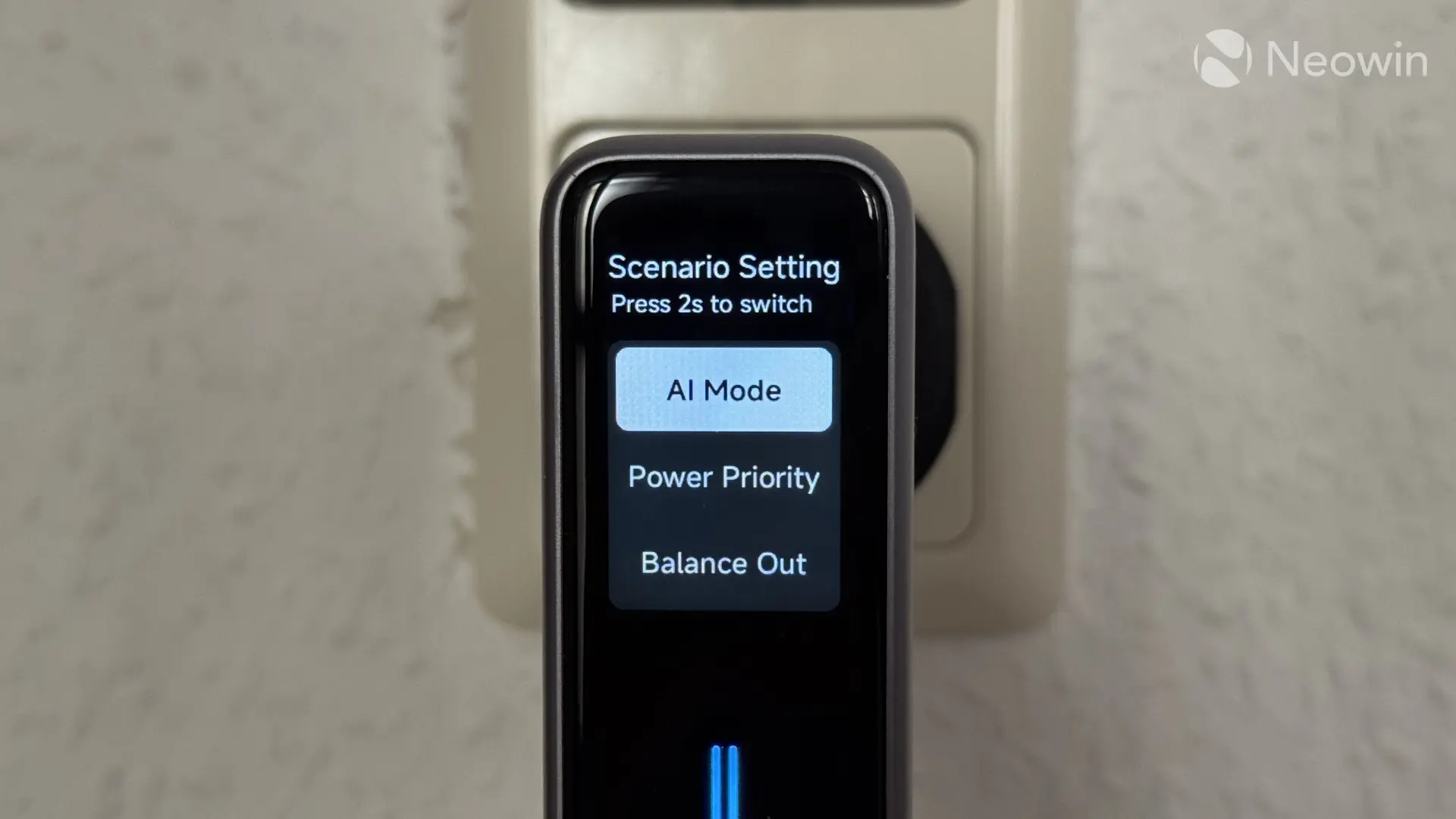

The charger has three power modes:
- AI: standard mode that automatically allocates power to each connected device.
- Power Priority: prioritizes power for high-demand devices, such as laptops or power banks.
- Balanced: splits power evenly across connected devices according to their needs
I was skeptical at first, but after testing a few devices in different modes, I can see the benefit of these three modes. The most useful is power priority, which gives the first Type-C port more power. When I was charging a 100W power bank (port 1) alongside a 140W power bank (port 2), Power Priority split the total output about 75-30. Balanced mode, as the name suggests, splits the total output between the two ports more or less equally. As for AI mode, the charger uses its brain to detect which device needs more power. In my testing, it figured out that the 140W power needs a bit more juice.
As I said, I expected this to be more of a gimmick, but the three built-in modes turned out quite useful. For example, you can prioritize your laptop while giving other ports a little less power, but still enough to charge at acceptable speeds. Unfortunately, unlike the 30 Ultra, this charger cannot display the battery level of the device being charged. This small feature turned out to be very useful when I was testing the 30 Ultra, as it allowed me to see my phone's battery level without picking it up.

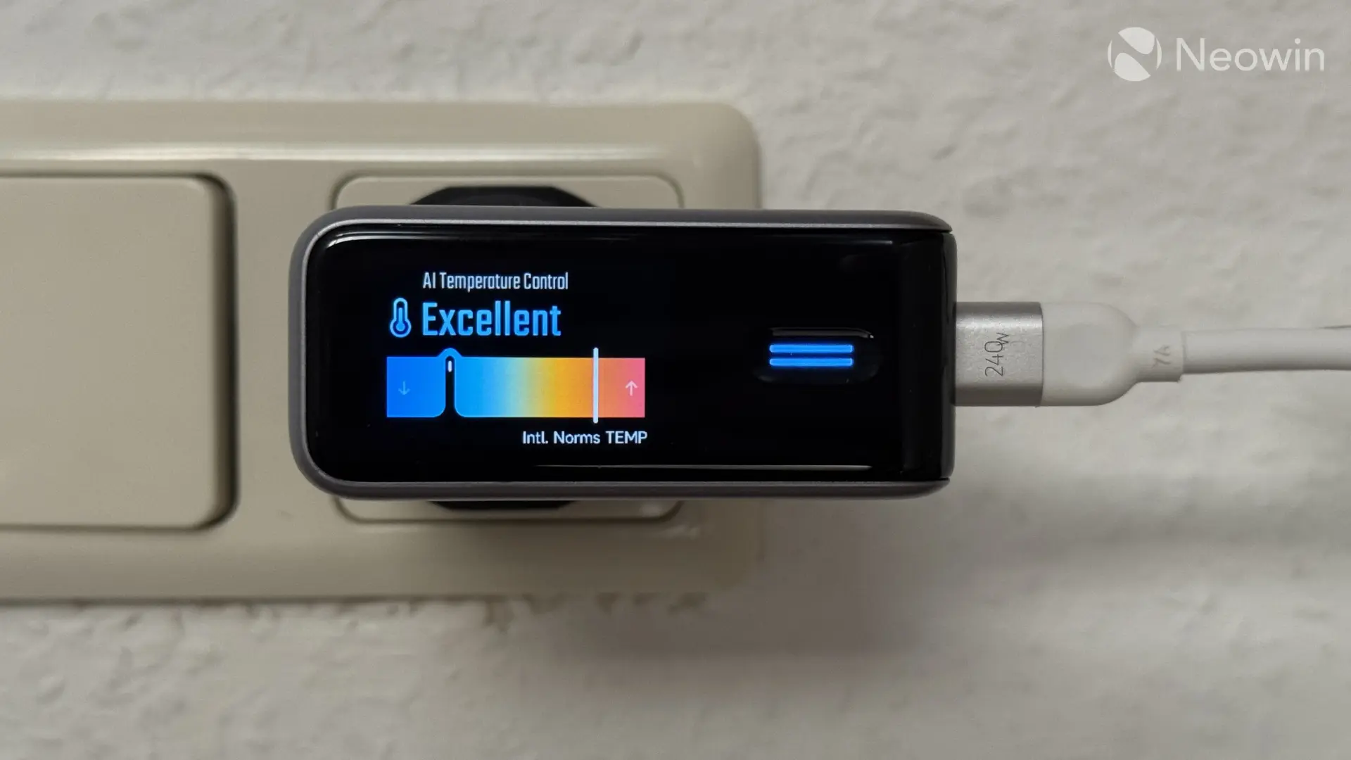

Like other Cuktech chargers I tested, the 10 Ultra one proved itself reliable and well-made. It uses Gallium nitride semiconductor technology to reduce the charger's size and improve efficiency. It is also better at dissipating heat, but I have to say that when charging two power banks at 117W total, the charger got hotter than what I would call comfortable (hold it for a few seconds, and you start feeling a burning sensation at your fingertips). However, the built-in thermal indicator remained below the temperature threshold, with the screen reassuring that the device operated at "High performance" (I tested it in a 21 °C / 69 °F room).
