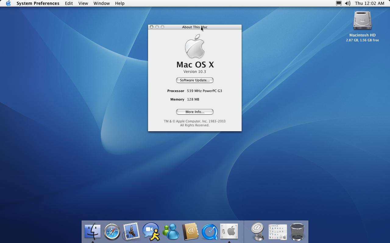

Ok so i started using the new clock version and my cpu registers at 533 mhz :yes: . From what ive heard about the power pc processor the speed is double to equal what u would have on and intel chip right? SO technicaly im running a 1066 mhz machine.
osx is still a little sluggish.
My network has a green light but fails to connect to the internet. Dont know if it is this version or if it is the new firmware update to the linksys routers.
Oh well Atleast i still have a green light
