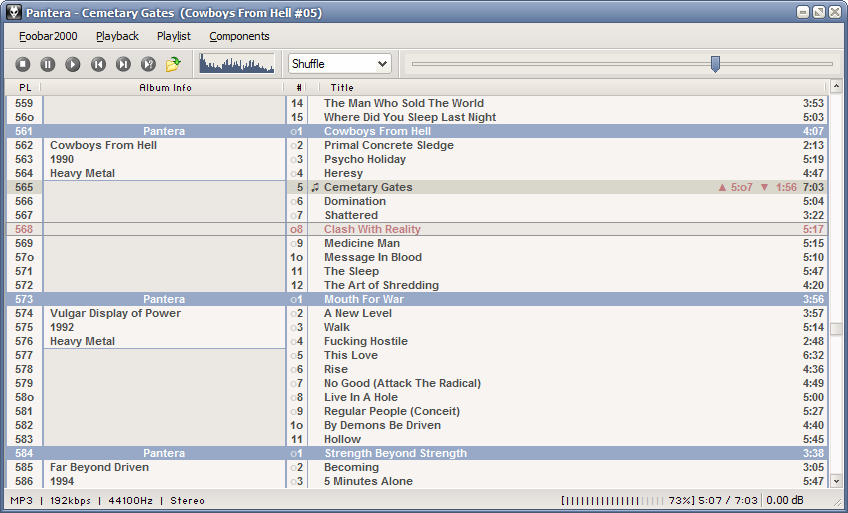

No problem!
Visual Style (Azrael 4.8.8 by Neksus)
Download
*Requires columns_ui
Buttons (Metal & Glass by myxamatosis)
Metal Pack
Download
Glass Pack
Download
Formatting
System Tray

Status Bar
// set colors
$puts(col_paused,0000FF)
$puts(col_streaming,008800)
$puts(col_cue_file,880000)
$puts(col_progbar_symb1,CCCCCC)
$puts(col_progbar_symb2,666666)
$puts(col_time_remaining,000000)
// set variables
$puts(text_streaming,'Streaming')
$puts(text_listened_for,'Listened for:')
$puts(text_cue_file,'Cue File')
$puts(text_paused,'Paused')
$puts(text_time_remaining,[%_time_remaining%])
$puts(spacer_symb,' ')
$puts(spacer_width,2)
$puts(progbar_symb1,'▪')
$puts(progbar_symb2,'▪')
$puts(progbar_length,100)
$puts(text_bitrate,$if2($pad(%__bitrate_dynamic%,3)'kbps',$if2(%__bitrate%'kbps',)))
$puts(text_extrainfo,[%__extrainfo%])
// add colors and formatting
$puts(spacer,$repeat($get(spacer_symb),$get(spacer_width)))
$puts(text_streaming,$get(col_streaming)$get(text_streaming))
$puts(text_listened_for,$get(col_streaming)$get(text_listened_for))
$puts(text_cue_file,$get(col_cue_file)$get(text_cue_file))
$puts(text_paused,$get(col_paused)$get(text_paused))
$puts(text_time_remaining,$get(col_time_remaining)$get(text_time_remaining))
$puts(progbar_symb1,$get(col_progbar_symb1)$get(progbar_symb1))
$puts(progbar_symb2,$get(col_progbar_symb2)$get(progbar_symb2))
// streaming
$puts(streaming,
$if(%_time_total%,,
$get(text_streaming)$get(spacer)
// cuefile
$puts(cue_file,
$if(%__cue_audiotype%,
$get(text_cue_file)$get(spacer)
// codec
$if(%__codec%,
$if($stricmp(%__codec%,musepack),$puts(codec,'MPC'),
$if($stricmp(%__codec%,vorbis),$puts(codec,'Ogg'),
$puts(codec,%__codec%)
//If no codec tag and not streaming, read file extention
$if($and(%_time_total%,$not(%__codec%)),
$puts(codec,$upper($ext(%_path%)))
// bitrate
$puts(bitrate,$get(spacer)$get(text_bitrate))
$if(%__mpc_profile%,
$puts(bitrate,$get(spacer)%__mpc_profile%$get(spacer)$get(text_bitrate))
// extrainfo
$puts(extrainfo,$get(spacer)$get(text_extrainfo))
$if(%__mpc_streamversion%,$puts(extrainfo,$get(spacer)'sv'%__mpc_streamversion%))
// samplerate
$puts(samplerate,
$if(%__samplerate%,
$get(spacer)$cut(%__samplerate%,2)'kHz'
// channels
$puts(channels,
$if(%__channels%,
$get(spacer)$ifgreater(%__channels%,2,%__channels%ch,$ifgreater(%__channels%,1,Stereo,Mono))
// mp3 stereo mode
$puts(stereo_mode,
$if2('('$abbr(%__mp3_stereo_mode%)')',)
// Replay Gain
//track gain
$puts(rpg,
$if(%__replaygain_track_gain%,
$get(spacer)
' TGain:'$cut(%__replaygain_track_gain%,5)'dB'
$if(%__replaygain_album_gain%,
$get(spacer)' AGain:'$cut(%__replaygain_album_gain%,5)'dB'
// progress bar
// (checking total because of streaming)
$puts(progress_bar,
$if(%_time_total_seconds%,
$get(spacer)$get(spacer)
$progress2(%_time_elapsed_seconds%,%_time_total_seconds%,$get(progbar_length),$get(progbar_symb1),$get(progbar_symb2))
// progress %
$puts(progress_%,
' ='$pad_right($muldiv(%_time_elapsed_seconds%,100,%_time_total_seconds%),3)'%'
// 'Listened for:'
// (used for streaming)
$puts(listened_for,
$if(%_time_total%,,
$get(spacer)$get(spacer)$get(text_listened_for)
// time
$puts(time,
$get(spacer)
[%_time_elapsed%]
$if(%_time_total%,
'/'%_time_total%
' ['$get(text_time_remaining)']'
// paused
$puts(paused,
$if(%_ispaused%,
$get(text_paused)
// create string
$get(streaming)
$get(cue_file)
$get(codec)
$get(bitrate)
$get(extrainfo)
$get(samplerate)
$get(channels)
$get(stereo_mode)
$get(progress_bar)
$get(progress_%)
$get(spacer)$get(listened_for)
$get(time)
$get(spacer)$get(rpg)
//Right adjust from now on
$char(9)
$get(paused)[/b]
Need something else? :cool:

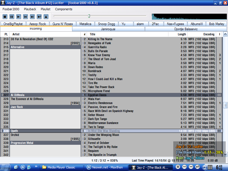

if you want this config:
then download this: columns.zip
then download the above config (delete all text from the 'artist' column) and then get foo_text and litestep and do the following:
