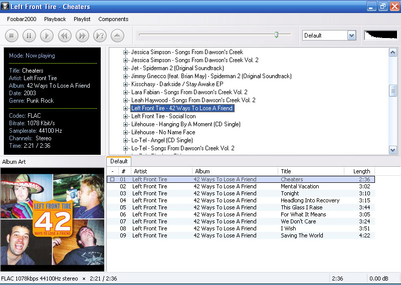

:huh: Wowee you guys are doing some lovely work here. I use winamp at the moment and would love to move to foobar2000 permanently since it is the only player that has actual brains. I would love to make my player look like the pic iv attached. The thing is I have no idea how to do 2 things...
- Display coverart and album list in the way done in the pic
- Get the title, menu and status bars to change from the default colours.
Would it be a lotta trouble to give a simply guide as to how to get a setup similar to the posted pic.

Firstly you need Columns UI (which comes with the installer, so that shouldn't be a big deal). Then you need foo_uie_albumart (for the album art) and foo_uie_tabs (for the tabs). The album list panel comes with Columns UI, but the tabs don't.
585164317[/snapback]
You can't change the title and menu colours, as far as i know. (Unless you're talking about visual styles, but i doubt it...?) With the status bar it's just using regular colour codes like you would anywhere else in foobar. (For example, FFFFFFhello is how you would make it say 'hello' in white.)

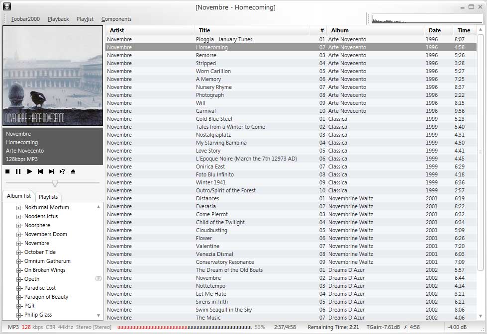

Nice layouts guys. I used to use iTunes, but no longer. Got tired of being forced to do things Apple's way. I love foobar. Now if we can get g-force in a panel, there will be much rejoicing. One music player to rule them all. Here's my config.
http://img159.exs.cx/img159/5117/brumalfoobar9mi.th.jpg
585140960[/snapback]
nice man, I love it, it's elegant. can you share the config please?
Thanks a lot lav. I have got all the addition tabs now and its all looking lovely. I have noticed a few people with very fancy title bars and status bars. I assume these come from some theme used in WindowBlinds or StyleXP as I can't find a way to add images to title, menu or status bars to make them appear different from default. I guess its time for me to meet with Mr Style XP again.
Please correct me if I'm wrong.
Thanks for the help guys. Keep up the gr8 work!
Fots :D

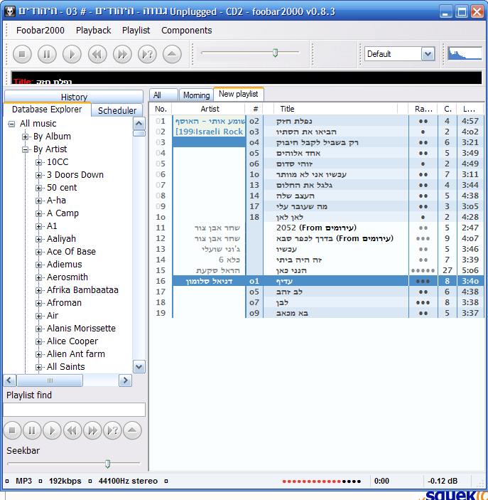

I've just spent about 4 hours going through all 76 pages and I think I finally know most of what there is to know about customizing foobar.. So i though i'd post my screenshot. Still a little work to do although it's definately perfectly useable. Just a note, I hardly use playlists, I always just use one playlist and delete and add from it using the album list so that's why I didn't bother with the playlist tab.
Winamp is official uninstalled, i love foobar2000 :D
How was it done ....
Windows Theme: Windows 2005 MCE Default Theme
Colour Scheme: Erik
Now Playing: Got it from one of the posts and modified it a little.
Buttons: Found on one of the posts. Best buttons I've seen so far.
Thanks to everyone for their awesome work that has allowed me to make my foobar look sexy.
Cheers
Fots
Good job!!  :blink:
2 questions:
How did you get more than 1 tabbed panel stack?
How did you get the toolbars across the top instead of down the side?
585166726[/snapback]
1. As just mentioned, hold <SHIFT> down while adding another stacked panel.
2. Preferences > Columns UI > Other > List all toolbars must be checked. Then right click by the file menu and you'll see a Layout option to add Tabbed panel stack.
